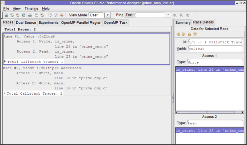

The following screen shot shows the races that were detected in prime_omp.c as displayed by the Thread Analyzer.
Figure 2-1 Data Races Detected in prime_omp.c
Two data races are shown in prime_omp.c:

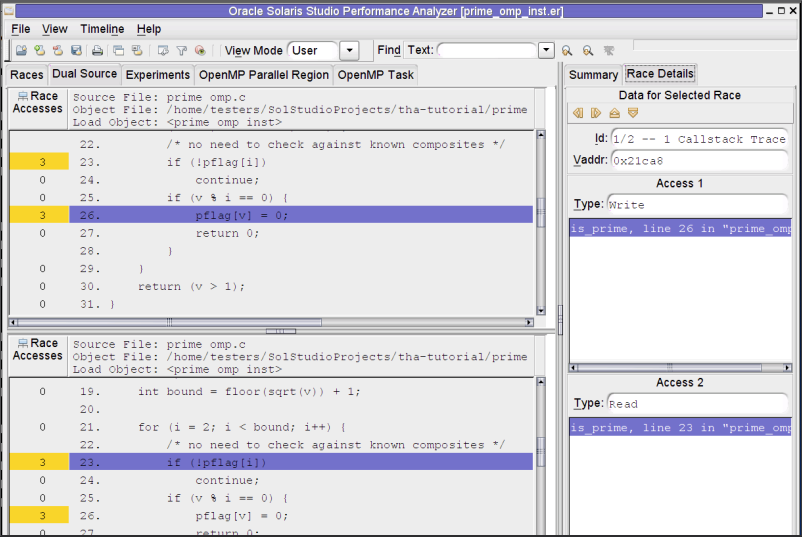

Race #1 shows a race between a write in the function is_prime on line 26 and a read in the same function on line 23. If you look at the source code you can see that on these lines, the pflag[ ] array is being accessed. In the Thread Analyzer, you can click the Dual Source tab to easily see the source code at both line numbers along with metrics showing the number of race accesses on the affected lines of code.
Race #2 shows a race between two writes to line 50 of the main function. Click the Dual Source tab to see that there are multiple attempts to access the value of the primes [ ] array in line 50.
Race #2 represents a group of data races that occur in different elements of the array primes[ ]. This is indicated by the Vaddr specified as Multiple Addresses.
The Dual Source tab in the Thread Analyzer allows you to see the two source locations associated with a data race at the same time. For example, select Race #2 for prime_pthr.c in the Races tab and then click on the Dual Source tab. You will see something similar to the following.

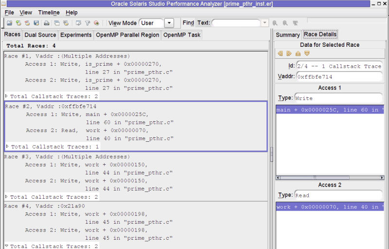

The following screen shot shows the races detected in prime_pthr.c as displayed by the Thread Analyzer. Notice that they are the same as the races shown by er_print.
Figure 2-3 Data Races Detected in prime_pthr.c
Four data races are shown in prime_pthr.c:
Race #1 is a data race between a write to the pflag[ ] array in function is_prime on line 27 and another write to pflag[ ] on the same line.
Race #2 is a data race between a write on line 60 to the memory location named i in main() and a read on line 40 from the same memory location (named *arg in work()).
Race #3 is a data race between a write to primes[total] on line 44 and another write to primes[total] the same line.
Race #4 is a data race between a write to total on line 45 and another write to total on the same line.

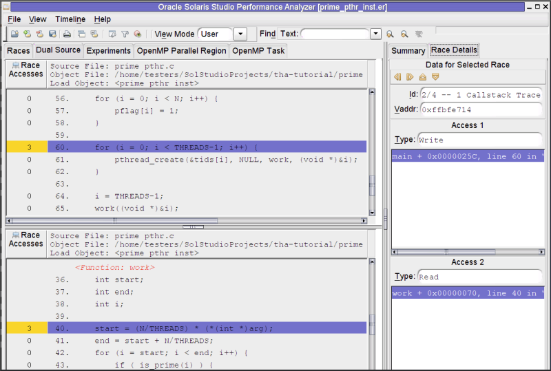

If you select Race #2 and then click the Dual Source tab, you see the two source locations, similar to the following screen shot.
Figure 2-4 Source Code Details of a Data Race
The first access for Race #2 is at line 60 and is shown in the top panel. The second access is at line 40 and is shown in bottom panel. The Race Accesses metric is highlighted at the left of the source code. This metric gives a count of the number of times a data race access was reported on that line.

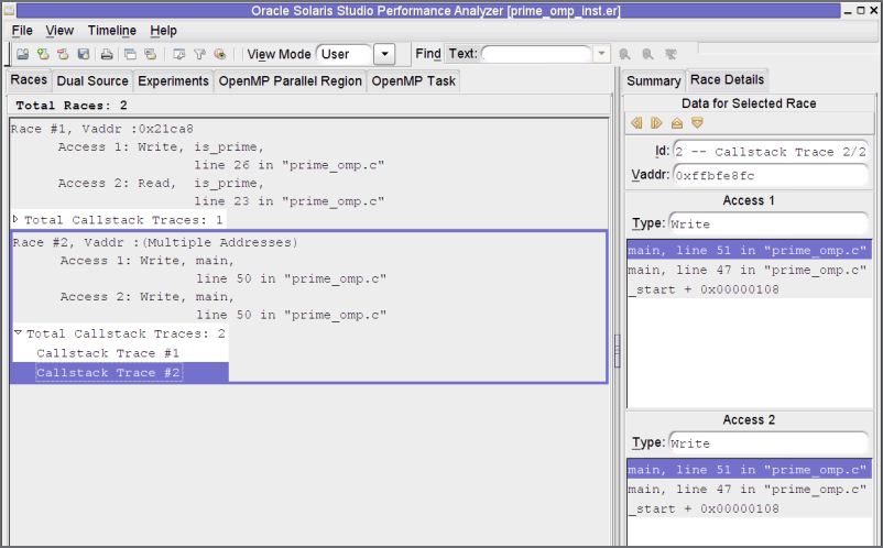

Each data race listed in the Races tab of the Thread Analyzer also has one or more associated Call Stack Traces. The call stacks show the execution paths through the code that lead to a data race. When you click a Call Stack Trace, the Race Details tab in the right panel shows the function calls that lead to the data race.
Figure 2-5 Races Tab with Call Stack Traces for prime_omp.c
