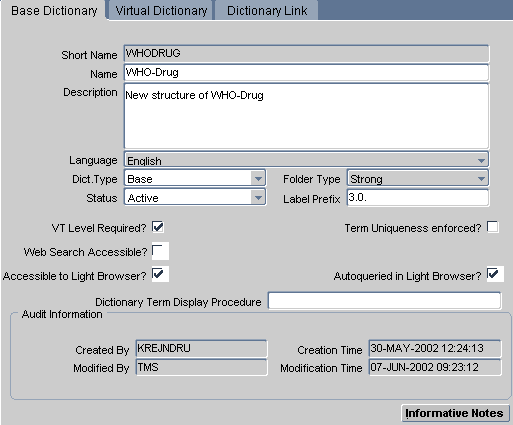

To set up a virtual dictionary in TMS, choose a base dictionary (and activate it, if the base dictionary is still provisional), define the virtual dictionary's name and cut-off date, and assign the virtual dictionary to a domain.
Define and activate the base dictionary on which you want to base the virtual dictionary; see "Defining a Dictionary" and set it to active; see "Setting the Dictionary's Status to Active".
Load data into the base dictionary and activate the data; see "Loading a Dictionary".
With the base dictionary displayed in the Base Dictionary tab of the Define Dictionaries window, click the Virtual Dictionaries tab.
From the Record menu, choose Insert Record. The system displays values for most fields that are inherited from the base dictionary. You can modify the Short Name, Name, and Description to make them more meaningful.
Define a Cut-off Date. All terms current at the point in time you specify will constitute the virtual dictionary. You cannot change the cut-off date after saving. Click in the Cut-off Date field. If other virtual dictionaries have been created for the same base dictionary, their cut-off dates are available in the LOV. If not, you can enter the date using the format:
DD-MON-YYYY HH:MM:SS
for example, 01-NOV-2006 10:01:15
You can enter the date portion only and the system will enter a time of midnight.
If a Release Label has already been associated with the timestamp you selected, the system displays it in the Release Label field. You can modify it if necessary. Save.
When you are satisfied with your virtual dictionary definition, set its Status to Active and Save.
You can then assign an Informative Note of type Dictionary Version to the virtual dictionary by clicking the Info Notes button. See "Defining Dictionary-wide Informative Notes" for instructions.

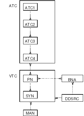

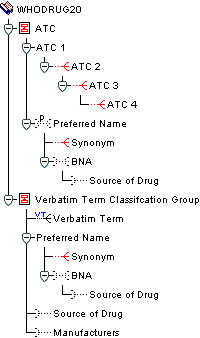

TMS provides flexibility in designing dictionaries, including those supplied by vendors. You can design the dictionary structure, ranking levels hierarchically and/or creating levels at the same rank. You can define the cardinality and optionality of level relations, and specify a Primary Link or Primary Path Link between levels.
Basic strategies for organizing dictionary structure include:
Ranking levels in a vertical hierarchy so that terms become more general and fewer in each higher level of the hierarchy, effectively organizing lower-level terms into categories.
Adding levels horizontally, at the same rank, to provide supplementary information about terms, such as preferred names or indications.
Assigning levels to group levels to promote efficiency and enforce Primary Links to more than one level (see "Requiring a Primary Link to a Group Level").
Defining the classification level as a group level that includes both the conventional classification level and a synonym level with a many-to-one relation to the classification level. In this case, TMS searches in both sublevels for a match to a verbatim term. If it finds a match in the synonym level, it creates the VTA to link directly to the related conventional classification level term. Because of this behavior, using group levels as classification levels greatly increases the likelihood that a match will be found without increasing the number of terms in the conventional classification level.

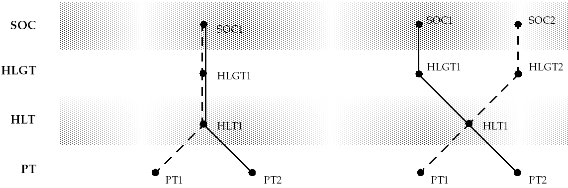

When a Primary Link is required, it is possible to create a Domain Primary Link for a particular term to override its Global Primary Link within a particular domain.
When you define a group level, you can define primary relations from terms outside (and below) the group level to the group level in two different ways:
Primary Link. If you define a Primary Link to the group level, and Many cardinality is defined on the higher side of level relations, the lower-level term can have links to multiple terms on multiple levels in the group level, but only one link can be the Primary Link. The Primary Link can be between the lower-level term and a single term on any level within the group level.
Primary Path Link. If you define a Primary Path Link to the group level, a term in the lower level can have links to multiple terms in multiple levels within the group level, but it must have a Primary Link to a term in the lowest level within the group, and to a related term in the next highest level, all the way to the top level.
You must load or define the Primary Link for each lower-level term to a term in each of the group levels from the bottom up. TMS restricts your choices at each level to terms that are related to the Primary Link term in the immediately lower level. Thus, different lower-level terms can have a Primary Link to the same term in the lowest group level but different terms in the higher group levels (see Figure 6-2).
Primary Path Links are designed to accommodate MedDRA's structure.
See "Grouping Levels" for background information on group levels.
Figure 6-2 shows derivation paths using Primary Link (on the left) and a primary path (on the right). In these examples, all relations between levels are many-to-many, so Primary Links are required for each relation in the derivation path.
The example on the left shows a dictionary structure without a group level, where a Primary Link is required between each level and the next higher level. Terms PT1 and PT2 are both defined with a Primary Link to the same term—HLT1—in the next higher level. Their derivation path is the same because the rest of the derivation path depends on the Primary Links defined for the higher-level terms: HLT1 has a single Primary Link to HLGT1, which has a single Primary Link to SOC1.
The example on the right shows a dictionary structure where the HLT, HLGT, and SOC levels are all included in a group level, but a primary path is defined between the PT level and the group level. In this case, terms PT1 and PT2 can be linked to the same term in the HLT level and yet be linked to different terms in the two higher levels. This model conforms to MedDRA's structure.
Note that there is a third possible structure. If you defined the same group level as in the example on the right—containing the SOC, HLGT, and HLT levels—and defined a Primary Link from the PT level to the group level instead of a Primary Path Link, then the terms PT1 and PT2 would each link to HLT1 but, if Many cardinality were defined from the HLT to the HLGT and from the HLGT to the SOC, their derivation path would end there. No higher level terms could be derived because no other Primary Links or primary paths would exist.If Single cardinality were defined from the HLT to the HLGT and from the HLGT to the SOC, and those levels were defined as reportable and their relations as derivable, the derivation path would continue all the way to the SOC level.
Figure 6-2 Derivation Path Examples for MedDRA

For example, you could define WHO-Drug as shown in Figure 6-3, with two group levels, ATC and classification level VTC:
Figure 6-3 Group Levels in a Sample WHO-Drug Dictionary
This definition of WHO-Drug makes use of the Group Level feature as described in the following two sections.

Group levels do not fit easily into a standard tree structure display. TMS displays them as follows:
If a group level exists below the top of the hierarchy, its sublevels are displayed twice: once below the group level, which is displayed as a sibling level to the level above (because it cannot be defined as a child level), and once directly under the higher level with the relation between the top sublevel and the higher level displayed.
The Group Level icon is displayed to the left of the group level.
The relation icons (lines, dotted lines, and branches) appear in color for all sublevels within a group except the topmost, which by definition cannot have a conventional relation defined to the group level.
This display is for a sample WHO-Drug dictionary as shown in Figure 6-4.

To use a dictionary in TMS you must define it in the TMS user interface. This section includes the following topics:
The Base Dictionary tab of the Define Dictionaries window enables you to define the high-level settings of a dictionary and to set a dictionary's status from Provisional to Active. This section discusses definition only, because you must keep the dictionary status set to Provisional while you complete the definition tasks. You use the Base Dictionary tab to set a dictionary to Active status later on. See "Setting the Dictionary's Status to Active".
The high-level dictionary definition includes:
The dictionary's name, short name, and description.
Whether the dictionary is a base dictionary, virtual dictionary, of filter dictionary; see "Virtual Dictionaries" and "Filter Dictionaries".
The dictionary structure (strong or weak); "Strong Dictionaries".
The language of the dictionary's terms and relations.
The Release Label prefix.
Other settings that drive aspects of dictionary structure and the dictionary's availability to other components in TMS.
Appendix A, "Sample Dictionary Definitions" contains the definitions you must use in order to successfully load and activate practice dictionary CLS.
To define the basic dictionary settings:
From the Definition menu, select Define Dictionaries. The Define Dictionaries window opens, with the Base Dictionary tab selected (Figure 6-5).
Figure 6-5 Tabs in the Define Dictionaries Window
Choose whether you want to create a base, filter, or virtual dictionary.
For a base or filter dictionary, begin by highlighting the Dictionaries line in the tree structure and select Insert Record.
For a virtual dictionary, select an active base dictionary folder in the tree and click the Virtual Dictionary tab. Select Insert Record. See "Virtual Dictionaries" for further information.
Define the dictionary itself (Name, Short Name, Description).
Notes:
Special characters are not allowed in the Short Name definition.
The short name must be exactly the same in the GUI definition and in the load script. For the practice dictionary, this is CLS.
To delete a dictionary, you must place the cursor on the right side of the window in the Dictionary field (not the Dictionary Name in the tree). Before you can delete the dictionary itself, you must delete all the dictionary data, its levels, and set it to Provisional status.
The following steps apply to base dictionaries only. Virtual dictionaries inherit all of the settings from the steps below from their base dictionaries.
From the Language list, select the language for this dictionary. You can link terms in dictionaries that have different languages by using named relations of type Translation.
From the Dict. Type list, select one of the following:
Base. Select Base to define a dictionary published by an external organization (such as MedDRA or WHO-Drug, or a legacy dictionary developed by your company.
Filter. Select Filter to use MedDRA SMQs or a similar standardized query dictionary; see "Filter Dictionaries" for further information.
From the Folder Type list, select Strong to create a strongly defined dictionary or Weak to create a dictionary folder.
Leave the Status set to Provisional until you are ready to activate and use the dictionary; see "Setting the Dictionary's Status to Active".
Enter a Label Prefix. Accept the default value of 1. or enter the prefix of your choice. TMS automatically concatenates this value with a build number that represents the number of times Activation has been run on the dictionary. If you use a numerical prefix, you may want to end it with a period/full stop (.) to separate the prefix from the build number.
You may want to use additional decimal places to accommodate point releases of the same dictionary, and you may want to use the dictionary's official release number.
For example, if you define a label prefix of 3.0. when you initially load WHO-Drug 3.0, TMS assigns a Release Label of 3.0.1 to the successfully activated terms and relations the first time you run Activation on the Activation Group, 3.0.2 the second time, and so on. You can use Release Labels, including the label prefix, to define named relations of type Release Label (RL); see "Defining Named Relations".
You can also use a text prefix such as MEDDRA, or a prefix that combines text and numbers, such as MEDDRA7.0.
Assess the following options for your dictionary, selecting the appropriate boxes:
VT Level Required? For strong dictionaries only. If selected, you must define a classification level or classification group level in your dictionary—which, in turn, creates a Verbatim Term level—before you can activate this dictionary. In the TMS modules that deal with verbatim terms (every module under the VTA Maintenance and Omission Management nodes, as well as Browse VT Classification Data), TMS populates the list of values in the Dictionary field from the set of dictionaries that have a VT Level Required? selected.
Web Search Accessible? If selected, the dictionary is available for use in the Research/Document Repository tab in the HTML Browser (see Chapter 14, "Using the HTML Browser").
Accessible to Light Browser? Can the dictionary be used at all in the HTML Browser? If selected, TMS users will be able to browse and search this dictionary's terms, relations, and VTAs in the HTML Browser.
Before activating this option, consider this dictionary' usage and the sensitivity of its data. The HTML Browser may be set for Auto-login, meaning that users do not have to enter a user name and password to browse accessible data. If this dictionary data is sensitive, you may not want to make it available in the HTML Browser.
Do check this flag for filter dictionaries to enable filter dictionary searches using MedDRA SMQs.
Term Uniqueness Enforced? If selected, terms in this dictionary must be unique over the scope of the entire dictionary. When you choose to enforce uniqueness for an entire dictionary, you in turn enforce term uniqueness on all levels and group levels within that dictionary.
Autoqueried in Light Browser? Is the dictionary available for browsing in the Exploration/Hierarchies tab of the HTML Browser? If selected, the HTML Browser automatically queries for all terms in the top level of the dictionary when you select the dictionary in the main HTML Browser window. This setting is appropriate only for strong dictionaries (dictionaries with hierarchical levels defined).
Not recommended for dictionaries in which most or all of the terms are stored in the highest or only level, because autoqueries in such dictionaries can be very time- and resource-consuming.
The Terminologies tab in the HTML Browser appears only if both Autoqueried in Light Browser? and Accessible to Light Browser? are checked for at least one of the dictionaries linked to the current domain.Dictionary Term Display Procedure If desired, specify a procedure in this field to modify the behavior of the Dictionary Term field in VT classification and reclassification. By default, TMS displays the dictionary term to which the selected verbatim term is classified, if any. By writing a procedure and specifying it for a dictionary, you can display a different term in these fields.
For details about writing a Dictionary Term Display Procedure, see "Dictionary Term Display Procedure". Because this feature is only relevant for verbatim term classification, enter a procedure in this field only for strong dictionaries with verbatim term levels.
Save. For a base dictionary, TMS inserts the new dictionary into the tree structure. Virtual dictionaries do not appear in the navigation tree within the Define Dictionaries module. In either case, TMS populates the audit information fields.

When you are satisfied with all the dictionary's definitions, set its status to Active in the Status field of the Define Dictionaries window and save.
Once a dictionary is set to Active status, you may set its status back to Provisional only as long as it has no terms, TMS domains or VTAs associated with it, or if the dictionary has any Translation Derivation Links. However, you can still add levels to a weak dictionary folder even when it is set to Active status.
When changing the Active/Provisional status for a base or virtual dictionary, keep the following rules in mind:
An Active base dictionary cannot be set to Provisional if an Active virtual dictionary based on it exists.
A base dictionary set to VT Level Required cannot be set to Active unless it has one and only one verbatim term level.
A Provisional virtual dictionary can be deleted at any time.
A virtual dictionary with status Active cannot be deleted.
The status of a virtual dictionary cannot be set from Active to Provisional if it is assigned to a domain.
A base dictionary cannot be deleted if there are search objects associated with it.
Changing the status of a base dictionary that has a virtual dictionary defined to provisional deletes the Provisional virtual dictionary.
Table 6-3 describes which activities are allowed when the dictionary is Provisional and when you set it to Active.

Creating a Cross-dictionary Link
To create a cross-dictionary link in the TMS user interface:
From the Define Dictionaries window, choose either dictionary in the relation by clicking its name in the structured part of the window.
Click the Dictionary Link tab. The Define Dictionaries window displays the Dictionary Link tab window.
Choose Record, then Insert.
From the Link Type field, choose Cross Dictionary Link.
From the To Dictionary list, choose the dictionary to which you want to link.
Save. If both dictionaries satisfy the linkage criteria listed above, TMS commits this cross-dictionary link to the database.
You can create links from one dictionary to multiple target dictionaries. Select links to other target dictionaries by selecting the next lines and inserting records.
You can break a cross-dictionary link by deleting its row from the Dictionary Link tab window. TMS allows you to remove a cross-dictionary link only if no dictionary named relations have been defined between the linked dictionaries.
