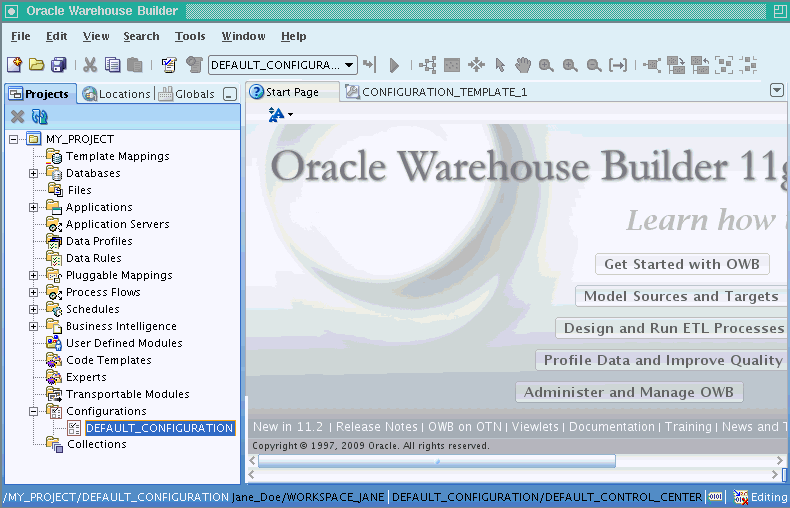

When you install Warehouse Builder and create a new repository, you have a default project with a single automatic default configuration, DEFAULT_CONFIGURATION. See Figure 8-1 and note that each new project has an automatic DEFAULT_CONFIGURATION. You can observe this by expanding the Configurations node in Project Navigator. Note also that the active configuration appears on the toolbar as DEFAULT_CONFIGURATION.
This default configuration contains the default physical properties of all the data objects in the project; these properties are necessary for deployment. As a single entity, the DEFAULT_CONFIGURATION enables deployment to the default control center, DEFAULT_CONTROL_CENTER, and default agent, DEFAULT_AGENT, which are necessary to the internal workings of Warehouse Builder.

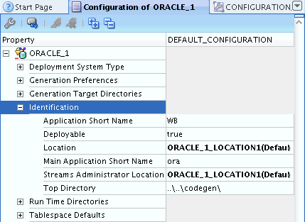

The key role of a configuration is to determine which Control Center Service and Control Center Agent manage the deployment and the deployment location. A configuration is always associated with only one Control Center and CCA, and specifies which of the services controls the deployment of any objects when this configuration is active. The configuration settings of the design objects control the Location property. For example, each Oracle Database module has a configuration property Location; the value of the Location property must be a reference to an Oracle Database location, and it determines where any objects inside the module are deployed.
The other role of configurations is to capture information specific to the creation and use of an object for a specific location. For example, you can define the tablespace where a new table should be created.

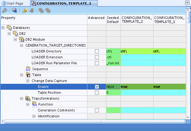

Configuration details are grouped by type, such as performance parameters, storage space for tables, and so on. Because each object type can have a number of configuration properties that are not used or have general defaults, OWB uses Configuration Templates to simplify how much the user needs to do.
Configuration Templates may be used to override automatic default values for configuration properties and to flag the properties for either the general set or the advanced set. For example, one may move the less frequently used configuration properties to the advanced set.

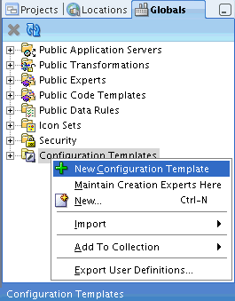

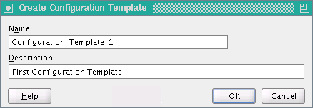

To create a configuration template:
In the Globals Navigator, select Configuration Templates.
Right-click Configuration Templates, and select New Configuration Template.
The Create Configuration Template wizard opens. Note that on every screen of the wizard, you have the option of clicking Help to get more information.
On the Name and Description screen, enter the Name of the new configuration template, and optionally, its Description.
Click OK.
The new Configuration Template appears in the right pane of the OWB console.
Note that when you create a new configuration template, its default setting of advanced options is initially set to be identical to previously created configuration templates.

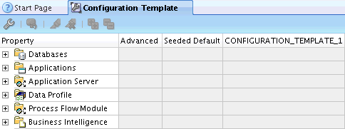

To edit the configuration values in a template, use the Configuration Template Editor, which allows you to set the configuration properties of objects to Advanced, and to override the existing configuration defaults.
Note that the configuration template editor can show the different templates side by side, to make it easier to compare and edit multiple templates.
To edit a configuration template:

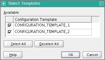

In the Globals Navigator, under Configuration Templates, click the Manage Configuration Template Columns icon.
In the Select Templates window, select the templates you want to edit.
Click OK.
Click the Expand All icon.
Make changes to the side-by-side templates.

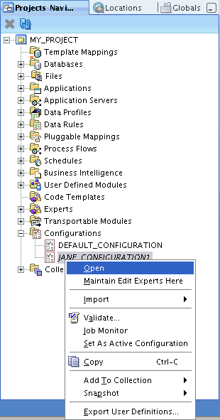

To activate a configuration:
In the Project Navigator, select a project and expand its navigation tree.
Expand the Configurations folder.
Select a configuration.
Right-click the selected configuration; from the menu, select Set As Active Configuration.
All changes that you make to the configuration parameters of objects are saved in this configuration. If you switch to the previous configuration, these parameters show the settings of that configuration.
The Control Center service and Control Center Agent associated with this configuration are now set; they manage all future deployments or executions.
When you choose the Configure option for any object, it shows the set of configuration properties with the default values that are defined in the Configuration Template. You can expand the Property tree to see all properties.
Configuration defines the physical characteristics of data objects. These may include defining a tablespace and setting performance parameters in the configuration of a table.
Note that you may change the configuration of an object at any time before deployment, and that it is possible to define multiple configurations for the same set of objects. This is particularly useful when deploying to multiple environments, such as test and production.

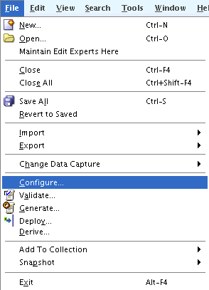

To configure an object:
In the Project Navigator, select the object to configure.
In the File menu, click Configure.
The Configuration editor is displayed.
Select a parameter to display and edit its value in the right-side panel.
Click Help for additional information.
