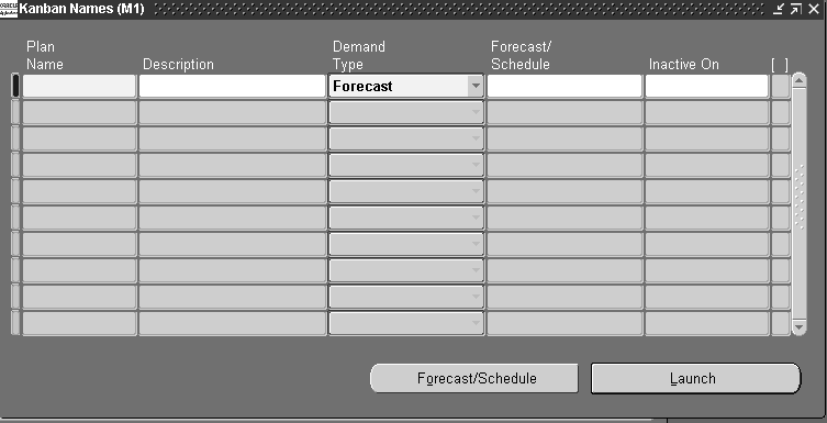

Navigate to the Kanban Names window.
Enter a new plan name.
You can enter any name you want for this simulation plan.
Note: An implicit plan named Production is created by the application to enable kanban comparisons.
Enter a description to help you remember what's unique about this simulation plan.
Select an input type to tell the quantity calculation program whether to use the demand information from a forecast, an MDS, an MPS, or Actual Production.
A list of choices appears in the Forecast/Schedule field.
Select the name of the specific forecast or schedule you want to use.
Choose the Forecast/Schedule button to see more detail about the selected forecast or schedule. Then navigate back to the Kanban Names window.
Optionally, enter the date on which this simulation plan is to become inactive.
If the window displays more than one plan, choose which plan you want to do the calculation.
Choose the Launch button to start the calculation program.

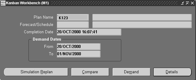

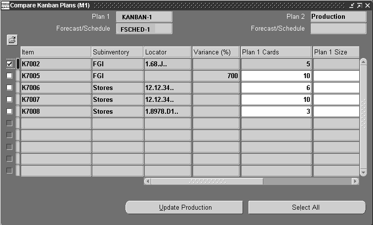

To view a kanban calculation, compare two plans, and update parts of your production plan
Navigate to the Kanban Workbench window.
Query the simulation plan you're interested in.
Choose Compare. The Find Kanban Comparison window appears.
Choose Find to find all items in the plan or narrow down your search by entering search criteria. To narrow your search, enter one of the following in the Field field:
Item: if you want to limit your search to only certain kanban items.
Kanban Number: if you want to limit your search to only items within a particular range of kanban cards (for example, items requiring more than 10 kanban cards).
Kanban Size: if you want to limit your search by kanban size (for example, items with kanbans that contain between 20 and 100 units).
Locator: if you want to limit your search to only items with a particular locator.
Subinventory: if you want to limit your search to only items with a particular subinventory location.
Category: if you want to limit your search to only items in a particular category.
Planner: if you want to limit your search to those items planned by a employee associated to the items.
Variance: if you want to limit your search to only items with a certain variance percentage from the manually entered plan.
Enter the condition and values for From and To.
Choose Find to find the items that match the criteria you've entered. The Compare Kanban Plans window appears.
Notice the variances between your simulation plan and your production plan.
Some items may have higher variances than others. You can decide by item which parts of the simulation plan to merge with the production plan, updating the production plan with those parts of the kanban calculation that make sense to you.
Choose the check box next to each item for which you want to update the production plan with the simulation plan. Then choose Update Production.
To change one or more variables and re-launch the plan
Choose the Details button.
The Find window appears.
Choose Find to find all items in the plan or narrow down your search by entering search criteria and then choosing Find.
In the window that appears, choose the check box next to each item for which you want to make an adjustment.
In the Calculate column for each item that you checked, choose what you want to calculate.
For each item that you checked, scroll to the field whose value you want to change and enter a new value for the field.
You can change these fields: Kanban Size, # of Kanbans, Source Type.
When you've made all the adjustments you want, choose Simulation Replan.
This button sends a request to the kanban calculation program to generate a new simulation plan based on the new values you've entered. After the request has been processed, you'll be able to see the results of the kanban calculation from the Kanban Workbench, just as you would for any simulation plan.
You can update your plan from these results by selecting pull sequences and choosing Update Production.
