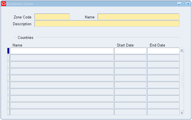

You use the Economic Zones form to define the economic zones where you conduct business. The Economic Zone form enables you to add and remove the countries that make up an economic zone. You may create any number of economic zones. For example, the European Union and the North American Free Trade Association (NAFTA) are economic zones.
Economic zones are used for gathering, reviewing, and reporting statistical information associated with material movements within the specified zone. Oracle's movement statistics solution uses this information to determine which material movement transactions take place in a reporting jurisdiction.
Oracle's movement statistics solutions provides a pre-seeded (pre-loaded) Economic Zone:
European Union (EC)
Movement Statistics Economic Zone Window
Economic Zone Definition Process
Verify economic zone: Movement Statistics provides a pre-seeded (or pre-loaded) Economic Zone. This step verifies that the European Union Economic Zone has been loaded.
Add additional economic zones: Add additional economic zones (other than the pre-seeded zones) as required.
Note: You can associate a country with more than one economic zone.
Update economic zones: Update an existing economic zone (add or remove countries) as required.

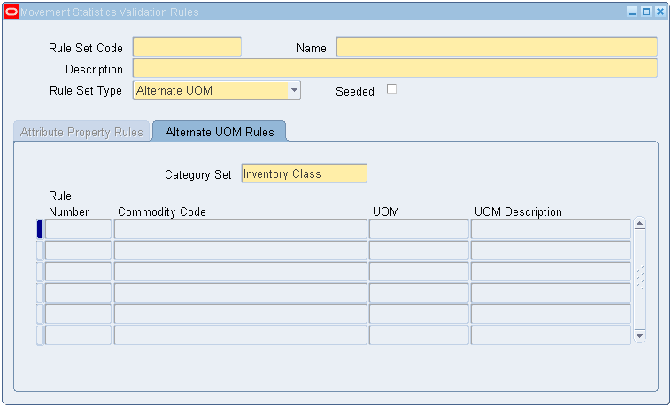

You use the Movement Statistics Validation Rules form to define and maintain the following rule types:
Attribute Property Validation Rules: used to validate movement transactions in order to properly report transaction information
Alternate Unit of Measure (UOM) Rules: used to set up alternate units of measure to the default unit of measure

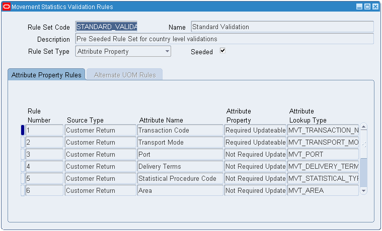

Oracle's movement statistics solution provides a pre-seeded (pre-loaded) attribute property validation rule set called Standard_Validation. You may also define you own validation rule.
There is no pre-seeded Alternate UOM. If you require Alternate UOM Rules, you must define your own.
Whether you define your own validation rules or use the pre-seeded one, you use attribute property validation rules to specify what data is required for your specific reporting needs.
Oracle's Validation Rules and Exception Report work together: if required data is missing or incorrect (as specified by a validation rule) an exception will be raised and listed on the Movement Statistics Exception Report.
Movement Statistics Validation Rules Window (for Attribute Property Rules)
Movement Statistics Validation Rules Form (for Alternate UOM Rules)
Define the Attribute Property Rule Set: Optionally, define a new attribute property rule set.
Note: A pre-seeded Attribute Property rules Set name : Standard_Validation is provided.
you do not need to perform this step if you plan to use the pre-loaded rule set.
Define the Alternate UOM Rule Set: Define the Alternate UOM Rule Set.
Note: There is no pre-seeded Alternate UOM rule Set.
You use the same window to define the Attribute Property and the Alternate UOM

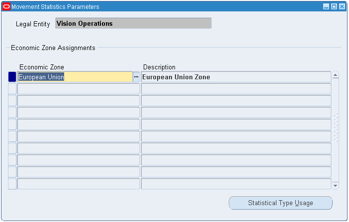

Use the Movement Statistics Parameters form to define and maintain the parameters for gathering movement statistics. The parameters that you define are used by the Movement Statistics Processor to collect movement transaction data and create movement statistics records.
The Movement Statistics Processor captures and report movement statistics by legal entity. You are required to define Movement Statistics Parameters for every legal entity to capture statistics.
You use two forms for defining and maintaining Movement Statistics parameters:
Movement Statistics Parameters Form

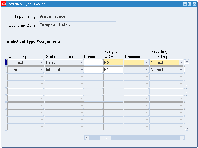

Statistics Type Usages form
Movement Statistics Statistical Type Usages Form
Define Movement Statistics Parameters Process
Define the legal Entity Economic Zone Assignment (required): You must assign the Economic Zones to the Legal Entities where you plan to capture movement statistics data.
Note: You must assign an economic zone to every legal entity you use.
Define the Legal Entity Economic Zone parameters: Define the specific usage types, statistical types, and other parameters for the Legal Entity Economic Zones.
Note: You must assign parameters for all Legal Entity Economic Zone pairings you define.

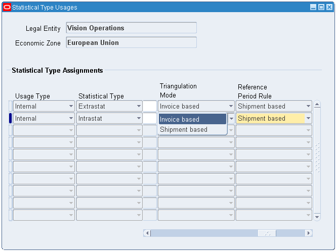

The Economic Zone parameter defines the behavior of Oracle's movement statistics solution. You must define the parameters for every Legal Entity - Economic Zone pairing you have defined. The following parameters must be set:
| Parameter | Possible Values | Comments |
| Usage Type | Internal External | Internal: Movement of goods within countries of the specified economic zone External: Movement of goods from a country of one economic zone to a country outside the economic zone |
| Statistical Type | Intrastat Extrastat | Intrastat: Declaration of imports and exports within EC Extrastat: Declaration of import and exports between EC and countries external to EC |
| Period Set | Period Set Name | Select a Period Set (from LOV) that reflects your reporting frequency (monthly, quarterly) |
| Period Type | Period Type | Select a Period Type (from LOV) to use for reporting. Note that the calendar you use for statistical reporting purposes is independent of the accounting calendar for your organization's set of books. |
| Start Period End Period | Start Period End Period | Assign the first period for which the Usage / Statistic type assignment is valid. Optionally, enter the last period for which this assignment is valid. |
| Weight UOM | Weight Unit of Measure | Enter the default UOM. Note: INTRASTAT requires weight (mass) to be reported in KG |
| Precision | 0 to 5 | Enter the number of decimals the total weight should be rounded to. The default value is 0 (zero) meaning the weight will be rounded to the nearest digit. |
| Report Rounding | Possible values:
| Set up how the calculated weight will be rounded:
| Dispatch KIT Method | Possible values:
| Indicates how movement records should be created for KIT dispatches:
| Entity Branch Reference | Entity Branch Reference | Enter the name of the legal entity branch. Note: this reference is printed on the European Union INTRASTAT and EXTRASTAT declaration. |
| Conversion Type | Conversion Type | Select the currency conversion type (from LOV) to use to convert foreign currency amounts to the functional currency of your organization's set of books. |
| Conversion Option | Conversion Option | Select the conversion option (daily or last day of the period) to convert foreign to functional currency. |
| Category Set | Category Set | Select the category set that you defined for the INTRASTAT Commodity Codes. Note: you must define category sets (see: Commodity Codes using Category Sets in this guide). |
| Tax Office Code | Tax Office Code | Enter the Tax Office Code of the tax office to which your legal entity reports. |
| Tax Office Location Code | Tax Office Location Code | Enter the Name for the tax office to which your legal entity reports. |
| Attribute Rule Set | Enter the validation rule set code. | The default rule set is ‘Standard_Validation'. You may define your own rule set. |
| Alternate UOM Rule Set | This parameter is optional. | You will need to define an Alternate UOM Rule Set. |
| Triangulation Mode | Invoice Based Shipment Based | Triangulation Mode determines how the Movement Statistics Processor will process Triangulation (drop-shipments): Invoice Based: the processor will process movement transactions based on the flow of the invoice Shipment Based: the processor will process movement transactions based on flow of goods See: Triangulation Support in the following section of this chapter. |
| Reference Period | Shipment Based Invoice Based | Shipment Based: the date that the transaction took place Invoice Based: the date the transaction was invoiced Refer to the Reference Period section in this chapter |
| Advance Invoice Days | User Defined | The number of days the processor should look for an advance invoice |
| Pending Invoice Days | User Defined | The number of days the processor should look for an invoice in the period following the movement transaction |

Oracle's movement statistics solution supports triangular trade with the concept of ‘triangulation mode.' Triangulation mode specifies how the Movement Statistics Processor analyzes and generates movement statistics records when it encounters a triangular trade transaction. You must determine how you will report triangular trade transactions by setting this parameter. There are two possible values for the Triangulation Mode parameters:
Invoiced Based
Shipment Based
The default Triangulation Mode parameter is invoiced based.
Invoiced Based - the Movement Statistics Processor creates movement statistics records based on the issue of an invoice only. A movement record will be created for the invoice and not for the physical movement of goods.
Shipment Based - the Movement Statistics Processor creates movement statistics records based on the movement of goods only. The invoice will not result in a movement record.

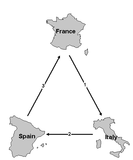

For the purposes of defining triangular trade the following triangulation example will be used:
Your Company is located in Italy and using Oracle's movement statistics solution
Your Supplier is located in Spain
Your customer is located in France
The following triangular trade takes place:
Your customer in France places an order with you in Italy.
You source the order from Spain.
Spain ships directly to your customer in France (goods are not shipped to Italy but directly from Spain to France).
The triangular trade results in the following transactions:
You send a sales order to your customer in France
You invoice your customer in France, creating the receivable
You create a purchase order for your supplier in Spain
Supplier in Spain sends you an invoice, creating the payable
Spain creates a shipment to France, satisfying the sales order
Two movement records are generated by the Movement Statistics Processor, when run in Italy, based on the Invoiced Based Triangulation Mode parameter, as follows:
Sales Order (dispatch) record from Italy to France
Movement Amount: zero (no movement of goods took place between these countries
Movement Quantity: zero (no movement of goods took place between these countries
Extended Value: calculated as the invoice quantity multiplied by invoice price
Dispatch Country: Italy
Destination Country: France
Triangulation Country: Spain
Purchase Order (arrival) record in Italy from Spain

Set the Movement Statistics Reference Period parameters
Using the Movement Statistics Parameters form, select a Reference Period Rule:
Shipment Based
Invoiced Based
Shipment Based Reference Period Rule Parameter
This is the default Reference Period Rule. To use this rule, select it from the LOV on the Movement Statistics Parameter form.
Invoiced Based Reference Period Rule Parameter: To use this Reference Period Rule you must also set two additional parameters:

This section reviews the setting up Reference Period Rules using the Movement Statistics Parameters form.
Note: please review and be familiar with the specific reporting requirements of your country when implementing Reference Period Rules.
You must set the Reference Period Parameters using the Statistical Type Usages form.
Statistical Types Usages Form
The Reference Period Parameter values determines how the Movement Statistics Processor assigns the reference date. There are two possible values for this parameter:
With this rule, the Movement Statistics Processor assigns the reference date based on the date the transaction took place (for both dispatches and arrivals). Note: this is the default Reference Period Rule.
With this rule, the Movement Statistics Processor assigns the reference date based on the invoice date (for both dispatches or arrivals).
The Invoice Based Reference Period Rule requires that two additional parameters be set:
Advance Invoice Days: this parameter specifies the number of days the Movement Statistics Processor and the Exception Report should search for an advance invoice (in the case where a transaction was invoiced before the movement transaction). The default value is 30 days, you may enter any whole number for this parameter. When the Advance Invoice Days parameter is set to 30, the Movement Statistics Processor will search for an advance invoice for 30 days prior to the date of the movement transaction.

Define Attribute Property Rule Set
Oracle's movement statistics solution provides a pre-seeded Attribute Property Rule Set called ‘Standard_Validation.' The Standard_Validation Rule Set validates (and creates an exception) for following data fields for every Source Type:
If the ‘Standard_Validation' rule set does not meet your requirements, you may define your own Attribute Property Rule Set. Defining your own rule set will enable you to specify what movement statistics data you require, by Source Type, for your country's reporting needs. The rule set that you define will validate only the fields that you specify. Additionally, all the movement statistics attributes that you choose to validate will be displayed on the Movement Statistics Exception Report when an exception occurs.
To define Attribute Property Rules using the Validations Rule form:
Name your Attribute Property Rule Set.
For Rule Number assign a unique, non-repeating rule number.
Select a Source Types from the LOV.
Select an Attribute Name to associate with the Source Type from LOV.
Assign one of the following Attribute Rule Set Property combinations:
required / not updateable
not required / updateable
not required / not updateable
Select the Lookup Type from the list of values associated with your Attribute Property. A Lookup Type is defined using the using the Lookup form (refer to the Oracle Inventory User's Guide for additional information regarding defining Lookup Types).
Note: Once you have defined your new Attribute Property Rule Set, you will have to update the Movement Statistics Parameters with your new rule set. Refer to the 'Movement Statistics Parameters' section of this guide for additional information.
Please refer to the Appendix for a complete listing all Source Types and Attribute Names that may be used in a user defined validation rule set.
Copying an Attribute Rule Set
If you decide to use a ‘user defined' Attribute Property Rule Set, you may copy an existing Attribute Rule Set using the Copy Tool. The Copy Tool will copy any existing rule set. You may then modify the copied rule set to meet your requirements.
Using the Movement Statistics Validation Rules form, query an existing rule set.
Select the Tools option locate the Toolbar.
Select ‘Copy Rule Set.'
Enter the Rule Set Code and Rule Set Name for your rule set.
Save your rule set.
You may modify any rule as your requirements dictate.
Save your rule set and all modifications.
Assign your rule set to the Attribute Rule Set Parameter located on the Movement Statistics Parameter form. For your rule set to take affect, you must perform this assignment step.
Define Alternate UOM Rule Set
Alternate UOM rules permit you to report specific commodity code transactions in a unit of measure other than the default UOM.
Alternate unit of measure rules are used in conjunction with the default Weight UOM. You define a default weight UOM when you set up Movement Statistics Parameters. Every transaction will be reported in the default UOM you have specified.
If your reporting needs require that you report movement transactions in a unit of measure other than the default unit of measure that has been specified, you will have to define one or more alternative UOM in which to report. For example, your default UOM is kilograms. However your movement of goods declaration includes the transportation of diamonds. Instead of reporting diamonds in KG, you want to report them in carats. Using the Movement Statistics Validation Rules form, you would specify an alternate UOM for the commodity code in which diamonds falls.
Note that you define an alternate UOM for a commodity code and not an item.
Note: If you define an Alternate UOM rule set, you must assign the rule set in the Movement Statistics Parameters form.
Change the Rule Set Type to Alternate UOM.
Assign a rule number.
Select a Commodity Code from the LOV.
Select a UOM from LOV.
Update the Movement Statistics Parameters form with your new Alternate UOM Rule Set.

You may define additional economic zones, other than the ones provided by Oracle's movement statistics solution.
Using the Economic Zone form, you can define additional economic zones where you conduct business. Once defined, new economic zones work the same as the pre-seeded economic zones.
If you define new economic zones, you will be required to assign them to a legal entity. Refer to the Movement Statistics Parameters section of this chapter.
