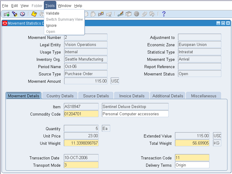

You may also validate records on-line instead of running the Exception Report. Use the Movement Statistics Detail form to perform the validation manually. Only records with a status of open may be validated.
Note: On-line validation of movement records use the same validation rules used in the Exception Report.
Query for Open records.
Query all movement records with a status of Open for a given period.
Select a record from the Movement Statistics Summary form.
Select a movement record to validate from the Summary form.
Open the record.
Open record in the Movement Statistics Detail form
Using the Tool Bar, select: Tools > Validate.
The record will be validated and all exceptions and warnings will be displayed on line.
Correct Exceptions.
Correct exceptions on-line and save the record. Note that you will only be able to save a record with the exceptions corrected. You can not save invalid data.
Record status is updated.
If the record has no exception or if you have corrected all exceptions, the status of the record will be updated to Verified.

This section reviews the exception correcting process. This process may be used to correct any exception listed in the Exception Report.
Using the Movement Id listed on the Movement Statistics Exceptions Report, query the record using the Movement Statistics Detail form (on-line).
From the Toolbar on the Movement Statistic Detail form, select Tools > Validate. This will list all exceptions with the record. You may correct the records on line. Note that until all exceptions are corrected, the status will remain open.

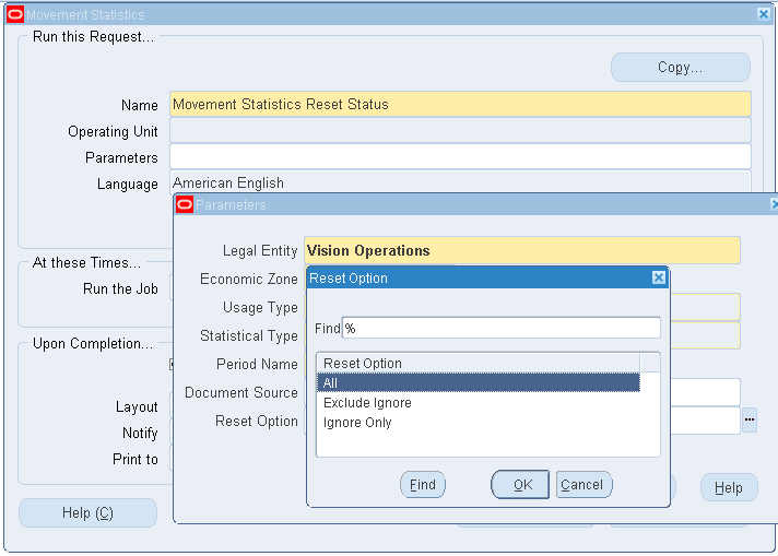

You can use the Movement Statistics Reset Status concurrent program to mass update the status of a number of movement records from IGNORE to OPEN.
Note that the Reset Status concurrent program will, by default, update ALL records for a specified Legal Entity and period to OPEN status. If you only want to update movement records with a status of IGNORE to OPEN, you must specify the correct Reset Option parameter before running this concurrent program.
You can update the status of movement record from IGNORE to OPEN on a record by record basis using the Movement Statistics Details form.
Navigate to the Movement Statistics Reset Status concurrent program.
Enter the following parameters to execute the Reset Status concurrent program:
Legal Entity
Economic Zone
Usage Type
Statistical Type
Period Name
Document Source
Reset Option
You may set the Reset Option parameter as follows:
Blank – all movement records as specified by the previous parameters will be updated to OPEN
All – the same as leaving the parameter blank, all movement records as specified by the previous parameters will be updated to OPEN
Exclude Ignore – the status of all movement records specified by the parameters will be updated to OPEN except those records with IGNORE status
Ignore Only -- the status of all movement records with status of IGNORE as specified by the parameters will be updated to OPEN. A record with any other status will not be updated to OPEN
