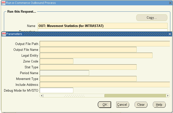

Run e-Commerce Outbound Process
Transmitting Intrastat declaration via Oracle e-Commerce Gateway process:
Create and Verify movement statistics records by running the Movement Statistics Processor
Note: the status of all records to be transmitted via the e-Commerce Gateway must be either verified or frozen
Log onto the Oracle e-Commerce Gateway application
Enter all the required parameters to extract movement statistics records
Select the Movement Statistics (MVTSO) transaction to transmit movement statistics
From the e-Commerce Gateway, run the Movement Statistics Extract Concurrent Program
Refer to the Oracle e-Commerce Gateway User Guide for detailed instructions
