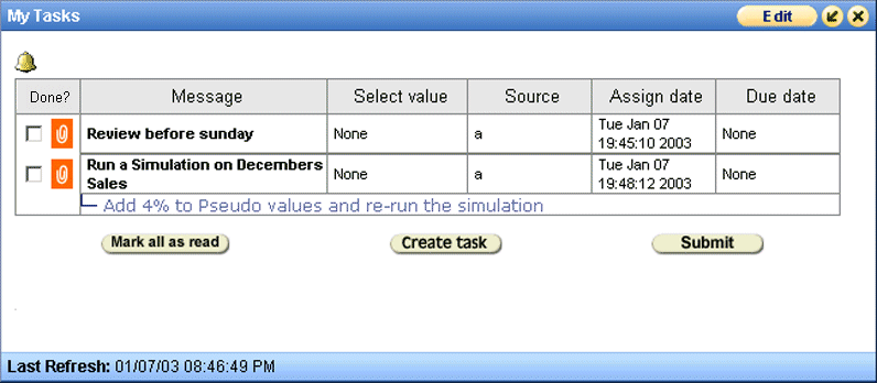

When you are sent a task, it brings with it information that is relevant to you. The information may be a Collaborator Workbench worksheet, an Oracle Demantra component worksheet, a link to another Web site, or an attachment. You should view all the information that is sent with the task before you respond.
For each task, My Tasks includes the following information:
The Message field. This can contain a link to a Web site or a worksheet.
An Assign Date field that shows when the task was sent to you.
A Due Date field that shows the date by which the task should be completed, if applicable. If you do not complete a task by its due date, Oracle Demantra automatically continues with actions as specified by your implementors.
Note: If a task due date is displayed in red, the response period for that task has nearly ended and the task is going to time out fairly soon.
A description field that describes more details about the task.
The Attachment button that indicates that a file has been attached to the task. The suitable application for viewing the attachment is started in a separate window.

To mark a task as done
Before you mark a task as done, make sure that you have reviewed all the relevant information and that you have addressed any concerns or issues. Then do the following:
First:
For a regular task, select the check box to the left of the task.
For a selection task, select the appropriate response from the dropdown list in the Select value column. The check box next to the task is automatically checked.
Click the Save & Refresh link at the bottom of the task list.
The task is removed from My Tasks and the updated task list is shown.
Caution: Click Save & Refresh before you go to another page or log off; otherwise, your changes will be lost.

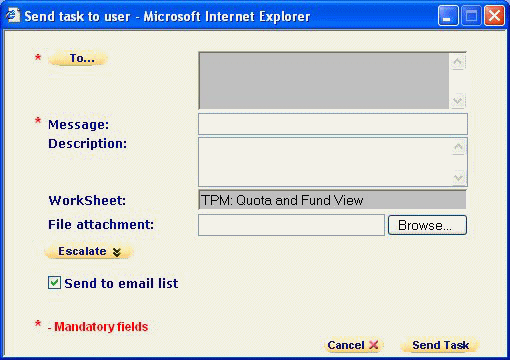

Depending on how your Collaborator Workbench has been configured, you may be able to create tasks.
To create and send a task
Start by doing one of the following:
Within My Worksheets, click Send on the worksheet that you want to send.
Within My Tasks, click Create Task.
The Send Task to User dialog box appears.
Click To..... and select the users and groups to receive the task.
In the Message field, type a short text message.
This will be the task message that the recipient sees. The worksheet that you are sending will be added automatically as a link from the Message text.
In the Description field, type a short description.
This description will be displayed below the task message in the recipient's My Tasks module.
To link the task subject line to a Web page, enter the full path to the file in URL field.
Note: You must enter the full URL, including server name and directory hierarchy. The http:// part will be added automatically if omitted.
To attach a file to the task, enter the path to the file in the File Attachment field or click the Browse button to find it.
To ensure that this task is completed by a specific time, click Escalate and then provide the following information:
Due Date | Date and time by which this task must be completed |
Alert Time | Date and time at which an alert will be displayed |
To | Additional e-mail addresses |
To send an e-mail notification to the recipient of the task, select the Send email list check box. (Depending on how your system has been configured, this option may not be available.)
Click Send Task.
When the recipient next logs in (or refreshes My Tasks), he or she will see the new task.
