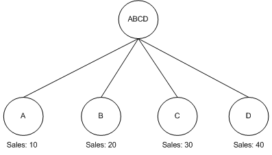

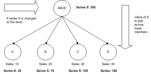

The following figure shows an upper-level member, ABCD, and its four child members. It also shows a reference series (Sales), and it shows the value of that series for each child member, all within the same time bucket.
Now suppose that series S is a proportional series that uses Sales as its reference series, and suppose that the value of S is changed to 350 for the parent member. In this case, the series S is split across the child members as follows:

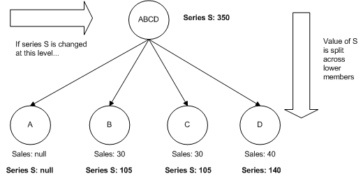

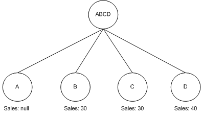

Now consider a case where the reference series has a null value for one of the child member. The proport mechanism ignores that member, as follows:
Now let us consider two cases where child members have zero values. In the first case, the reference series is zero for one of the child members, but has non zero numbers for other child members. Any member with 0 sales receives 0% of the split, as follows:
Notice that member A that has a null value for the reference series; for this member, the value of series S is null, rather than 0.
