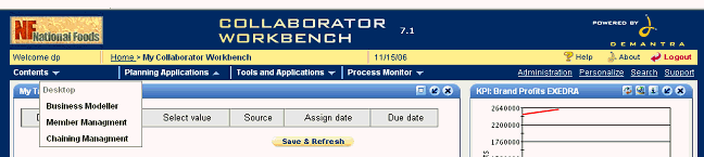

  1. The User logs into the Collaborator Workbench, and then selects Business Modeler, Member Management, or Chaining Management from the Tools and Applications Menu.
    the picture is described in the document text
