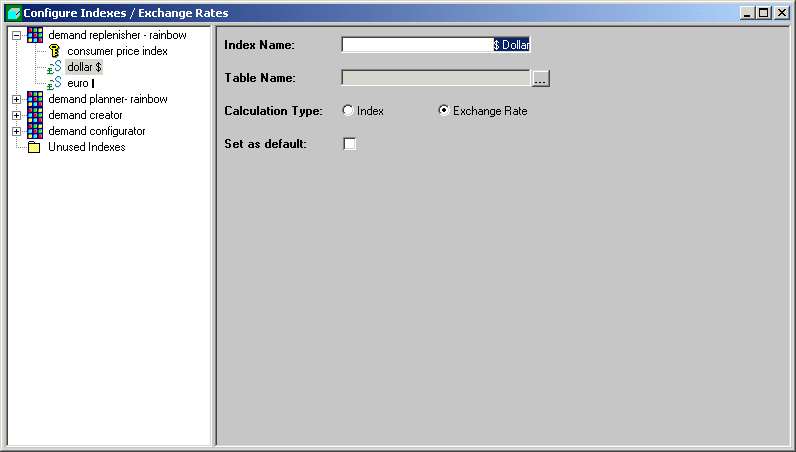

To create an index or exchange rate
Click Configuration > Configure Indexes.
The Configure Indexes and Exchange Rates dialog box appears.
Click File > New. Or click the New button.
In Index Name, type the name of the index or exchange rate, as it should appear in worksheets.
In Table Name, type the name of the table in which Demantra should store information for this index or exchange rate. Demantra will automatically create this table.
Note: For simplicity, use the same name as you used for the index or exchange rate.
For Calculation Type, click one of the radio buttons to indicate whether this is an index or an exchange rate.
Click File > Save.

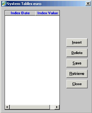

To enter data for this index or exchange rate:
Click the ellipsis (...) button next to the Table Name field.
Business Modeler displays the following window:
To add an entry, click Insert.
For Index Date, specify a date, using the date format required by the database.
For Index Value, specify the value that takes effect on the specified date. This value is multiplied by the base unit price.
Repeat as needed. When you are done, click Save.
Click Close.

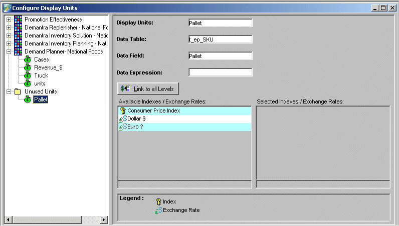

To create a size unit
Click Configuration > Configure Display Units.
The Configure Display Units dialog box appears.
In Display Units, type the name of this unit of measure, as it should appear in worksheets.
In Data Table, type the name of the table (such as t_ep_sku) in which Demantra contains conversion factors for this unit.
Note: The conversion factors must be imported, because these factors are generally different for each SKU and may vary over time.
In Data Field, type the name of the field in this table that contains the conversion factors for this unit.
In Data Expression, type an expression that retrieves the conversion factors for this unit.
Click File > Save.
The new unit is not associated with any component. To make this unit available to users, see “Creating or Modifying a Component”.

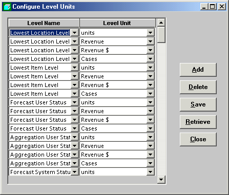

To associate a unit with a level
Click Configuration > Configure Units for Levels.
The system then displays the following list, which includes one line for each existing level-unit association.
Click Add.
In the Group column, select the level.
Do one of the following:
Click the corresponding cell in the Group Unit column and select a unit value.
Click the appropriate cell in the Group Unit column and modify its value.
Click Save to save the configuration.
Click Close to close the dialog box.

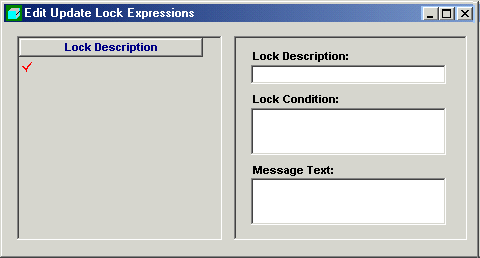

An update-lock expression checks to see if a condition is met for each combination and if so, and prevents users from updating the database (saving the changes to the combination). This expression evaluates to either true or false. If the expression evaluates to true, then when the user tries to save the combination, a message is displayed and the worksheet data is not saved. The user must correct the data before the worksheet can be saved.
To configure an update-lock expression
Click Configuration > Configure Update Locks.
The Edit Update-Lock Expressions dialog box appears.
Click the New button.
In the Lock Description field, add or edit the title of the expression.
Click the Lock Condition field.
The Client Expression Editor appears.
Create or edit an expression that evaluates to either true or false. See “Specifying Server and Client Expressions”.
Note: Be sure that any constant values are expressed as the correct type of data (numeric, string, or date) for the expression you use. For example, be sure to use double quotes around constant string values if your expression uses a string-type series.
In the Message Text field, create or edit the message to be displayed when the update-lock expression returns true. This message should be as informative as possible so that the user knows which of his or her edits is responsible for the update-lock condition.
Click the Save button.
