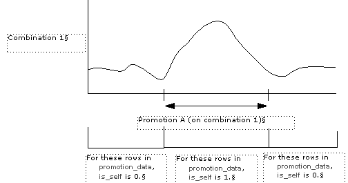

In any given row of the promotion_data, the Analytical Engine uses the is_self field to indicate whether the lifts in that row are associated with the promotion and date of that row. (Specifically, this refers to the uplift, pre and post-effect, and switching effects.) Consider the following example, with a combination that has a promotion (Promotion A) on it for some dates. For simplicity, this graph shows just the uplift on this combination due to the promotion. Each time point in this graph corresponds to a row in promotion_data. The notes at the bottom of the figure show the value of is_self for different times.
As you can see, during the dates of the promotion itself, is_self is 1. Outside those dates, is_self is 0 because these dates fall outside the promotion.

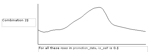

Now consider another combination and the same period of time. The sales for this other combination were lifted, even though the promotion was not applied to this combination. The following graph shows the uplift on this combination, due to Promotion A (which ran only on the other combination). Again, each time point corresponds to a row in promotion_data:
For all these rows in promotion_data, is_self is 0 because these lifts are due to a promotion that did not run on this combination.
