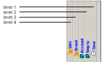

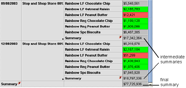

Returns an integer that indicates the relative level of the summary row where this function is used.
Note: This function is available only for use within the summary row of a series.
Syntax
GetWorksheetLevelNumber ( )
You use this function to achieve different kinds of summaries for a series in different contexts in a given worksheet. Specifically, when a worksheet uses one or more levels on the x-axis, the worksheet table includes intermediate summary rows, for example:
By default, the final summary row and all the intermediate summary rows are calculated in exactly the same way. The GetWorksheetLevelNumber function provides a way to distinguish each summary row, so that you can create a different summary functions as needed, at each of those levels.
To determine the relative aggregation level of the summary rows, the function considers the layout of the worksheet. The following figure relates the summary levels to the x-axis layout:
For level 1 in the worksheet, GetWorksheetLevelNumber returns 1, and so on. If there are n levels on the x-axis of the worksheet, the function returns n+1 for the final summary.
Example
Suppose that you want to display only the intermediate summary but not the final summary, as follows:
To achieve this, you could use a summary row expression of the following form:
If ( GetWorksheetLevelNumber() =1, SummaryMax ( Sample Max ) , Null Value )
