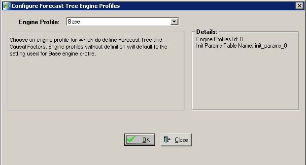

Click Engine > Forecast Tree. Or click the Forecast Tree button.
The Configure Forecast Tree Engine Profiles dialog box appears.
Select the engine profile for the forecast tree you want to modify and click OK.

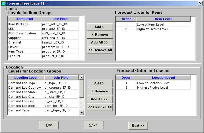

You use this dialog box to select the item levels and location levels to include in the forecast tree.
Note: As you select item and location levels in the following steps, add levels from the lowest level to the highest. Business Modeler automatically adds the highest fictive level to each list.
You can have different number of elements in these two lists.
Select the item levels to be included in the forecast tree. To do so, use the two lists at the top of the dialog box. Use any of the following techniques:
In the left list, double-click a row.
Click a row and then click Add.
Click Add All to transfer all items.
Select the location levels to be included in the forecast tree. Use the two lists at the bottom of the forecast tree, and use any of the methods described in the previous step.
When you have finished selecting levels, click Save.
Click Next.

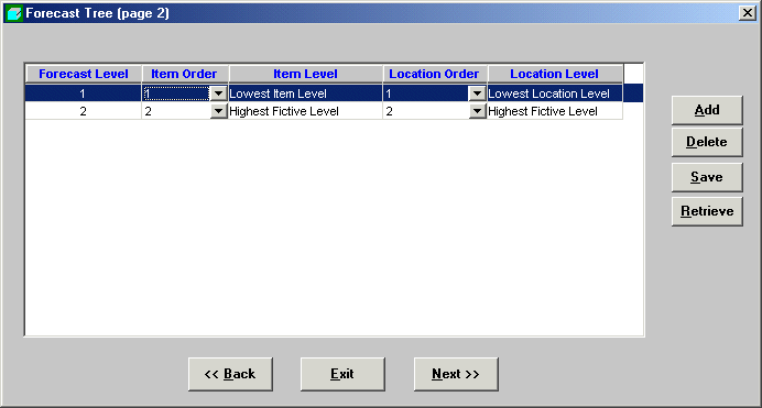

The Forecast Tree Editor displays a dialog box that you use to build the forecast tree itself.
In this dialog box, each row corresponds to a level in the forecast tree. In turn, a level in the forecast tree consists of one item level and one location level.
Note: As you build the forecast tree, add levels from the lowest level to the highest. Business Modeler automatically adds the HFL, if you do not do so explicitly.
To create a level in the forecast tree, do the following:
Click Add.
In the drop down list in the Item Order column, select an item level.
In the drop down list in the Location Order column, select a location level.
Add more levels to the forecast tree as needed, and then click Save.
Click Exit or click Next.

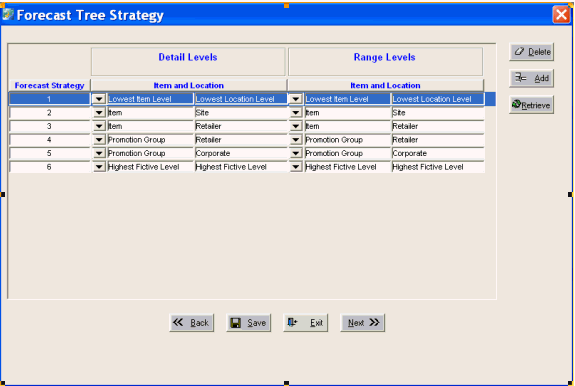

When configuring the forecast tree for Pooled Time Series, an additional configuration must be made in the forecast tree. For each forecast tree level, a Forecast Detail and a Forecast Range must be defined. Forecast Detail is the data aggregation to be used during forecast generation. For example, if a region has three stores, when setting detail to level region, the forecast node value will be the aggregation of the three stores.
The Forecast Range defines how Forecast Detail nodes are pooled together to form larger data sets with additional information. A Forecast Range can be set to the same value as the Forecast Detail. In this case, data is aggregated to the Detail node and a forecast is generated for that node independently. If Forecast Range is set higher than Forecast Detail, more than one Detail node will be pooled and concatenated together, and then forecasted together. If the above region detail level is associated with a range level of country, then all aggregated region information will be pooled together and forecasted rather than each region-based node independently.
In the example below, we see that the Item/Site detail level is associated with two range levels. The first forecast tree level (where Range and Detail are set the same: Item/Site -- Item/Site) means that when the forecast calculation is trying to generate a forecast for the Item/Site detail level, it will generate a forecast at each Item/Site node individually. However, if the forecast fails at a specific Item/Site node, then the next forecast tree level will be used. At this next level, Range is greater than Detail (Item/Site – Item/Customer). This tells the forecast calculation to generate a forecast for Item/Site using the all the Item/Sites in the range of Item/Customer.

Click Add.
In the drop down list under Detail Levels, select an item and location level.
In the drop down list under Range Levels, select an item and location level.
