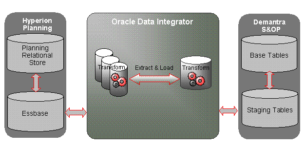

Oracle Hyperion Planning and Oracle Demantra exchange information through the use of the Oracle Data Integrator (ODI) Adapter for Hyperion Planning, the Oracle Data Integrator (ODI) to transform the data, and Oracle Demantra integration interfaces and workflows as shown in the following diagram:
The integration processes can be run when required from Demantra worksheets, workflows or ODI.

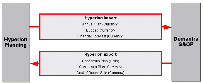

The following integration points are part of the integration between the Oracle Demantra Sales and Operations Planning module and Hyperion Planning applications.
The following table details the frequency and recommended load for each integration point is detailed below:
Interface | Flow | Suggested Frequency |
Hyperion Import | Hyperion to Demantra | Quarterly or monthly |
Hyperion Export | Demantra to Hyperion | Weekly or monthly |
The Chief Financial Officer develops the annual plan using a bottom-up planning process followed by top-down budget. The financial forecast is a refinement of the budget and includes actuals for historical periods.
The annual plan, budget and financial forecast (all currency) are exported and used in Demantra S&OP as financial performance targets to compare with the consensus forecast (in currency).
The S&OP Manager compares the financial forecast with the Demantra baseline forecast to identify gaps between the revenue predicted by the Demantra’s bottom-up forecast and Hyperion’s top-down financial plan.
A consensus forecast is developed collaboratively in Demantra S&OP
To increase demand and close revenue gaps, promotions are adjusted or created in Demantra’s Promotion Trade Planning. A demand plan and a supply plan are generated.
Value Chain Planning is used to balance constrained supply and unconstrained demand by evaluating costs and constraints. A feasible solution is returned to Demantra S&OP
Additional capacity planning is performed in Demantra S&OP The resulting consensus forecast (currency and units) and cost of goods sold (currency) are exported from Demantra to Hyperion weekly (or another regular frequency).
Revenue and profitability targets are monitored in Hyperion.
