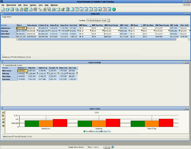

You can see or edit these funds on several worksheets. One example (PTP: Quota and Fund Entry: Top-Down) is shown below.

  4. At the top of the screen, select the territory to display.
    the picture is described in the document text
  5. In the Entry Data table, edit the quota and fund values as needed. Here you are editing values for the entire year, for a given retailer.
  6. Click Data > Save Data. Or click the Save Data button.
Entry Data
Here you enter the funds and quotas. This table shows all the quotas and funds for each retailer, aggregated over the year.

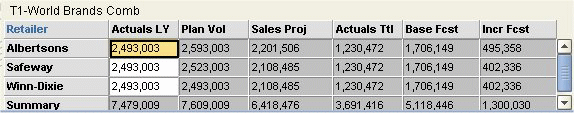

Volume Details
This table summarizes the volume information.

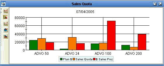

Sales Quota
This graph shows the plan, the sales quota, and the projection for each retailer.

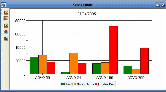

Sales Quota
This graph shows the plan, the sales quota, and the projection for each promotion group.
