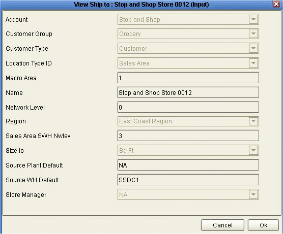

To view the attributes of an item or location
In your worksheet, find an area that is currently displaying the type of object you want to work with; see Where to Work with Items and Locations.
Right-click an object and click View (for example, View Ship to).
Oracle Demantra displays a dialog box like the following:
The attributes shown in red are required. These include the Name attribute and all immediate parents of this member. Depending on your implementation, not all attributes are editable.

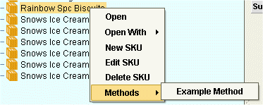

Depending on your implementation, the right-click menu may include a Methods submenu that includes additional options created by your implementors:
When you click one of these options, Oracle Demantra displays a dialog box like the following:
Select the Save parameters check box if you want to save the attribute changes to the database when the method is run.
For information on any such menu items, please contact your implementors or your designated Oracle Demantra system administrator.
