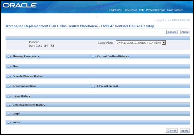

The Warehouse Replenishment Planning page organizes information into the following page title, fields, and expandable regions:
| Page Element | Description |
| Item at a warehouse (title) | This page title is determined by the plan you select from the Find Warehouse Replenishment Plan page. |
| Planner (field) | Planner or buyer responsible for this item. |
| Item Cost (field) | Cost per-unit for the item. |
| Saved Plans (menu) | Drop-down menu lists previously saved plans. |
| Planning Parameters by Supply Type (region) | Planning parameters can be set individually for each supply type. |
| Current On-Hand Balance (region) | Displays the item current on-hand, available, and excess quantities by inventory organization and supply type. |
| Plan (region) | Horizontal period by period view of requirements, current on-order, planned orders, forecast of repairable returns, and projected balances. |
| Execute Planned Orders (region) | Planned orders by source type and supplier. To execute planned orders, select them, and then click Create Orders. |
| Recommendations (region) | Displays action messages by type, due date, and order quantity for excess on-order, rescheduling orders in or out, unutilized inventory, and superseded parts. Automated orders will also be shown. |
| Manual Forecast (region) | This region is used to manually adjust or replace the usage forecast. |
| Usage History (region) | This region displays usage quantities for this part by time period. Used to evaluate usage forecasts. |
| Defective Returns History | Displays the quantity of defective parts returned by time period. Used to evaluate the repairable returns forecast. |
| Graph | Quantity versus time line graph displays Total Requirements, Current On-Order, Current Balance, Planned Orders, and Planned Balance. |
| Notes | This text box is provided for adding notes to track significant events related to the part. |
