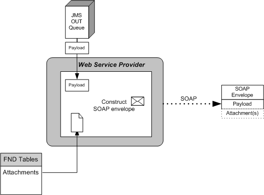

The following graphics display the construction for each protocol type:
For protocol types HTTP(S) and HTTP(S)-OXTA, the OTA servlet dequeues the message payload and constructs the OTA envelope.
For protocol type OTAH(S)-ATCH, the OTA servlet dequeues the message payload, constructs the OTA envelope, and assembles the attachment(s).
For protocol type HTTP(S)-ATCH, the OTA servlet dequeues the message payload and assembles any attachments, if present.
For protocol type SOAP, the Web Services provider dequeues the message payload, assembles any attachments, and constructs the SOAP envelope.
