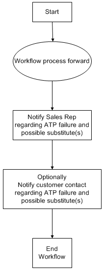

You must set profile MSC: Enable ATP Workflow to Yes if you want a notification to be sent to the appropriate people when an item substitution occurs during sales order scheduling.

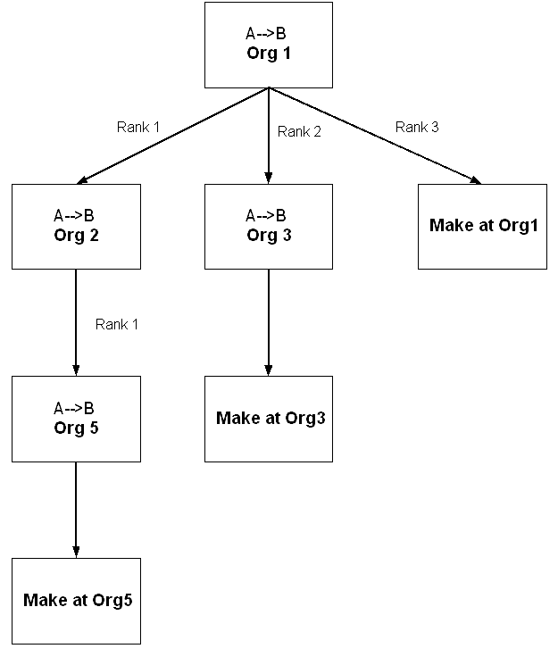

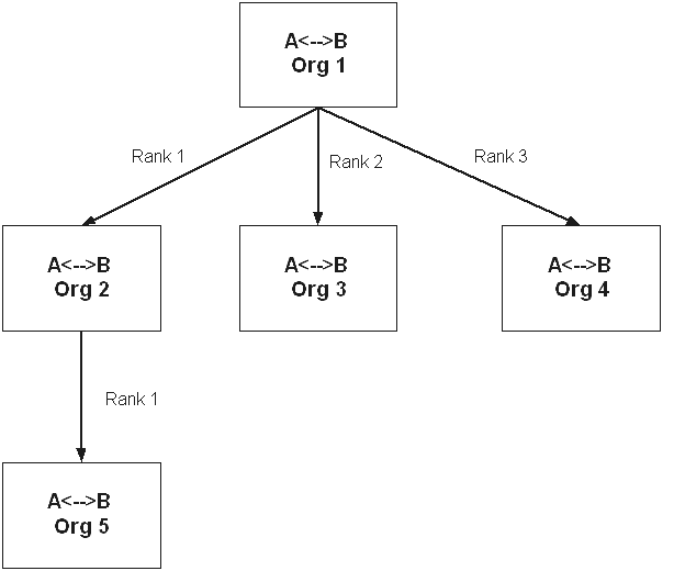

Oracle Global Order Promising uses a plan-level option selection to determine if breadth-first logic needs to be applied. The plan level option is the End Item Substitution check box on the Plan Options window. If you select this check box, you get the breadth-first logic for items that have end item substitutions defined.
The following diagram illustrates the breadth-first search concept. Items A and B are two substitute items and they are enabled in different organizations. The search for existing supply of a substitute proceeds breadth first, that is, Oracle Global Order Promising searches for Items A and B in Org 1, Org 2, Org 3, Org 4, and Org 5. If you have setup your substitution, ATP searches for each item individually. If Org 3 is set to Rank 1 and Org 2 to Rank 2, and then ATP follows this path: Org 1, Org 3, Org 2, Org 4, and Org 5 while evaluating existing on-hand and scheduled receipts for both native and substitute supplies across the supply chain.
Breadth-First Search Concept
The system assumes that both Items A and B have the same sourcing rule. If substitution needs to happen in all organizations and all organizations can swap materials freely, you can expect that substitute items are enabled in all relevant organizations and that sourcing rules exist for all substitute items to ship materials to all relevant organizations. If you do not establish sourcing rules, the substitution logic does not make any assumptions about sourcing rules.
Note: When end item substitution is not enabled, Oracle Global Order Promising performs a depth-first search. In the previous example, the order of this search would be:
Org 2 -> Org 5 -> Org 3 -> Org 4

Case 5
The following diagram shows the supply chain for item A and B:
Supply Chain for Item A and B

Allocated ATP In a Supply Chain
Consider a five organization supply chain setup:
Five-Organization Supply Chain

When the profile MSC: Enable ATP Workflow is set to Yes, a workflow notification is sent once the substitution occurs at the time of sales order scheduling. The following is a diagram depicting this workflow. The title for the workflow that is generated is Demand Satisfied Using End Item Substitution. This workflow is initiated upon scheduling of sales orders in Oracle Order Management.
Demand Satisfied Using End Item Substitution Workflow
The following details are shown in the workflow:
From Item: the item for which you received the demand; the exception is for this item.
Order Number: sales order number.
Line Number: sales order line number.
Original Quantity: requested quantity.
Substitute Item: the item to which the demand was transferred.
Organization: shipping organization.
Substituted Quantity: demand transferred quantity.

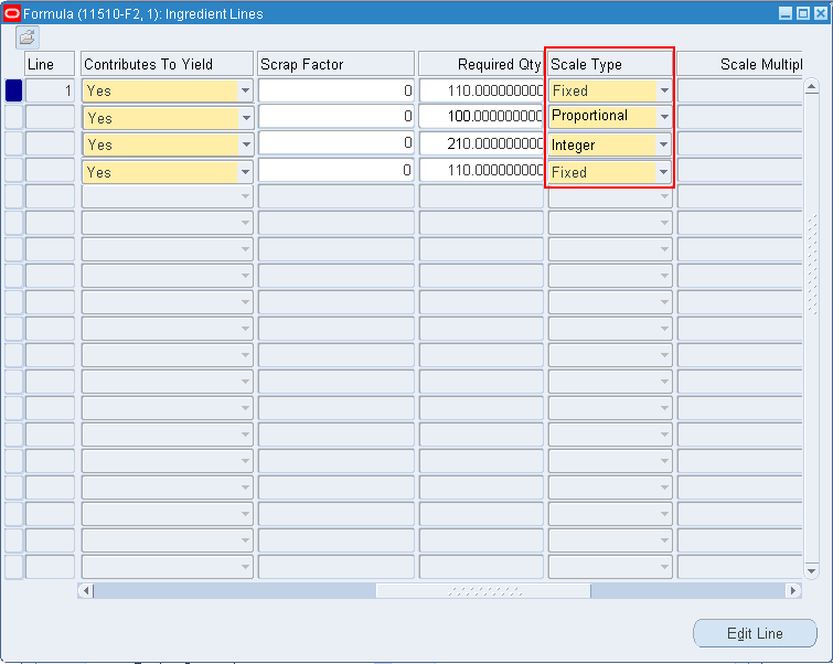

Material requirements typically scale proportionally in many manufacturing environments. For example, the number of hard disks required to build computers would scale proportionally to the requirements quantity. However, in certain scenarios you may want to include a certain component in fixed amount irrespective of the job quantity or yield. The support for lot-based material usage allows you to calculate material requirements based on materials used for a specific "lot" of end items or products.
Support for lot-based components allows the planner to calculate material requirements based on materials used per lot of the assembly. In a business environment, this is also referred to as requirement calculated on the basis of lot or batch. The following scenarios explain the concept in detail.
Assembly component is lot-based
In this scenario, you can include a fixed amount of material that will be used for the entire lot of the assembled products, irrespective of the size of the lot or batch. For example, you manufacture door panel assemblies, each of which consists of an injection molded panel and a lock. As part of the job start process, you will produce a fixed number of plastic door panels to cycle in the process so that you get the parameters set correctly. In such a scenario, you may want to include a certain weight of plastic resin that will be used in the job in the Bill of Materia,l irrespective of the job quantity.
Non-assembly component is lot-based
In this scenario you can include a fixed amount of material that will not be part of the yield, but will be used to initialize or activate the entire lot of end products, irrespective of the size of the lot or batch. For example, during the manufacture of DVDs, a test kit is issued to each job. The test kit contains a CD and instructions for initializing the process. A single test kit is used for the whole job.
All components in the assembly are lot-based
In this scenario, you can include a fixed amount or number of materials that can be used to test the effectiveness of the assembled lot or batch, irrespective of the size of the lot or batch. For example, during the manufacture of gas cylinders, your quality assurance procedures may require you to perform a destructive test on the first cylinder produced, regardless of the job quantity.
For a discrete manufacturing environment, the enhancement allows the planner to calculate the requirements for fixed amount of material used for a lot or batch of assembled products. For a process manufacturing environment, this enhancement allows the planner to calculate material requirements in a fixed amount or an amount expressed, expressed as an integer, for a lot or batch of assembled products. The following examples discuss lot-based material usage in discrete and process manufacturing environments.

Example: Process Manufacturing Environment Scenario

The following scaling types are used while calculating material requirements for a component in Oracle Process Manufacturing:
Fixed scaling: The material requirements for a component in an assembly do not change based on formula quantity or quantity requested. The component quantity used in the assembly remains the same, irrespective of the size of the lot or batch of finished products. For both discrete and process manufacturing environments, this scaling type enables lot-based material requirements.
Proportional scaling: The material requirements for a component in an assembly are measured in proportion to the formula quantity, the requested quantity, or they are based on the list of components required in the assembly. For both discrete and process manufacturing environments, this scaling type enables item-based material requirements.
Integer scaling: The material requirements for a component in an assembly are measured in integers and in multiples of integers. The user should specify the rounding direction and the rounding variance for integer scaling. Note that Oracle Global Order Promising does not support this scaling type.

Scaling type: In the Formula window for the Ingredient Lines, select the scaling type in the Scaling Type drop-down list.
Formula for Ingredient Lines Window

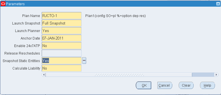

The Parameters window appears.
Parameters Window
Set Enable Continual ATP to Yes.
Click OK.

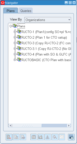

In the Navigator, select Supply Chain Planner > Workbench.
Navigator Window
The ATP plan is visible in the Planner Workbench only if the MSC: Action Allowed on ATP Continual Plan While Running profile option is set to Yes. If this profile option is set to No, the ATP plan appears in the View Plan window.

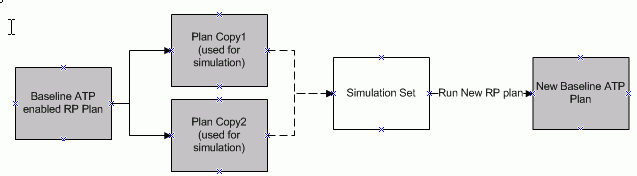

Meanwhile, what-if simulations cane carried out by multiple planners by taking individual copies of the baseline ATP enabled Rapid Planning plan. Using the write-out-to-simulation-set functionality, you can preserve any changes made during simulation to the simulation set.
The baseline plan can be run again by referring to the simulation set. All planner changes are incorporated in the newly run plan.

The integration workflow between Rapid Planning and GOP is illustrated in the following diagram:
