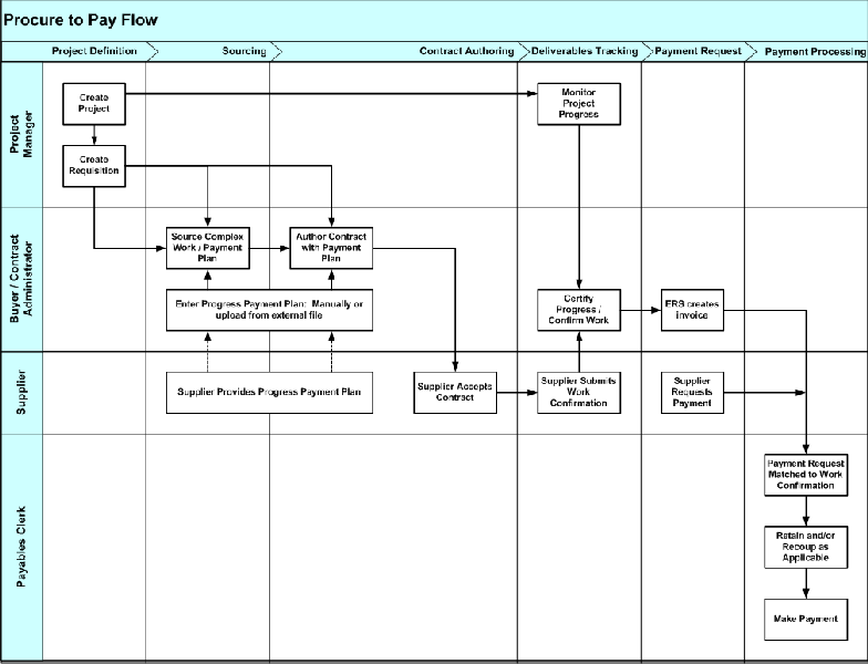

Since complex work procurement requires integration between several Oracle Applications it is beneficial to know the role that Oracle Purchasing takes in the process. The following diagram illustrates how the various roles and products intersect.
The role that Oracle Purchasing plays is primarily in the authoring and monitoring a portion of the flow.
