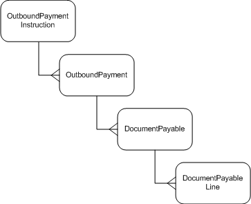

The disbursement payment instruction extract has a 4 level structure. Each level except the last containing one or more sub-levels.
The top level is the payment instruction level. One disbursement extract will have one and only payment instruction to be delivered to the payment system. The second level is the payment. It is called OutboundPayment to distinguish with funds capture payment orders. One payment must have one or more document payables. The third level is document payable. Each document payable contains multiple document lines, located at the forth level and equivalent to a line item of an invoice.
The table below is an example of an element definition table entitled BankAccount.
