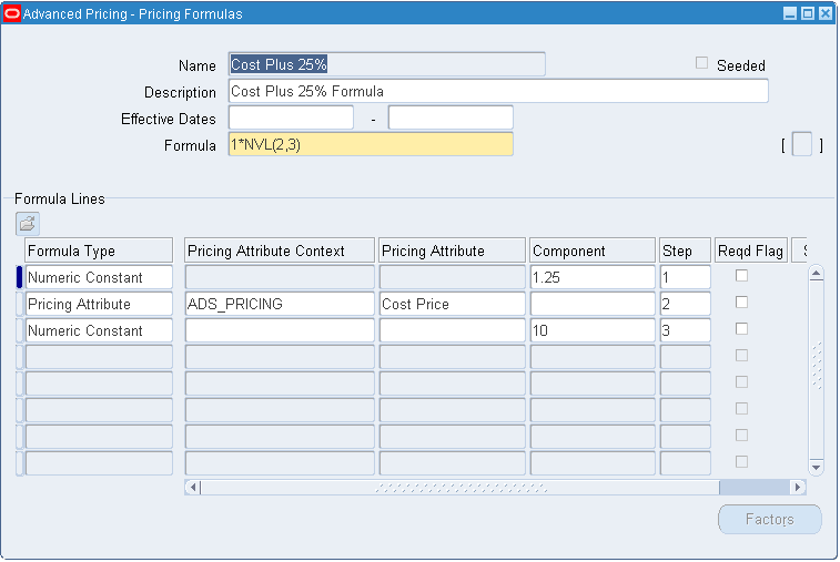

Create a formula to use the get_custom_price function.
The following image depicts the Pricing Formulas window:
Remember to note the formula_id by using Help, Examine. Use this formula ID in the get_custom_price function to identify the formula.
