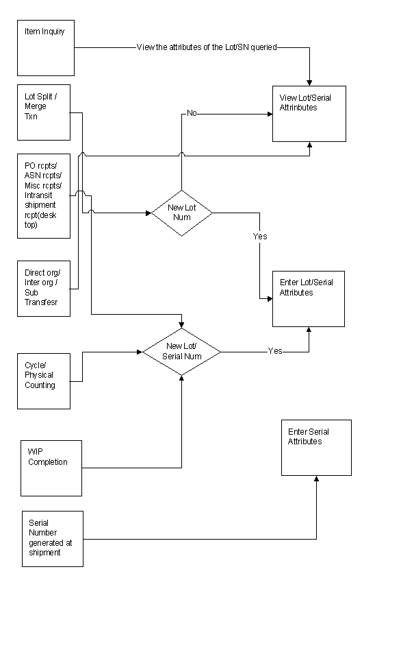

Lot and serial attributes need to be populated when new lots and serials are created. If desired, the attributes may be defaulted and/or overridden by the receiver. When you receive against an existing lot, you may view but not update the attributes of the existing lot. The attributes of the material received will be inherited from the attributes of the pre-existing lot.
Populating lot and serial attributes is supported for the following transactions for non-Oracle Warehouse Management inventory organizations:
Purchase order delivery
Miscellaneous receipt
WIP completion
Work-orderless completion
Flow schedule completion
Note: Populating lot attributes is only supported in the Lot Entry window of the Miscellaneous Transactions form. You may find it easier if you remove the lot field from the Miscellaneous Transaction Lines window using the folder form functionality.
Lot and serial attributes must be populated when new lots and serials are created. If desired, the attributes may be defaulted and overridden. When you receive against an existing lot, the attributes of the material received will be inherited from the attributes of the pre-existing lot.
Populating lot and serial attributes are supporting for the following transactions for non-Oracle Warehouse Management inventory organizations:
Receiving Delivery transactions
Cycle and Physical counting
Lot Split/Merge transactions
Miscellaneous Receipt
Populating lot and serial attributes are supported for the following transactions for Oracle Warehouse Management enabled inventory organizations:
Inbound receipt (including ASN receipt)
Cycle and physical counting
Lot Merge/Split transactions

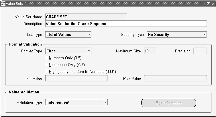

Value sets hold the actual values for a particular segment of a descriptive flexfield. Defining attribute value sets involves setting up the value set that is associated with a particular flexfield segment. For example, the following figures illustrates a value set for the Grade segment. In this case, the value set, Grade Set, includes three grades: Excellent, Average, and Poor.
Note: Before you define the value set for an attribute, you should determine its context requirements, including the types of values required for each of the context segment.
Navigate to the Value Set window.
Define the value sets for your lot or serial attribute segments. For instructions about how to define value sets, see the Oracle Flexfields User's Guide.

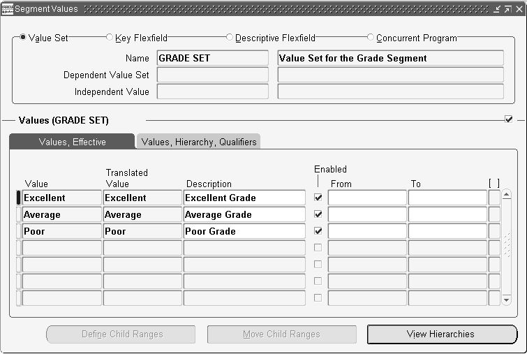

After you finish setting up the value set, navigate to the Values window and enter the actual values for the value set.

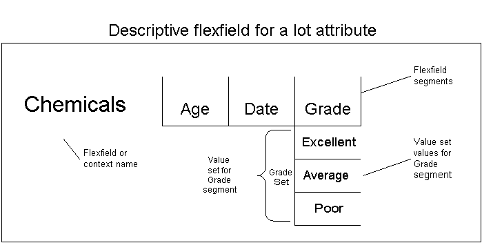

Setting up lot and serial descriptive flexfield contexts involves defining a context for each type of item that will track different groups of attributes. You should define different contexts to do the following:
Track different attributes for different types of items
Provide different default values for different types of items

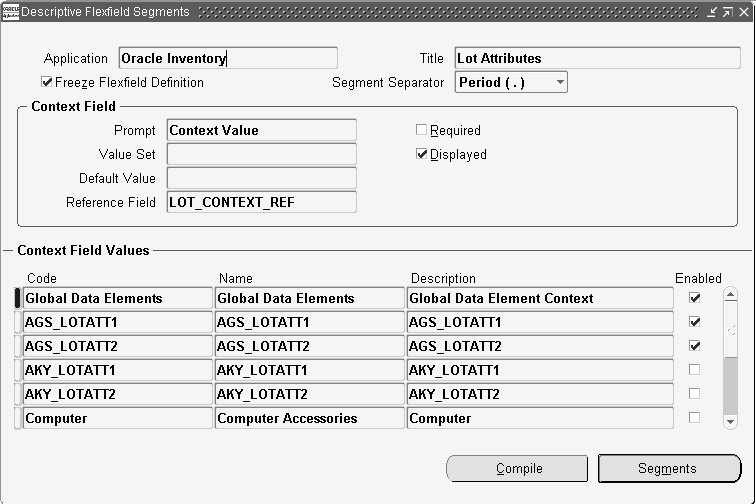

Navigate to the Descriptive Flexfields Segments.
In the Title field, query on Lot Attributes to display the context codes that currently exist for lot attributes.
Set up lot and serial descriptive flexfield contexts according to the instructions in the Oracle Flexfields User's Guide.

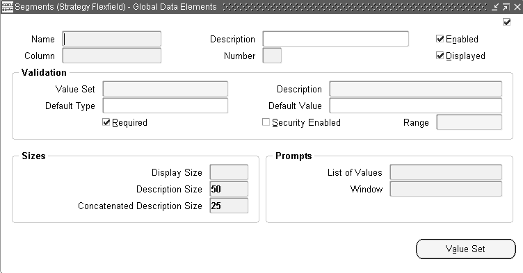

Navigate to the descriptive flexfields Segments window.
Enter segment information according to the instructions in the Oracle Flexfields User's Guide.

Should I default the context at the global or organization level?
Contexts may be assigned at the organization level when different organizations in the supply chain wish to track different information regarding a lot and/or serial. For example, a manufacturing plant may need to track more information about a lot and or serial than a sales office. On the other hand, inter-organization transfers of items with lot or serial attributes require that the same context assignments be defined in all the source and destination organization. To aid in this setup, the context mapping can be made common to all organizations. For example, material that is sent back from the sales office might lose the information originally gathered regarding the lot and this information would need to be reentered. In summary, the priority of these two requirements needs to be weighed to determine the optimal setup for your organization's supply chain.

I am getting an error while compiling Lot / Serial Attributes Descriptive I flexfield
If any of the segments, in any context associated with this descriptive flexfield (DFF) have a segment name that is an Oracle reserved word like varchar, number, date, or char, then concurrent request which will create a view for this descriptive flexfield (DFF) will fail. Please check to see non of the segments have Oracle reserved words as segment names.
The Lot or Serial attributes Mobile page gives an unexpected error.
Please check to see your Lot or Serial attributes descriptive flexfield definition is frozen.
