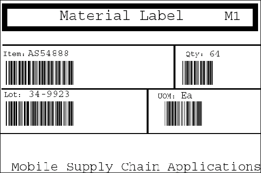

Consider the following setup as an example:
A Printer is created called Label Printer One with Printer Type of Label.
Label Printer One is assigned to the Label Type of Material at the Responsibility Level for materials Mgmt responsibility.
A Label Format called Material Format is created. This format contains the Item and Quantity fields, referenced by the variables ITEM and QTY, respectively.
The Material Label Type is assigned to the business Flow of receipt as the user level, for user RCV10.
According to this setup, when the RCV10 user logs in and performs a Receipt of material (such as a Purchase Order Receipt), an XML file with instructions to print a Material Label of format Material Format to printer label Printer One will be generated and deposited in the specified directory.
Material Label
