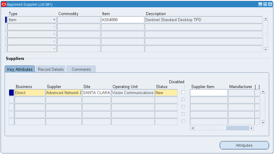

You can create consignment relationships with your supplier using the Approved Supplier List (ASL) window. Your purchasing suppliers are created in the Suppliers window, and they are associated with the items you buy using the Approved Supplier List window.
Approved Supplier List Window
A consignment relationship can be established for a combination of Item, Supplier, and Supplier Site.
Local and Global Approved Supplier Lists
Your approved supplier can be either a local or global supplier. A local ASL is used only in the organization in which it was defined. A global ASL may be used in all organizations you specify.

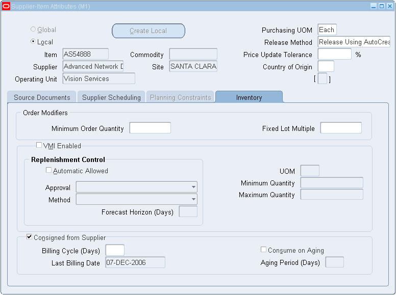

You can enable the Consigned Inventory from Supplier feature on the Supplier–Item Attributes window.
Inventory Tab
On the Inventory tab, you can enable consigned inventory, indicate Billing Cycle Days, and define the Aging parameters. The Consigned from Supplier feature can only be enabled under the following conditions:
Encumbrance is not enabled in the operating unit.
The ASL is being defined for a combination of Item, Supplier and Supplier Site.
The Item for which the ASL is being defined is not:
Outside Processing Item
Expense Item (Inventory Asset Value set to No)
ATO or PTO Model
EAM Asset Item
Non-transactable or Non-stockable item
The validation for local ASL is done for the organization in which the ASL is being created. For Global ASL, this validation is done for all organizations under the same set of books.
Billing Cycle (Days): Indicates how frequently you would like to group the consumption transactions into a consumption advice. Consumption advice is the document against which supplier can raise an invoice and gets paid for. The default is null. If the value is null, a consumption advice is created every time the Create Consumption Advice concurrent program is run.
Last Billing Cycle Date: This is set to the system date when you initially set up Consigned Inventory from Supplier. It is updated each time a new consumption advice is created as per the billing cycle for this ASL. Billing cycle and last billing date in conjunction control the frequency at which the consumption advice is created. A new consumption advice is created when the following occurs:
System date > Last Billing Date + Billing Cycle Days
Consume on Aging: In some consigned relationships, the supplier stipulates the maximum period for which he can make the material available at your site on consignment basis and you are required take ownership of any balance material after this period. If you are required to consume consigned material within such a stipulated time period, enable the Consume on Aging check box. Consigned Inventory Aging queries would report your commitments from such agreements. Selecting this option does not automatically transfer the ownership of the overdue consigned stocks; however, it enables you to use the Consigned Inventory Aging inquiries to identify the consigned stocks that are overdue for consumption.
Aging Period (Days): Indicates the maximum number of days the material may be kept in consigned status by your supplier.

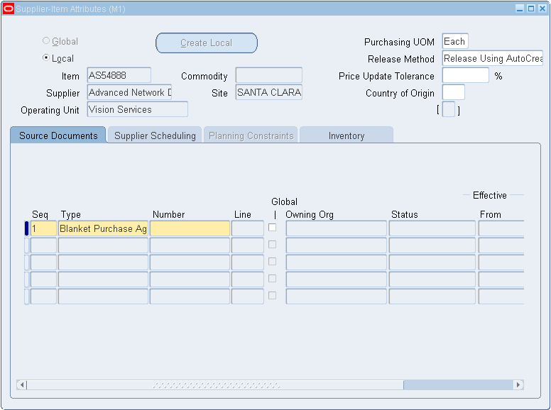

Source Documents Tab
On the Source Documents tab, you can associate specific quotations and blanket purchase orders agreements with the supplier and item combinations. This enables Purchasing to default source documents automatically. All consigned enabled suppliers must have a referenced blanket purchase agreement. However, only blanket purchase agreements may be used as source documents for consigned inventory. The blanket purchase agreement may be either local or global.
When the consigned material is consumed, the system refers to the source document to retrieve the price applicable for the consumption. You can assign a specific blanket purchase agreement here, or set the profile option PO: Automatic Document Sourcing to Yes. Setting this profile option to Yes automatically makes the pricing information default from the most recently created blanket agreement. If the profile is set to No, the approved supplier list (ASL) is used to determine the blanket agreement.

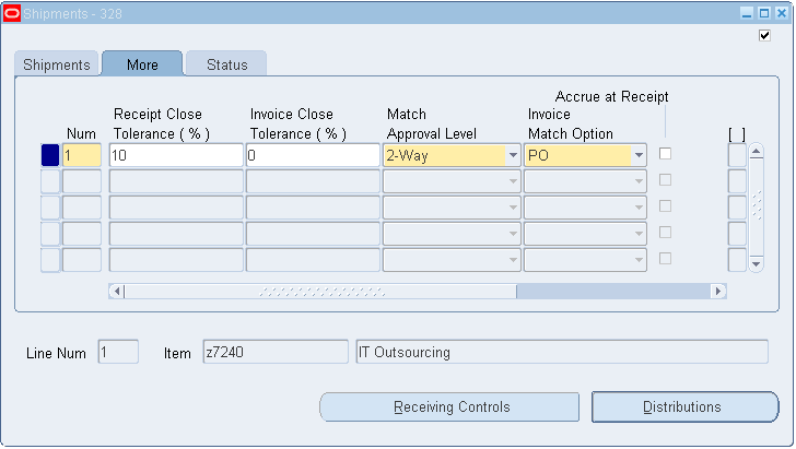

You can view the shipment line details in the Shipments window. Shipment lines for consigned material have the following attributes:
Invoice Close Tolerance value is 100 percent because the consigned shipment is not invoiced.
Match Approval Level value is 2 Way Matching, regardless of value entered on the Supplier window, because the consigned shipment is not invoiced.
Invoice Match Option value is PO Based Matching, regardless of value entered on the Supplier window, because the shipment is not matched against an accounts payable invoice.
Accrue on Receipt is disabled because financial liability is deferred until ownership is transferred to your organization.
Consigned check box is enabled.
Status values is Close for Invoicing.
The Destination Type for all consigned shipment distributions is always set to Inventory.

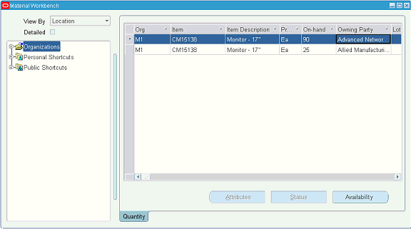

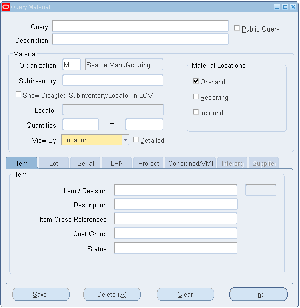

You can query and review Consigned and VMI on hand quantities using the Material Workbench. Consigned and VMI stocks are identified by the owning party and planning party attributes on the on hand quantities. Select the Consigned/VMI Tab on the Material Workbench to search for inventory that is designated for Consigned or VMI. The Owning Party region is used to enter the search criteria, and can be limited to All Owning Parties, All Consigned Stock, or you can Select Owning Party. Use the Planning Party region to enter the search criteria and select either All Planning Parties, All VMI Stock, or Select Planning Party.
Query Material Window
The search results display in the Material Workbench window.
Material Workbench Window
Note: Note that the concatenation of Supplier and Supplier site is shown as the owning party for the consigned on hand quantities.
