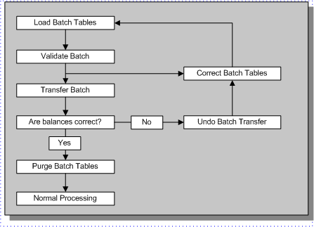

There are three basic steps involved in loading initial balance values:
Define an element and input value to feed each specific balance
Set up the initial balance values in the tables
PAY_BALANCE_BATCH_HEADERS
PAY_BALANCE_BATCH_LINES
Run the Initial Balance Upload process
Use the SRS window.
Use Validate, Transfer, Undo and Purge modes as needed.

The normal sequence for using these modes to load initial balances is shown in the following diagram:
Process Flow
