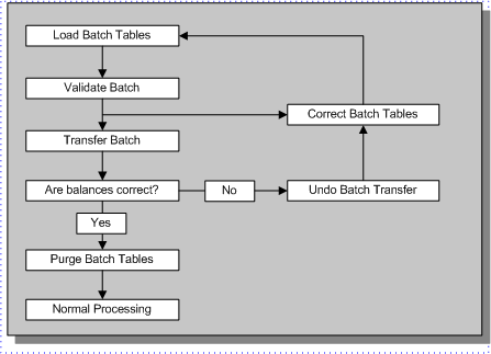

There are three basic steps involved in loading initial balance values:
Define an element and input value to feed each specific balance
Set up the initial balance values in the tables
PAY_BALANCE_BATCH_HEADERS
PAY_BALANCE_BATCH_LINES
Run the Initial Balance Upload process
Use the SRS window.
Use Validate, Transfer, Undo and Purge modes as needed.

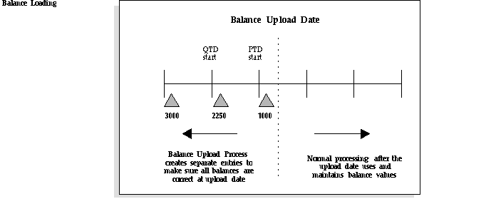

When you run the initial balance loading process you set values for each balance relative to a specific date - the Upload Date. The process creates run results, to ensure your legislative balances are correct from the upload date. Maintenance of balance information after this date is managed by the system, or by using the balance adjustments.
The upload date represents the effective date of the initial balance load. For example, you run the first payroll on 01-March, with wages of 5,000 and taxes of 1,000. The salary PTD, MTD, QTD and YTD are all 5,000. The taxes PTD, MTD, QTD, and YTD are all 1,000. If you require YTD balances for Jan and Feb, run the balance initialization for a date other than 01-March. If you want values of PTD = 0, MTD = 0, YTD 200 on 01-March, you need to run the Initial Balance Upload with a date of 28- February or 01-February, and with a dimension of YTD, and a value of 200. At 01-March the values are PTD = 0, MTD = 0, YTD 200.
Consider the following example of three dimensions for gross pay balance values for one employee.
Gross Pay Ptd 1000.00
Gross Pay Qtd 3250.00
Gross Pay Ytd 6250.00
The balance loading process must calculate the actual values required for each entry and the effective date for these entries. The result of the calculation is the creation of 3 balance entries.
_PTD balance entry value is 1000.00
_QTD balance entry value is 2250.00
_YTD balance entry value is 3000.00
The result is that the cumulative values of the individual entries match the initial requirement for each balance.
Gross Pay Ptd = 1000.00
Gross Pay Qtd = 1000.00 + 2250.00 = 3250.00
Gross Pay Ytd = 1000.00 + 2250.00 + 3000.00 = 6250.00

The process calculates the balance adjustment entries required for each assignment. This list is checked and aggregated where values are shared and actual entries are then created for the assignment. This is repeated for each assignment in the batch. Successful transfer is marked with a status of T - Transferred.
Note: If any line for an assignment is in error, none of the lines for the assignment are transferred into the HRMS database. Failures are logged in the messages table against the batch line being processed and the batch line is marked as I - Invalid.
If the value of the adjustment is zero then no entry is created. For example:
Balance_PTD = 500
Balance_QTD = 500
There is no need for an adjustment to the QTD dimension since the value is already set by the PTD.

The normal sequence for using these modes to load initial balances is shown in the following diagram:
Process Flow
