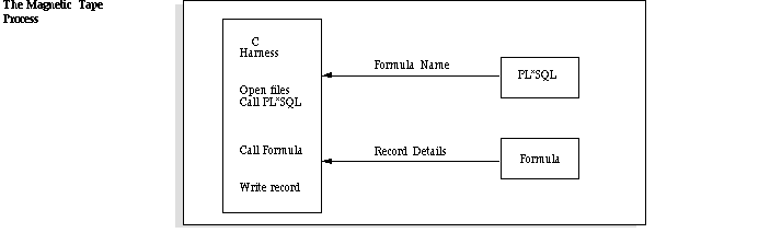

The following figure illustrates the Magnetic Tape process.

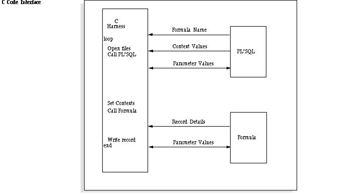

A C code harness performs the file handling (opening, closing and writing to files), and enables the PL/SQL and the formulas to interface.
The driving PL/SQL code sequences records by returning the name of a formula.
Each formula writes one type of record, such as the Tape Header, to tape. It defines the contents of the record.
The process of getting the formula and record name, then writing the record to tape is repeated until all the records are processed.
The driving PL/SQL determines which type of record is required at any stage of the processing, and uses context and parameter values to communicate with the formula.
The following figure illustrates how the C code acts as an interface between the PL/SQL and formula, and how the data is passed as context values.

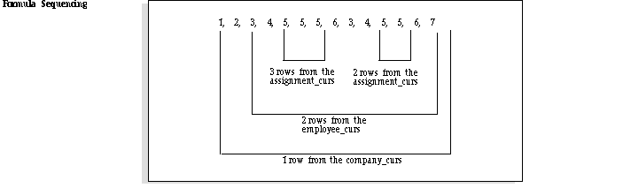

Using the above specification the formulas could be retrieved in the following sequence:
The generic PL/SQL procedure identifies which type of report to process. It does this by passing the parameter MAGTAPE_REPORT_ID when calling the process. The previous figure illustrates how MAGTAPE_REPORT_ID=CA is passed when calling the process.

A PL/SQL stored procedure provides the main control flow and determines the order in which the formulas are called.
The routine uses FastFormula to prepare records The records are written to an ASCII file in preparation for transfer to magnetic tape. To implement the required actions, there are more formula result rule types. These are listed below:
| Result Rule Types | Purpose |
| TRANSFER | This transfers the output parameter to the input of the stored procedure. The parameter may or may not be modified by the stored procedure before being used in the next execution of the formula. |
| WRITE TO TAPE | This instructs the process to write the result to the magnetic tape file. This is always a character string that represents the desired record. The writes are performed in the order in which they are returned from the formula. |
| REPORT FILE | This writes the string result to an "audit" file. |
| ERROR | This instructs the process that an ERROR/WARNING has been detected within the formula. Thus the process should handle the error appropriately. |
These are not implemented in the traditional manner using the formula result rules table. They use the naming convention:
WRITE TO TAPE results are named WRITE_<result_name>.
TRANSFER results follow a similar convention, but the result_name part must be the name of the parameter. For example, a result company_total_income would be named transfer_company_total_income.
The REPORT result must identify which file is to be written to. The file number is embedded in the formula return name For example: REPORT1_<result_name> - this writes to report/audit file 1.
Reports can be written during the production of the magnetic tape file. These reports could be used to check the details that are produced. A number of reports can be created in the same run. The number can be limited by using the ADD_MAG_REP_FILES action parameter in the PAY_ACTION_PARAMETERS table.
Each report is accessed by using a prefix that denotes the file, for example, REPORT1_ to denote report number 1, REPORT2_to denote report number 2, and so on. If a report number is outside the range of the ADD_MAG_REP_FILES value, an invalid return error is reported. The report files are opened as and when needed with the names of the files previously described.

create or replace package body pytstm1
as
CURSOR get_assignments( p_payroll_action_id NUMBER)
IS
SELECT ppp.org_payment_method_id,ppp.personal_payment_method_id,
ppp.value, paa.assignment_id
FROM pay_assignment_actions paa, pay_pre_payments ppp
WHERE paa.payroll_action_id = p_payroll_action_id
AND ppp.pre_payment_id = paa.pre_payment_id
ORDER BY ppp.org_payment_method_id;
Also need to:
Test that the assignment are date effective?
Order by name or person_number or other ?
p_business_grp NUMBER;
PROCEDURE new_formula
IS
p_payroll_action_id NUMBER;
assignment NUMBER;
p_org_payment_method_id NUMBER;
p_personal_payment_method_id NUMBER;
p_value NUMBER;
FUNCTION get_formula_id ( p_formula_name IN VARCHAR2)
RETURN NUMBER IS
p_formula_id NUMBER;
BEGIN
SELECT formula_id
INTO p_formula_id
FROM ff_formulas_f
WHERE formula_name = p_formula_name
AND (business_group_id = p_business_grp
OR (business_group_id IS NULL
AND legislation_code = 'GB')
OR (business_group_id IS NULL AND legislation_code IS NULL)
-- RETURN p_formula_id;
END get_formula_id;
BEGIN
pay_mag_tape.internal_prm_names(1) :=
'NO_OF_PARAMETERS'; -- Reserved positions
pay_mag_tape.internal_prm_names(2) := 'NEW_FORMULA_ID';-- --
Number of parameters may be greater than 2 because formulas
may be -- keeping running totals.--
pay_mag_tape.internal_cxt_names(1) := 'Number_of_contexts';
pay_mag_tape.internal_cxt_values(1) := 1; --
Initial value---- IF NOT get_assignments%ISOPEN THEN
-- New file-- pay_mag_tape.internal_prm_values(1) := 2;
pay_mag_tape.internal_prm_values(2) := get_formula_id
('REPORT_HEADER_1');-- if
pay_mag_tape.internal_prm_names(3) = 'PAYROLL_ACTION_ID'
then p_payroll_action_id :=
to_number(pay_mag_tape.internal_prm_values(3)); end if;--
OPEN get_assignments (p_payroll_action_id);-- ELSE----
FETCH get_assignments INTO
p_org_payment_method_id,
p_personal_payment_method_id, p_value,
assignment;-- IF get_assignments%FOUND THEN
-- New company
pay_mag_tape.internal_cxt_names(2) := 'ASSIGNMENT_ID';
pay_mag_tape.internal_cxt_values(2) := assignment;
pay_mag_tape.internal_cxt_names(3) := 'DATE_EARNED';
pay_mag_tape.internal_cxt_values(3) := to_char (sysdate,'DD-MON-YYYY');
pay_mag_tape.internal_cxt_values(1) := 3;
('ENTRY _DETAIL');
ELSE-- pay_mag_tape.internal_prm_values(1) := 2;
('REPORT_CONTROL_1');
CLOSE get_assignments;
-- END IF;
--END IF;--
END new_formula;

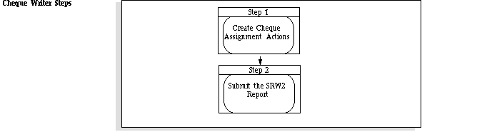

You run the Cheque Writer process to produce cheque payments for unpaid pre-payment actions. Before you run the process, you need to set up certain things, for example, the SRW2 report and the 'order by' option to sequence cheques (if required).
You run Cheque Writer through Standard Reports Submission (SRS). Unlike the Magnetic Tape process, you can have multiple threads in Cheque Writer.
The Cheque Writer process has two distinct steps:
Cheque Writer creates cheque assignment actions for each of the target pre-payments, subject to the restrictions of the parameters specified. The target pre-payments must be unpaid-that is, never been paid-or if they have been paid, then voided.
Cheque Writer creates assignment actions in two stages:
Multiple threads insert ranges of assignment actions, which interlock back to previous actions.
This happens in the same way as Pre-Payments and Magnetic Tape create assignment actions.
See: The Process (Pre-Payments)
A single thread runs through all the assignment actions in a specific order to update the chunk and cheque number.
The order is specified by a PL/SQL procedure that you can customize. The thread divides the assignment actions equally into chunks, one chunk per thread. It assigns each action a cheque number.
At this stage, the status of the assignment actions is 'Unprocessed'.
Note: Cheque Writer creates an assignment action and cheque for each target pre-payment of the assignment. Consequently, a single Cheque Writer run can produce more than one cheque for a single assignment.
When Cheque Writer has created the assignment actions and interlocks, each thread submits the specified SRW2 report as a synchronously spawned concurrent process. The reports produce files in a specific cheque format.
If the spawned concurrent process is successful, the status of the assignment actions is changed to 'Complete'. If the process fails, the status of the assignment actions is changed to 'In Error'. So, if you resubmit Cheque Writer, it can start at the point of submitting the report.
In this respect, Cheque Writer is similar to the magnetic tape process: the whole process must be successful before the payroll action is Complete. But, while the Magnetic Tape process can mark individual assignment actions In Error, Cheque Writer marks all assignment actions In Error.
