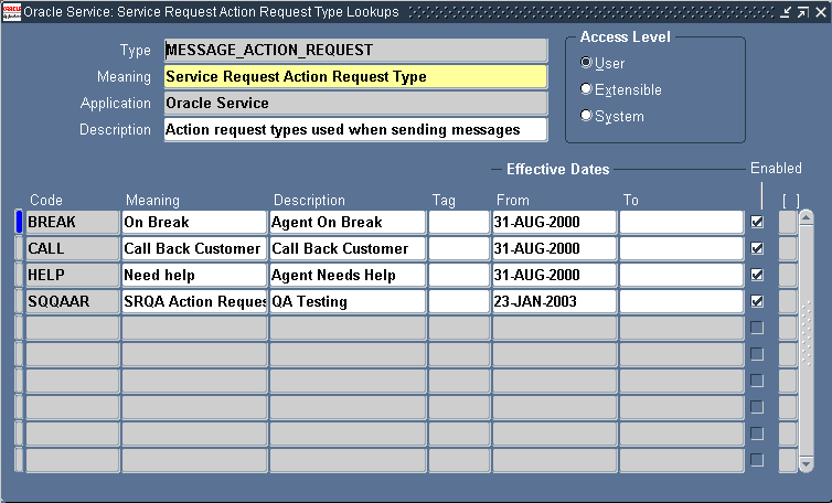

To setup a message action code
Under the Service responsibility, navigate to the Setup, Definitions, Action Request Types.
The Oracle Service: Service Request Action Request Type Lookups window appears. The lookup type for the actions is "MESSAGE_ACTION_REQUEST".
Enter a message action code in the Code field.
Enter a brief description of the code in the Meaning field.
Enter a full description of the code in the Description field.
Enter the effective dates in the From and To fields.
Select the Enabled check box to make the code available for use.
Save the message action request code.
