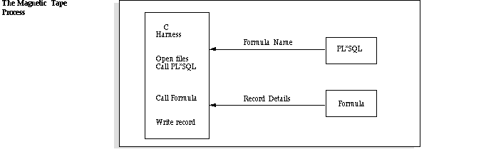

The following figure illustrates the Magnetic Tape process.

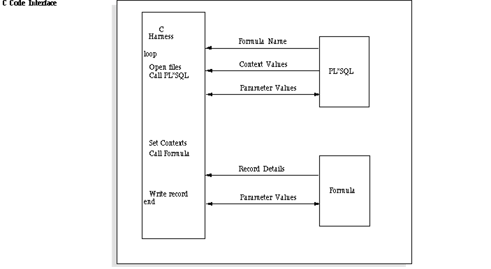

A C code harness performs the file handling (opening, closing and writing to files), and enables the PL/SQL and the formulas to interface.
The driving PL/SQL code sequences records by returning the name of a formula.
Each formula writes one type of record, such as the Tape Header, to tape. It defines the contents of the record.
The process of getting the formula and record name, then writing the record to tape is repeated until all the records are processed.
The driving PL/SQL determines which type of record is required at any stage of the processing, and uses context and parameter values to communicate with the formula.
The following figure illustrates how the C code acts as an interface between the PL/SQL and formula, and how the data is passed as context values.
Formulas use database items to reference variable values. For example, the employee and assignment number could be different for each run of the formula and record.
The database item is held within the database, which consists of components to make up a SQL statement. As the value could be different for each run of the formula, the 'where' clause of the statement is slightly different. This is done by substituting key values into the 'where' clause that uniquely select the required value. These substitution values are known as context values.
Context values are set by the driving PL/SQL procedure that places the values into a PL/SQL table. The PL/SQL table is passed back to the C code, which in turn places it in the formula structure.
Parameter values are used to store the variable data to be transferred between the formula and the PL/SQL. For example, the running totals are passed to the formula in this way.
The parameters can be:
Passed into the C process from the command line
Created by the driving PL/SQL procedure
Created by the formula
Only the driving PL/SQL procedure and the formula can update the values.

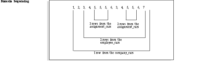

| formula_name | block_id | seq | next_block | frequency | O/F | exec.last |
| formula 1 | 1 | 1 | - | - | N | N |
| formula 2 | 1 | 2 | 2 | - | N | N |
| formula 3 | 2 | 1 | - | - | N | N |
| formula 4 | 2 | 2 | 3 | - | N | N |
| formula 5 | 3 | 1 | - | - | N | N |
| formula 6 | 2 | 3 | - | - | N | N |
| formula 7 | 1 | 3 | - | - | N | N |
Formulas/records can be of three general types:
Standard formulas executed for every row returned from cursor
Intermediate formulas executed once every x number of rows
Formula executed depending on the result of the previous formula (overflow formula)
The table columns are as follows:
Block id refers to the block that this formula is part of.
Seq refers to the sequence in the block.
Next_block column signifies that after this formula has run, the cursor defined by next_block should be opened and that block's formula should be run until there are no more rows for that cursor.
Frequency is used by the intermediate formula to specify the number of rows to be skipped before the formula is run.
O/F (overflow) specifies whether the formula is an overflow. If it is (set to Y), and if the last formula returned the TRANSFER_RUN_OVERFLOW flag set to Y, then the formula runs.
Similarly, if the formula is a Repeated overflow (set to R), and the TRANSFER_RUN_OVERFLOW flag is set to Y then that formula is continually repeated until the formula does not return TRANSFER_RUN_OVERFLOW set to Y.
Exec.last can apply to all the types of formula but most commonly the intermediate formulas. This column specifies that the formula can run one extra time after the last row has been retrieved from the cursor.
For intermediate formula this column can be set to 4 different values:
N - Never run after last row returned
A - Always run after last row returned
R - Run only if the intermediate formula has run for this cursor
F - Run only if this is the first run of the formula for this cursor
Note: For overflow and standard formula only N and A are valid.
Using the above specification the formulas could be retrieved in the following sequence:

A PL/SQL stored procedure provides the main control flow and determines the order in which the formulas are called.
The routine uses FastFormula to prepare records The records are written to an ASCII file in preparation for transfer to magnetic tape. To implement the required actions, there are more formula result rule types. These are listed below:
