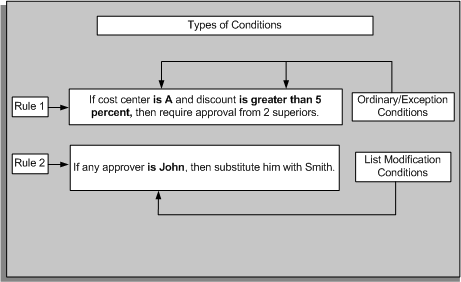

The if part of an approval rule consists of zero or more conditions. A condition is a statement that is either true or false, for a given transaction. For the rule to apply to a transaction, all of its conditions must be true for the transaction. The following graphic illustrates the conditions in rules and indicates the types of conditions:

A list-modification condition checks for the presence of a given target approver at a specific set of allowed locations in the default approver list. When the target approver is present in an allowed location, we say that the default approver list satisfies the condition.
There are two types of allowed location. When the condition specifies that the target approver must be the final approver, the target approver must be the last approver in a chain of authority. When the condition specifies that the target approver may be any approver, whether the approver must be in a chain of authority depends on the action type used by the rule that contains the list-modification condition. Action types for list-modification rules limit their scope to chains of authority. Substitution rules using an any-approver list-modification condition apply to all occurrences of the target approver throughout an approver list.
