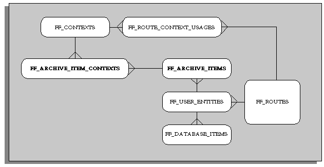

For its archiving function, PAR uses both live database items (which point at live tables), and archive database items (which point at the archive tables to retrieve archived data). For each archive database item, there must be a corresponding live database item. You are responsible for creating the archive database items, and for any live database items you need that do not already exist.
For example, for the archive database item A_INCOME_TAX_YTD referenced in a formula, there must be a live database item INCOME_TAX_YTD. PAR runs this live database item and places the value in the archive table FF_ARCHIVE_ITEMS.
The entity relationship diagram below shows the relationship of the PAR tables to other tables in generic HRMS:
The FF_ARCHIVE_ITEMS table records a snapshot of what particular database items evaluate to on a run of PAR.
The creation of archive database items includes the creation of archive routes. You define these in FF_ROUTES, with definition texts that are simple select statements from the two tables FF_ARCHIVE_ITEM_CONTEXTS and FF_ARCHIVE_ITEMS. Notice however that you must define these based on the number of contexts being passed into the routes, and the data type of the contexts. There are however, seeded Archive Routes, which you may be able to make use of rather than defining your own; these are detailed in the next section.
You define the route context usages in the table FF_ROUTE_CONTEXT_USAGES. The recommended way to do this is to retrieve from FF_CONTEXTS the context IDs that the live and archive routes require, and then define new route context usages based on the new archive routes. The route parameter is always defined based on the new archive route and a parameter name of User Entity ID.
