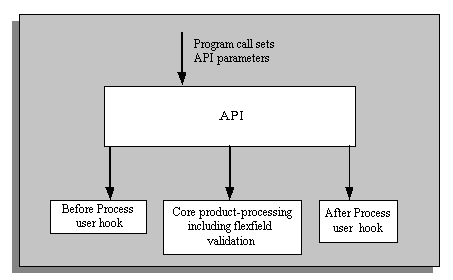

Using API User Hooks to Set Business Group ID
the picture is described in the document text
Define a Before Process user hook call to set the PER_BUSINESS_GROUP_ID profile. Where the API user hook provides a mandatory p_business_group_id parameter, the profile can be set directly from this parameter value. Otherwise first derive the business_group_id value from the database tables using the API's mandatory primary key parameter value.
The PER_BUSINESS_GROUP_ID profile must only be populated when it is undefined or set to zero. If the profile is defined with a non-zero value then it should not be changed. This is to ensure there is no impact on the Professional UI and Self Service HR.
The Before Process user hook package should also remember when it has actually set the PER_BUSINESS_GROUP_ID profile. This can be done with a package global variable.
The second part of the solution is to define an After Process user hook to reset the PER_BUSINESS_GROUP_ID profile back to its original zero or null value. This is only necessary when the Before Process actually changed the value. This is to ensure the profile will be populated with the correct value when the API is called a second time.
