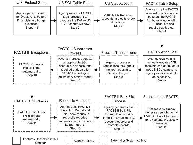

The figure lists the steps of the FACTS II process.
FACTS II Process Steps Diagram
The FACTS II process consists of these steps.
