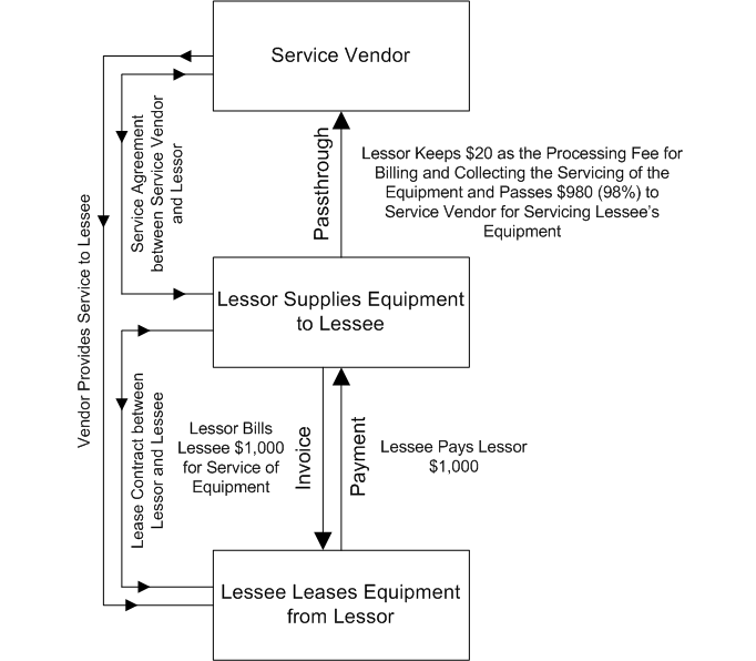

A passthrough is a portion of a payment received by a lessor from a lessee that is paid to a vendor. The payment that the lessor makes to the vendor is known as a passthrough.
Automatic passthroughs can be configured on a service or on a fee during the base period and/or the evergreen period and must always include the provision of a service to the lessee by the service vendor.
The figure below illustrates a passthrough configured on a service. The service vendor provides the lessor with photocopiers. The lessor leases the photocopiers to lessees, who are corporate customers. In this scenario, the lessor has a lease contract with the lessee, which includes the provision of maintenance service on a photocopier. Additionally, a service agreement exists between the service vendor and the lessor, such that the service vendor provides maintenance service on the customer's photocopier. Every month, the lessor bills the lessee $1,000 for the maintenance service provided by the service vendor on the photocopier. The customer pays the invoice and the lessor receives $1,000. Because a service agreement exists between the service vendor and the lessor, whereby the service vendor services the photocopier, the lessor, in turn, retains $20 as the processing fee for billing and collecting payment from the lessee and passes on the service portion of the receipt to the service vendor, which represents the passthrough amount of $980 (98%).
In some cases, the service vendor may indemnify the lessor against any loss incurred on the disposal of the asset. In these cases, the service vendor is entitled to all or a portion of the rent recovered during the evergreen period. This is also configured using passthrough functionality.
Example of a Passthrough Configured on a Service
The following table describes the passthrough business process in Leasing and Finance Management.
