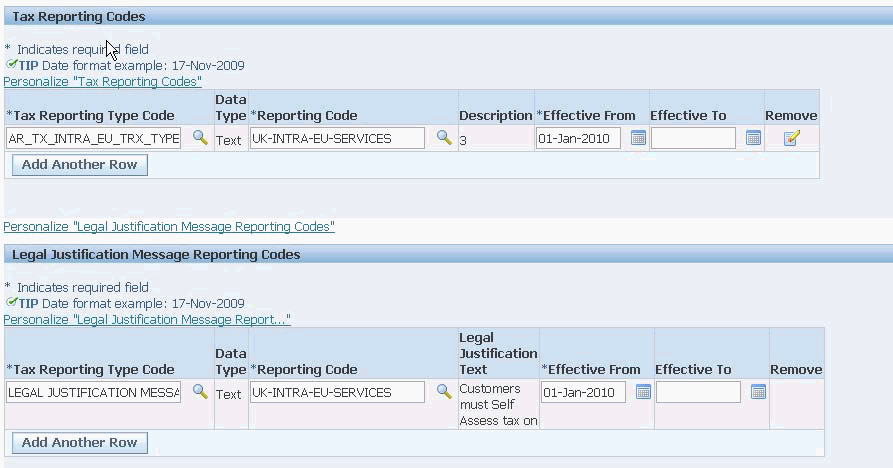

Associate Intra EU Transaction Type and Legal Justification Reporting Codes to Tax Rate Code
(N) > Tax Configuration > Tax Rates.
Enter the appropriate regime, configuration owner, tax and status information.
Specify tax rate code and percentage rate as zero (existing/upgraded tax rate code can also be updated).
(N) Rate Details > Tax Reporting Codes > Specify the Tax Reporting Type Code and Reporting Codes created for Intra EU Transaction Type in the preceding example (UK-INTRA-EU-SERVICES).
(N) Rate Details > Legal Justification Message Reporting Codes > Specify the Legal Justification Reporting Type Code and Reporting Codes created in preceding example ((UK-INTRA-EU-SERVICES).
Only one effective legal justification reporting type can be associated to a tax rate.

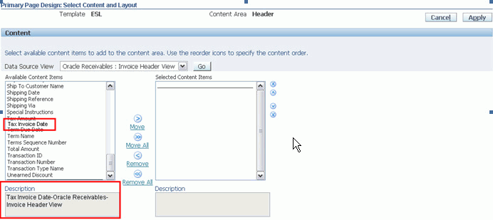

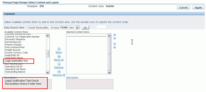

The appropriate legal message and tax date must be printed on Intra EU services (B2B) transactions Receivables invoice. The seller (in United Kingdom) must create a new template or modify the existing template in BPA as follows.
Steps for Creating Templates to print Country Specific Legal Messages and Tax Invoice Date on Receivables Invoice:
(N) Bill Presentment Architecture > Template Management > Create a new template that contains the following content (existing/upgrade template can also be modified):
Tax invoice date at the header region.
Legal message at the footer region (and if required on the lines).
