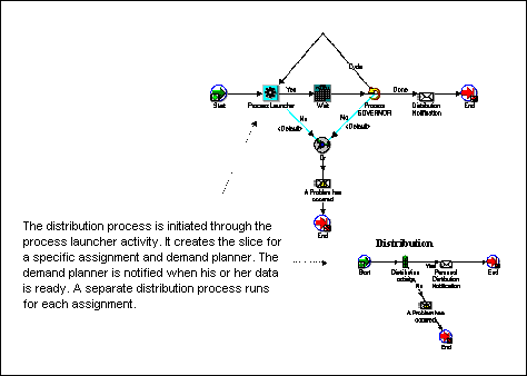

Stage 3 Workflow process: Distribute to planners
During this stage Workflow interacts with the OLAPI Server to:
  1. Find all assignments defined for planners.
  2. Build and distribute a personal slice of data for each user having a demand planner assignment.
  3. Start a separate Workflow process to build each assignment and notify that user when their personal database is ready.
  4. Notify the planning administrator of the outcome of the task when all assignments are built.
The following illustration shows the Workflow process that runs to complete the Stage 3 task.
the picture is described in the document text

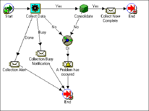

Collect Available Submissions Now
Collect Available Submissions Now is used to do an early collection of available submissions during the standard cycle. It is independent of the standard collection (the competitive nature of the two processes is managed by the system).
If you apply the Collect Available Submissions option, the following tasks are accomplished:
  1. The Workflow process Collect Submission Now runs. This will not cycle. It will just look for any submitted assignments for that plan, collect and consolidate them, and then end. It will notify the administrator of the outcome.
  2. The status for collected assignments will be set to collected and this process will then end.
The following illustration shows the Workflow process that runs when you choose Collect Available Submissions Now.

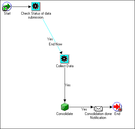

In the first scenario all data is submitted before the collection process is initiated. The Workflow status activity detects this and transitions to data collection and consolidation. No wait is involved. Immediately after the consolidation, a notification is sent indicating success.
The following illustration details the flow of activities when data is submitted before the collection process is initiated.

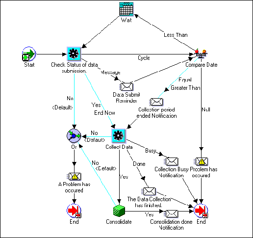

In the second scenario, not all data has been submitted when the Collect Data process is initiated. In this case, the Workflow process transitions through its activities to the Compare Date activity. If the end date for the collection period has not been reached, Workflow moves on to the Wait activity, where it pauses for the duration of the waiting period. It then moves on to the next activity, which checks the status of submitted data to verify whether all demand planners have submitted their data. If they have all submitted data, then the first scenario above will be followed. Otherwise, the flow will cycle.
Workflow will cycle through this set of activities until all demand planners have submitted their data, or until the data collection period end date is reached. When the data collection period end date is reached (whether all data has been submitted or not), Workflow sends a special notification to the Demand Planning System Administrator, and Workflow control is passed to the collection and consolidation activities.
The following illustration details the flow of activities when not all data has been submitted before the collection process is initiated.

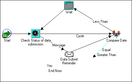

The third scenario functions similarly to the second, but includes an additional Workflow activity which sends a reminder to demand planners who have not submitted their data for collection.
The Demand Plan Administration page enables you to specify the number of days prior to the data collection end date when Workflow will begin to send reminder messages, once per day, to demand planners who have not yet submitted their data.
The following illustration details the flow of activities when not all data is submitted before the collection process is initiated and reminder messages are sent to planners.

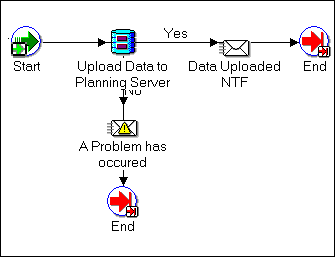

Stage 5 Workflow process: Uploading measures to the Planning Server
In this final stage, the final forecast is published back to the Demand Planning Server.
When this process is complete, Workflow notifies the Demand Planning System Administrator that the demand planning cycle has been completed.
The following illustration shows the flow of Workflow activities.
