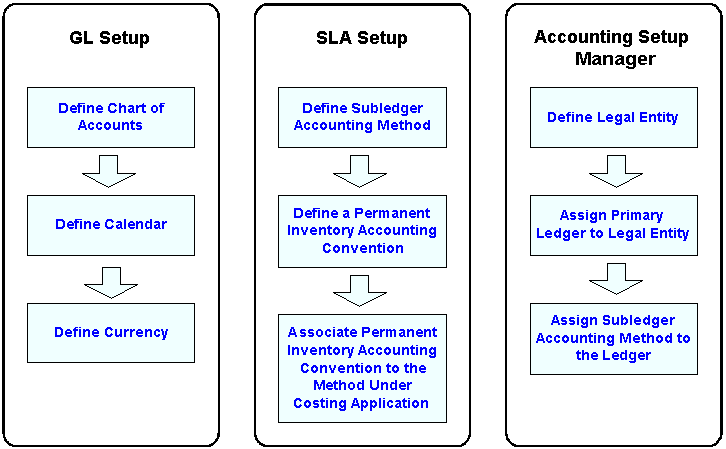

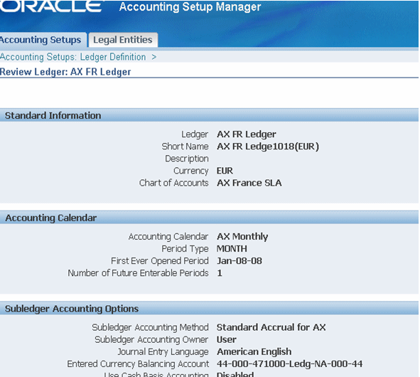

This section describes the setup required for AX support in Subledger Accounting (SLA).
To set up the Subledger Accounting Method:
Navigate to the Subledger Accounting Methods window. In the Find Subledger Accounting Methods window, click the New button to create a new method, or enter search criteria to view existing subledger accounting methods.
Click New to create a Subledger Accounting Method for the Costing application.
Save your work.

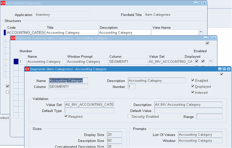

To set up the Item Category flexfield structure:
Navigate to the Key Flexfield Segments window.
Enter Accounting (Item) Category details.
Save your work.

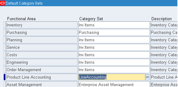

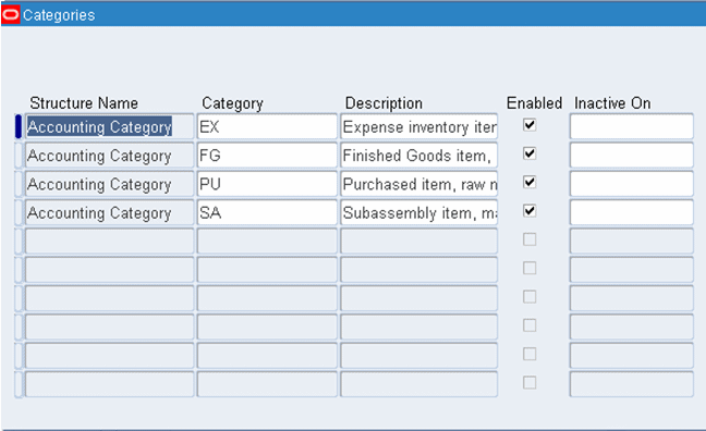

To set up the Product Line Category:
From the Inventory responsibility, navigate to the Categories window.
Create a Category Code.

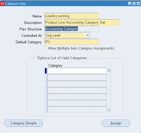

Create a Category Set.
Assign a Product Line Accounting functional area category set.
Save your work.

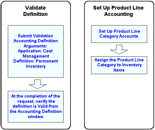

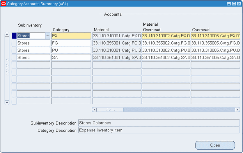

To set up Category Accounts:
Navigate to the Category Accounts window.
Enter Category Account details.
Save your work.

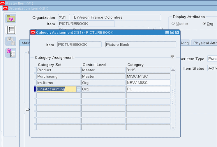

To assign the Product Line Category to items:
Navigate to the Organization Item window.
Select an Item from the Find Organization Items window..
From the Tools menu, choose Categories. The Category Assignment window appears.
Enter the Category Set, Control Level, and Category.
Save your work.
