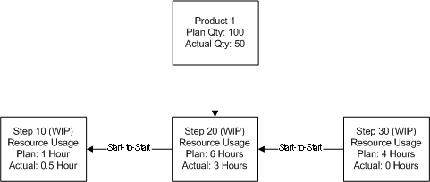

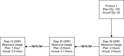

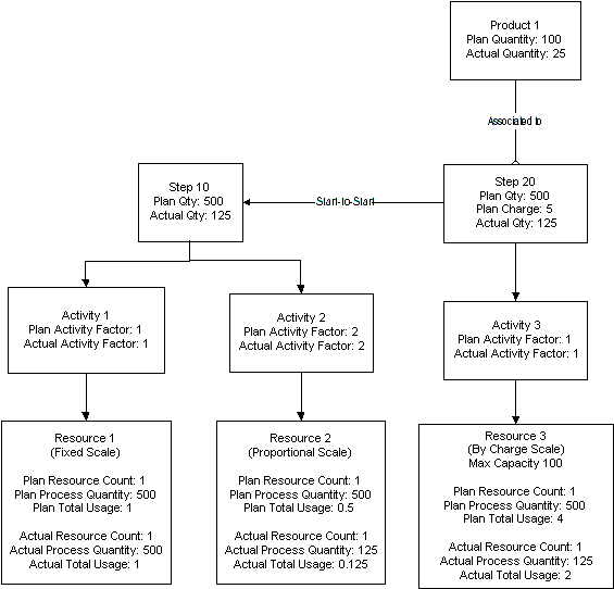

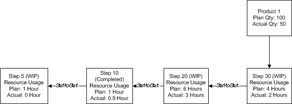

Resource usage can be calculated for a step in work in process status and driven by ingredient consumption when the Automatic Step Quantity Calculation (ASQC) option is selected, and the Calculate Interim Resource Usage parameter is set to Yes. You can calculate resource usage for an associated step and the resource usage for prior dependent steps. Refer to "Using the Calculate Interim Resource Usage Parameter" for more information on this parameter.
To backflush resource usage based on product yield, use the incremental backflushing functionality without ASQC selected, and the Backflush Resource Usage parameter set to Yes. Performing an incremental backflush on a product that is associated to a step records the resource usage proportionally when this parameter is set to Yes.
If the dependency is start-to-start, then the ratio calculated from incremental backflush is applied to the step, and to the resource. If the dependency is finish-to-start, then the step is considered complete, and the usage and quantities are calculated at 100 percent of the plan. If a preceding dependent step is completed, then it remains unchanged.

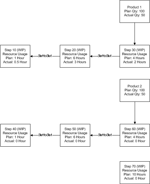

If the product is set to the incremental or manual yield type and the yield was not completely recorded using incremental backflushing, then when the batch is completed, these materials display in the Material Exceptions window. You can record the remaining yield. Because this is a manual process and not done through incremental backflushing, the resource usage is not backflushed.
Only the step associated to the product that incremental backflushing is initiated from and all its dependent preceding steps have the usage backflushed.
If the product that incremental backflushing is initiated from is not associated to a step, then a resource usage is not backflushed.
ASQC must be set to Off. The Calculate Step Quantities indicator on the recipe header must be deselected.
If an associated step or any dependent step is not completed, then the usage is not backflushed. This extends to completed batches where it is possible to initiate incremental backflushing for materials, but does not affect the resource usages.
To use incremental backflushing on the product, it is a requirement that the yield type of the product must be Manual or Incremental.
Product 1 is associated to step 30, has a plan quantity of 100, and 50 are produced. An incremental backflush is performed on Product 1. All step resources are calculated at 50 percent.

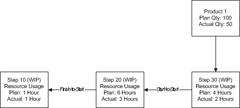

Following is a table of the step dependencies, plan resource usage, and actual resource usage:
| Step and Status | Dependency | Dependent on Step | Plan | Actual |
| Step 10 WIP | n/a | n/a | 1 hour | 0.5 hour |
| Step 20 WIP | Start-to-Start | 10 | 6 hours | 3 hours |
| Step 30 WIP | Start-to-Start | 20 | 4 hours | 2 hours |
Following is an illustration of the previously tabulated WIP step dependencies, plan resource usage, and actual resource usage:

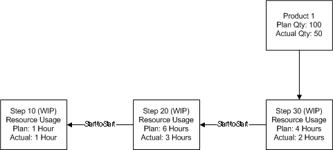

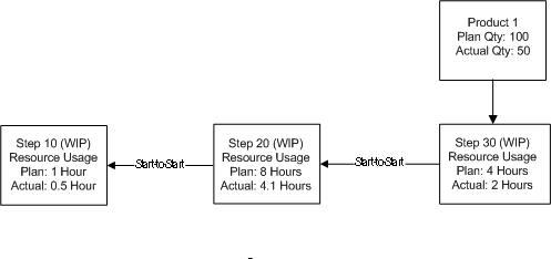

| Step 10 WIP | n/a | n/a | 1 hour | 1 hour |
| Step 20 WIP | Finish-to-Start | 10 | 6 hours | 3 hours |
The usage for Step 10 is calculated at 100 percent for the first incremental backflush, and remains unchanged for subsequent incremental backflushing. This is because, based on the finish-to-start dependency between steps 20 and step 10, it is assumed that as step 20 has started, step 10 must be finished and its resources have therefore run for their entire planned usage.
| Step 5 WIP | n/a | n/a | 1 hour | 0 hour |
| Step 10 Complete | Start-to-Start | 5 | 1 hour | 0.9 hour |
Step 10 is complete. The usage remains unchanged for Step 10 each time incremental backflushing is initiated on Product 1. This example also shows a start-to-start dependency from Step 10 to Step 5. Step 5 shows no usage calculation because when a completed step is encountered, the usage backflushing does not continue.
Following is an illustration of the previously tabulated step dependencies, plan resource usage, and actual resource usage:
Product 1 is associated to step 30, has a plan quantity of 100, and 125 are produced.
| Step 10 Completed | n/a | n/a | 1 hour | 1 hour |
| Step 20 Completed | Start-to-Start | 10 | 6 hours | 6 hours |
| Step 30 Completed | Start-to-Start | 20 | 4 hours | 4 hours |

Product 1 is an incremental type product associated to step 30, has a plan quantity of 100, and 50 are produced. Product 2 is associated to step 60, has a plan quantity of 100, and 50 are produced. Step 70 is not associated to a material.
Following are tables of the step dependencies, plan resource usage, and actual resource usage:
| Step 40 WIP | n/a | n/a | 1 hour | 0 hour |
| Step 50 WIP | Start-to-Start | 40 | 6 hours | 0 hour |
| Step 60 WIP | Start-to-Start | 50 | 4 hours | 0 hour |
| Step 70 WIP | Start-to-Start | n/a | 10 hours | 0 hour |
If you initiate an incremental backflush on Product 1 for 50 percent of plan, then material incremental backflushing calculates an actual quantity of 50 for both products. Resource usage backflushing is done for Steps 30, 20, and 10. Steps 60, 50, and 40 remain unchanged because they are associated to Product 2. Product 2 is not the product that incremental backflushing was initiated from. Step 70 remains unchanged because it is not associated to either.
In this scenario, make both products manual yield. This lets you initiate an incremental backflush on Product 1 and the usage for its associated step and dependent steps is calculated, but Product 2 and its associated and dependent steps remain unchanged. When backflushing is initiated from Product 2, Product 1 and its steps remain unchanged.

Product 1 is associated to step 20, has a plan quantity of 100, and 50 are produced. Step 30 is dependent on step 20.
Following are steps, statuses, step dependencies, and plan and actual resources:
| Step 30 WIP | Start-to-Start | 20 | 4 hours | 0 hours |
An incremental backflush is performed on Product 1. Usage is not calculated for step 30.

Product 1 is associated to step 20, has a plan quantity of 100, and 25 are produced.
The batch is released.
Step 10 is released:
Activity 1 has a Plan Activity Factor of 1 and an Actual Activity Factor of 1.
Activity 2 has a Plan Activity Factor of 2 and an Actual Activity Factor of 2.
Step 20 is released:
Activity 3 has a Plan Activity Factor of 1 and an Actual Activity Factor of 1.
Initiate an incremental backflush on Product 1. Specify a new actual quantity of 25.
| Resource | Scale Type | Plan | Actual |
| 1 | Fixed | Resource Count: 1 Process Quantity: 500 Total Usage: 1 | Resource Count: 1 Process Quantity: 500 Total Usage: 1 |
| 2 | Proportional | Resource Count: 1 Process Quantity: 500 Total Usage: 0.5 | Resource Count: 1 Process Quantity: 125 Total Usage: 0.125 |
| 3 | By Charge | Resource Count: 1 Process Quantity: 500 Total Usage: 4 | Resource Count: 1 Process Quantity: 125 Total Usage: 2 |
The actual total usage for Resource 3 is based on 2 charges because the step quantity is greater than the quantity for 1 charge. This causes the usage to be rounded up to the next charge of 2.
Product 1 has a plan quantity of 100, and 50 are produced. This example shows an initial incremental backflush initiated on Product 1 for 50 percent of plan with a subsequent manual addition of a 0.1 hour resource transaction for step 20.
| Step 20 WIP | Start-to-Start | 10 | 8 hours | 4.1 hours |
If an additional incremental backflush of 25 is performed for Product 1, then the actual usage for Step 20 retains the 0.1 hour resource transaction, and the resource usage backflush adds a resource transaction for 25 percent of the plan usage, which is calculated as 2 hours:
