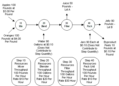

If the batch has multiple steps with step dependencies and the ingredients or products have different unit of measures that belong to different unit of measure types, then enable the Automatic Step Quantity Calculation option.
Enable Automatic Step Quantity Calculation
If the batch has multiple steps with step dependencies and the ingredients or products have different unit of measures that belong to different unit of measure types, then enable the Automatic Step Quantity Calculation option. The Automatic Step Quantity Calculation ensures that all material lines are associated to one or more steps and conversions between the items and the various step quantity unit of measures are available.
If the Automatic Step Quantity Calculation is not enabled, then associate all material lines with one or more steps for accurate cost determination.
If one or more ingredients are not associated to step, then those ingredients are added at the first step. If one or more products or byproducts are not associated to any step, then those items are considered yielded at the last step.
If there is no material-step association, then all ingredients are added at the first step and all products or byproducts are considered yielded at the last step.

This example shows batch cost calculation in lot costing. The following diagram illustrates that the ingredient lines of apples and oranges are associated to the step 10, water is associated to Step 20, juice to Step 30, and jelly and peels are associated to Step 40.
In this example as shown in the diagram, apples, oranges, waters, and jars are used to produce juice and jelly. The byproduct is peels.
Set up these associations in the Batch Step/Batch Item Association window. The step sequence or dependency is set up in the Batch Step Dependencies window.
The step dependency and step or material association are used to decide the step sequence.
Then, the total cost of ingredients and resources used at each step is calculated. The costs are accumulated at each step in succession. Resource usages and step quantities are taken from the OPM Process Execution tables.
If a product yields at any step, then the step quantity and the yield quantity are used to arrive at the proportion of costs accumulated so far to be applied to the product yield. This is used to calculate the unit cost of the lots yielded at that step.
The rest of the accumulated cost is carried over to the next step, and so on. At the last step, any remaining accumulated costs are applied to products that are yielded at that step.
To determine accurately how much of material is processed at each step, it is recommended that you use the Calculate Step Quantity option when creating batches. If this option is not used, then enter the actual step quantities processed at each step. If the actual step quantity is not recorded properly, then the costs calculated may not be accurate.
Using the above logic, the costs are calculated as follows:
Costs accumulated at Step 10:
Equals 100 pounds of apples at $3.00 per pound + 100 pounds of oranges at $4.00 per pound + Mixing Cost.
Step Quantity for Step 10 = 200 pounds
Mixer usage = (200 pounds / 100 pounds per hour) = 2 hours which is 2* $10.00 per hour = $20
Step 10 Costs = $300 + $400 + $20 = $720.
Costs accumulated at Step 20:
When the Calculate Step Quantity option is used, OPM Process Execution uses the unit of measure conversion for apples and oranges between pound and gallon to maintain the step quantities for all steps in both mass and volume units.
$720 from Step 10 + 90 gallons water at 0.10 per gallon + Blending Cost
Step Quantity for Step 20 = 200 pounds = 100 gallons (assume a conversion rate of 1 gallon to 2 pounds of apples and oranges)
Blending Cost = (100 gallons / 100 gallons per hour) = 1 hour which is 1* $20.00 per hour = $20
Step 20 Costs = $720 + $9 + $20 = $749
Costs accumulated at Step 30:
Equals $749 from Step 20 + Filtration Cost
Step Quantity for Step 30 = 200 pounds = 100 gallons
Filtration Cost = (100 gallons / 100 gallons per hour) = 1 hour which is 1 * $30.00 per hour = $30
Step 30 Costs = $749 + $30 = $779
50 gallons of juice, Lot A, is yielded at Step 30. The proportion of costs removed by juice is calculated as follows:
The 50 gallons of juice is in the same unit of measure as the step quantity unit of measure. No unit of measure conversion is required.
The cost of juice is calculated as:
[50 gallons / Total Step Quantity] * Total Costs accumulated
which is, 50 / 100 * $779 = $389.5
The unit cost of juice, Lot A, is $389.5/50 equals $7.79 per gallon.
The remaining cost, $389.5, is carried over to Step 40.
Cost accumulated at Step 40:
Equals $389.5 from Step 30 + 90 jars at $0.10 per each + Packing costs - 10 pound peels at $0.10 per pound
Step Quantity for Step 40 = 50 gallons = 100 pounds
Packing Cost = (100 pounds / 100 pounds per hour) = 0.1 hour which is 0.1 * $10.00 per hour = $10.00.
Step 40 Costs = $389.5 + $9 + $10 - $1 = $407.5
The unit cost of jelly, Lot B, is $407.5/90 equals $4.528 per pound
If the Calculate Step Quantity option is not used, then the Lot Cost process performs the unit of measure conversions between various ingredients and products to calculate the step quantities. If any of the unit of measure conversion is not set up, then an error displays and the batch is not costed.
