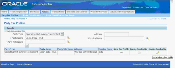

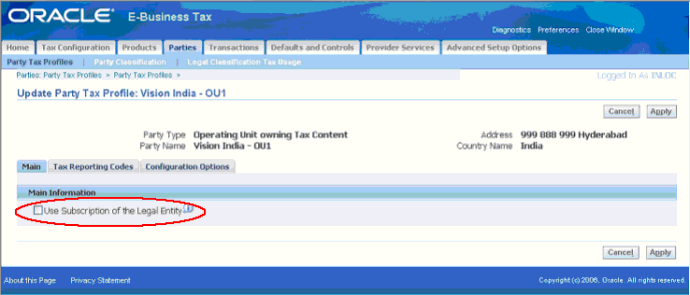

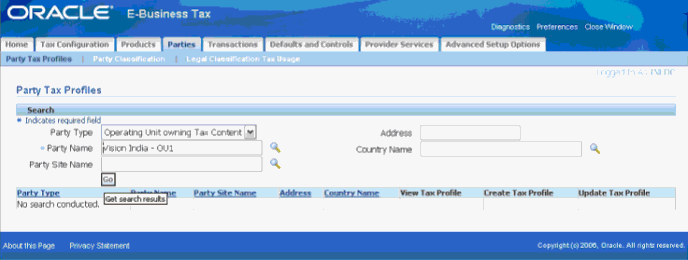

Step 1: Define “Party Tax Profiles”
Search for Operating Unit using the “Party Tax Profiles” page.
Navigation : Tax Manager – Parties – Party Tax Profiles – Parties Tab
Click on “Update Party Tax Profile” button.
The following Flag should not be checked.
Important: Please note that “Use subscription of the Legal Entity” check box must not be checked.
You will not be able to use India Localization if this flag is checked.

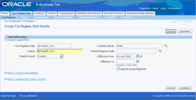

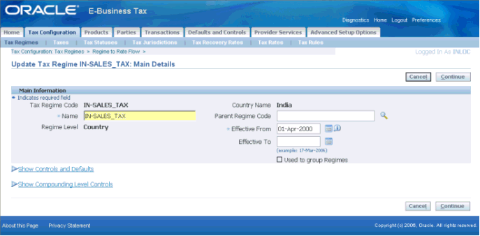

Step 2: Define Regime
Navigation : Tax Manager – Parties – Party Tax Profiles – Tax Configuration Tab
Following regime should be defined with exact values as shown below:
Following data should be entered while defining the tax regime:
Tax Regime CodeIN-SALES_TAX
NameIN-SALES_TAX
Regime Level: Country
Country Name : India
Effective Date : current date

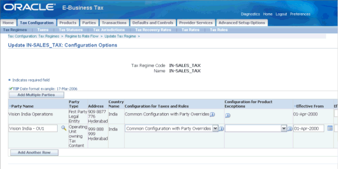

Set “Configuration Options” as follows:
You need to set value for “Configuration for Taxes and Rules” as “Common Configuration with Party Overrides”
This setup needs to be carried out for once at the Legal Entity level and also for EACH Operating Unit in which you wish to use Oracle Financials for India.

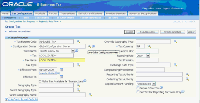

Step 3: Create Tax
Create a Tax with following values:
Configuration OwnerGlobal Configuration Owner and Operating Unit *
Tax SourceCreate a new tax
TaxLOCALIZATION
Tax NameLOCALIZATION
Effective Fromcurrent date
Tax CurrencyINR
Rounding RuleDown
Applied Amount HandlingRecalculated
* This setup needs to be carried out for once at the Legal Entity level and also for EACH Operating Unit in which you wish to use Oracle Financials for India.

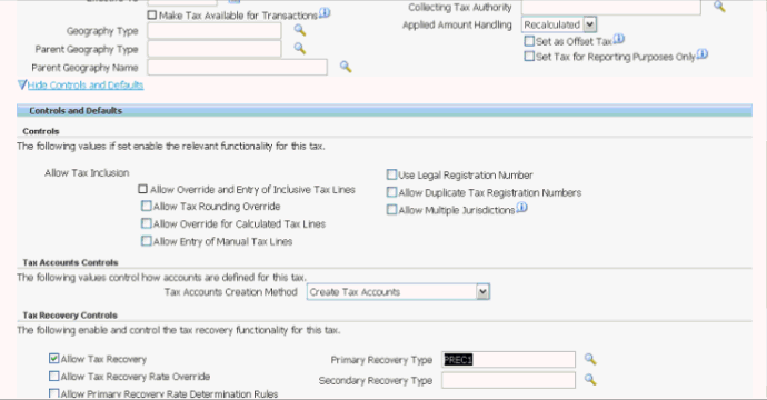

Please enter values for “Tax Recovery Controls” as follows:
Allow Tax Recovery check box should be checked and “Primary Recovery Type” should be PREC1.

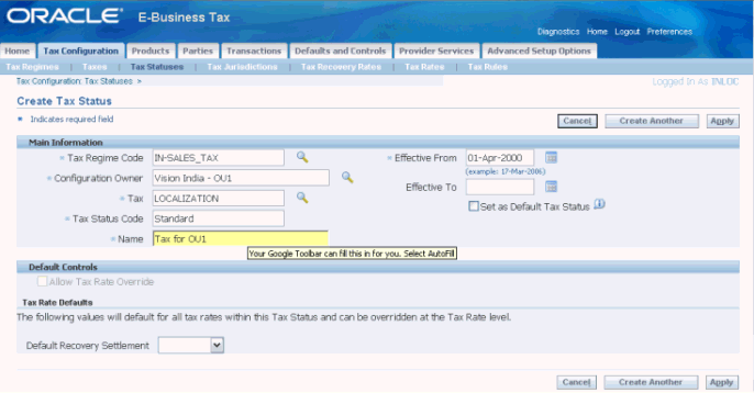

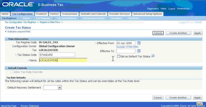

Step 4: Create Tax Status
Create Tax Status with following values:
Tax Status CodeSTANDARD
NameLOCALIZATION
Effective From current date
This setup needs to be carried out for once at the Legal Entity level and also forEACH Operating Unit in which you wish to use Oracle Financials for India.

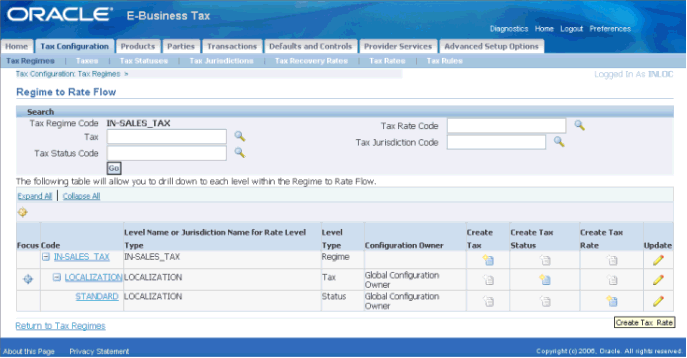

Review your work in the Regime to Rate flow

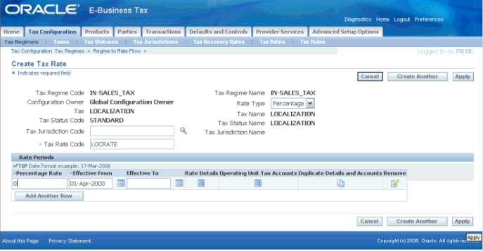

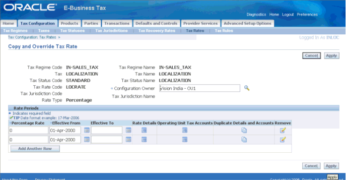

Step 5: Create Tax Rate
Create Tax Rate with following values:
Tax Rate Code LOCRATE
Rate Type Percentage
Percentage Rate 0
This setup needs to be carried out for once at the Legal Entity level and also for EACH Operating Unit in which you wish to use Oracle Financials for India (for the purpose of creating tax rate at Operating Unit level you can use the ‘copy’ feature).

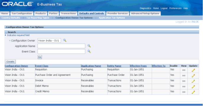

Step 6: Update Tax Configuration Options
Review Configuration Owner Tax Options, ensure they are as following:
Navigation : Tax Manager – Parties – Party Tax Profiles – Defaults and Controls Tab
