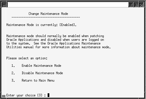

| ENABLE_MAINT_MODE | Enable Maintenance Mode |
| DISABLE_MAINT_MODE | Disable Maintenance Mode |

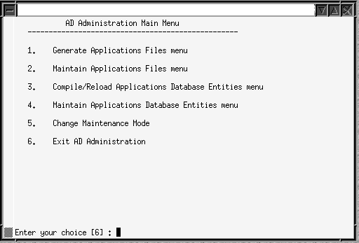

You start AD Administration from the command line. However, all maintenance tasks are initiated from the AD Administration Main Menu. This section describes some of the common features used to run this utility.
After you start AD Administration and respond to the prompts, the AD Administration Main Menu appears.
This menu displays the submenus where the individual maintenance tasks are grouped. To choose a submenu, type the number of the menu at the prompt. To exit AD Administration, press [Return].
Depending on your system configuration, the submenus for AD Administration may show slightly different option names and numbers from the ones displayed here.

Supply the information requested by the AD Administration prompts. The basic AD command line prompts are described in Chapter 1. Prompts that are unique to options are described in this chapter in the section that describes the option.
When you complete the prompts, the Main Menu appears.
Choose maintenance tasks.
On the Main Menu, choose a submenu. The submenus and the options they display are described fully beginning with Generate Applications Files in the next section.
Exit AD Administration.
You can exit AD Administration from the Main Menu by choosing option 6 (Exit AD Administration) at the screen prompt. You can also choose to exit the utility at any prompt by typing abort on the command line. See Restart Files in Chapter 1 for information about restarting AD utilities after using the abort command.

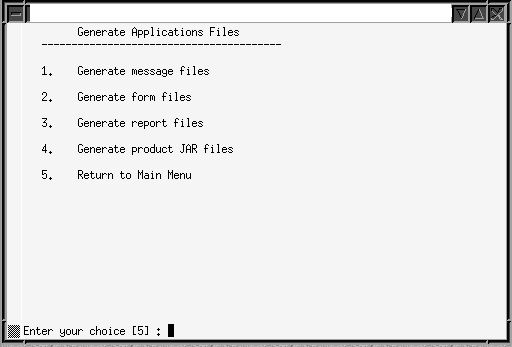

You may need to generate Applications files from time to time during your Applications life cycle. You access the associated tasks from the Generate Applications Files menu.
Generate Applications Files Menu
If system users are having difficulty accessing messages, forms, or reports, you may be able to resolve the issue by generating the associated files. Or, when you apply a patch that adds or changes product functionality, you may want to generate the associated files after you apply the patch, instead of running the generate driver during the patching downtime. The Generate Files tasks may be performed on any server, as required.
You do not have to shut down your system to generate files. However, users that access the files being generated (for example, for Human Resources forms) must log off.
Note: For more information, see Generating Product Files in Oracle E-Business Suite Maintenance Procedures.

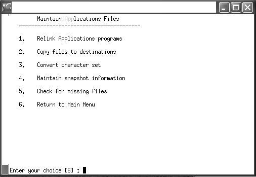

Certain maintenance tasks are required to keep your Applications files up to date. For example, you may need to copy product files to a central location or convert files in the APPL_TOP to another character set. These tasks are grouped on the Maintain Applications Files menu.
Maintaining Applications Files Menu
You can run any of these tasks by choosing it from this menu.
Relinks Oracle E-Business Suite executable programs with the Oracle server libraries so that they function with the Oracle database. For each product, you can choose whether to link all executables or specific ones only.
The default is to relink without debug information. You should use the debug option only when requested to do so by Oracle Support Services.
Important: AD Administration cannot be used to link executables for the AD products themselves. You must use AD Relink for this. See Relinking AD Executables in Oracle E-Business Suite Maintenance Procedures.
Copies files from each product area to central locations where they can be easily referenced by non-Applications programs. This option uses revision-based copy logic to ensure that the destination file versions are the same as, or higher than, the source file versions.
Oracle recommends that you do not use the force option to overwrite existing files, unless so instructed by Oracle Support Services. Copying files with this option updates all JAR files, resulting in them all being downloaded to each client again and causing runtime performance degradation.

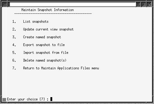

Snapshot information maintenance is performed by choosing Maintain Snapshot Information from the Maintain Applications Files menu, and then selecting the required option.
Maintain Snapshot Information Main Menu
These options allow you to:
List snapshots stored in the system
Update a current view snapshot (full or partial APPL_TOP and global)
Create a named snapshot (you select a current view snapshot to copy and name)
Export a snapshot to file (you select a snapshot to export to a text file)
Import a snapshot from a text file (you select a snapshot to import from a text file)
Delete a named snapshot

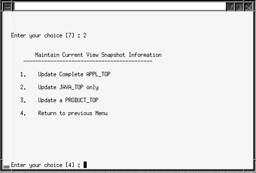

When you maintain a current view snapshot, you can choose to synchronize selected files (to maintain a partial snapshot), instead of synchronizing all files for the entire APPL_TOP. Use this option when you have copied only a few files to the APPL_TOP.
Select the Update Current View Snapshot option from the Maintain Snapshot Information menu.
Maintain Current View Snapshot Information Menu
From the Maintain Current View Snapshot Information menu, you can select one of the following options:
Update Complete APPL_TOP
This is the original functionality of the Update Current View Snapshot option. It synchronizes all the files in your APPL_TOP.
Update JAVA_TOP only
Synchronizes only the files in the JAVA_TOP. At the prompt, enter the path to the JAVA_TOP subdirectory where the files were copied. If the files were copied to more than one directory, press Enter. AD Administration scans the entire JAVA_TOP and updates the information in both the current view and the global view snapshots.
Update a <PRODUCT>_TOP
Synchronizes only the files in a specific <PRODUCT>_TOP. Enter the product abbreviation, then provide the subdirectory information at the prompt.
Enter the path to a single subdirectory in the <PRODUCT>_TOP. If the files were copied to more than one directory in the <PRODUCT>_TOP, press Enter. AD Administration scans the entire <PRODUCT>_TOP and updates the information in both the current and the global view snapshots.

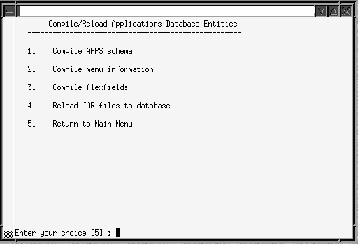

Database entities are database objects or data in the database related to Oracle E-Business Suite. Tasks for managing entities are grouped into two options on the AD Administration Main Menu: one for compiling or reloading entities and one for verifying their integrity.
To compile or reload database entities, choose the Compile/Reload Applications Database Entities Menu option from the AD Administration Main Menu.
You run the tasks on this menu any time you need to compile or reload database objects; for example, after you upload new menu entries, or apply a patch that changes the setup of flexfields. Run these tasks only on the node where the core AD technology directories are located.
Spawns parallel workers to compile invalid database objects in the APPS schema.
Note: For more information, see Compiling Invalid Objects in Oracle E-Business Suite Maintenance Procedures.
Compiles menu data structures. Choose this task after you have uploaded menu entries to the FND_MENU_ENTRIES table, or if Compile Security concurrent requests submitted from the Menus form (after changing menu entries) fail for any reason.
AD Administration asks if you want to force compilation of all menus. If you choose the default (No), only menus with changes are compiled. If you enter Yes, all menus are compiled. Compiling all menus is generally not required.
Compiles flexfield data structures in Oracle Application Object Library (FND) tables. Choose this task after you apply a patch that changes the setup of flexfields. Patches usually indicate when you should perform this step
Flexfields automatically compile data when you use them for the first time, so running this task is generally not required. However, compiling flexfields at a specific time can alleviate potential runtime performance issues. For example, you may choose to compile them when system usage is known to be low, rather than automatically on first use.
Reloads all appropriate Oracle E-Business Suite JAR files into the database. Choose this task if all Oracle E-Business Suite Java classes are removed from your database; for example, if the database Java Virtual Machine (JVM) is reloaded because of database corruption.
During normal system use, the integrity of your database can be compromised, for example through user error or after you apply an inappropriate patch. It is advisable to verify the integrity of database entities as a regular maintenance procedure, or whenever the behavior of your system indicates that database entities may have been corrupted.

Maintenance mode controls the system downtime period by managing user logons. You toggle Maintenance Mode from enabled to disabled from the Change Maintenance Mode menu.
Note: For more information, see Preparing your System for Patching in Oracle E-Business Suite Patching Procedures. See also Maintenance Mode in Chapter 9 of Oracle E-Business Suite Concepts.
Choose Change Maintenance Mode from the AD Administration Main Menu. The menu appears, displaying the current maintenance mode status at the top of the screen.
Change Maintenance Mode Menu
Select option 1 to enable Maintenance mode, or option 2 to disable it.
Maintenance mode must be enabled before running AutoPatch and disabled during normal day-to-day operation.
