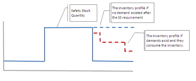

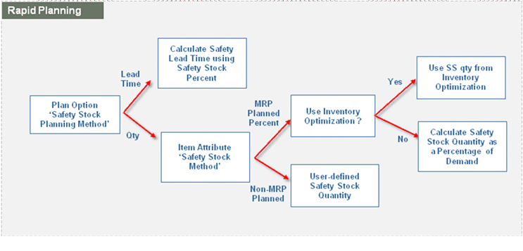

Safety stock: Time-based, only safety lead time

Safety Stock: Item attribute percent only. Calculate safety stock lead-time (SSLT) from SS % item attribute. Schedule each supply earlier by the SSLT value

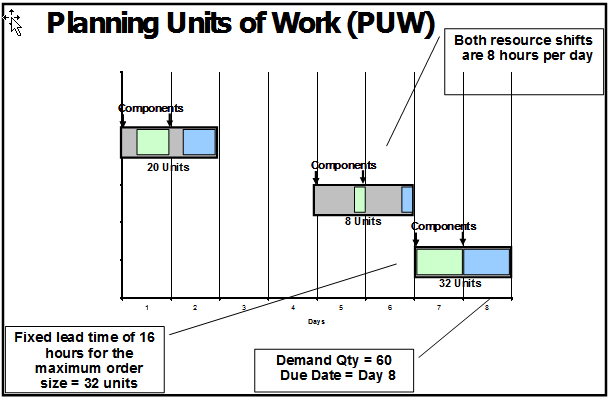

Lead times for make supplies by using the routing resource requirements and the maximum available hours per day for a resource. Each resource lead time is calculated as:
Lead time = [ (Resource Usage) / (maxAssignedUnits * maxDailyResourceHrs) ]
where:
maxDailyResourceHrs = Maximum hrs per resource in a day from estimated order start to order due date
Estimated Order Start = Order Due Date – [Fixed LT + (Variable LT*Qty)]
Order Due Date is the same as demand due date
Order due date and order start date are valid working days from mfg org calendar.
Resource usage = Order Qty * Usage per item from the routing (except for a lot based resource, do not multiply by order quantity )
maxAssignedUnits is the maximum assigned units from the routing

Available resource capacity:
If a make order is scheduled that uses 8 hours of capacity on Day 1 and 1 hour of capacity on Day 2, the planning solver does not assign a particular hour for the resource requirement on either Day 1 or Day 2
The planning solver assumes that resource capacity availability in a daily bucket is continuous.
Work in process job completion dates. The job completion date is typically in the last daily bucket where the final activity consumes resource capacity but can be later in some cases. These are the scheduling rules:
A single resource activity is typically scheduled within a single daily bucket. The resource activity can be scheduled in two contiguous daily buckets with some resource usage on each day. However, a single resource activity is never scheduled in non-contiguous daily buckets.
A single resource requirement for two hours or less is scheduled in a single daily bucket.
In a single operation, two or more resources are always scheduled contiguously. That is, there are never daily gaps in the scheduled resources for a single operation.
Two operations can be scheduled with gaps more than one day between the operations.
If the planning solver cannot bucket all of the resource usage into a daily buckets, it creates multiple planned orders for scheduling flexibility.
Large resource requirements:
If resource requirements are more than one day for a single resource, the planning solver expands the resource capacity bucket and spreads the resource requirement over several days.
The plan information shows the start date and the end date of the resource requirement and also shows the resource usage on each day. The start date and end date of the resource requirement may not match the resource usage precisely due to the estimation of lead time.
It schedules resources within an operation contiguously
It does not necessarily schedule operations contiguously
It can schedule resource requirements more than two hours over contiguous daily buckets
If it must bucket some resource requirements into larger than daily buckets, it can still use daily buckets for the other resource requirements on the routing.

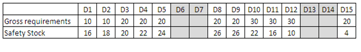

Oracle Rapid Planning has the ability to read in time phased safety stock quantity as an input. However, this quantity must be converted to SSLT since the engine supports only SSLT.
The steps below show the logic that is used to convert a time phased quantity based safety stock to a single SSLT value that the engine uses in its safety stock computation:
Time Phased Safety Stock Quantity (SSQi) is an input; where i refers to the occurrence in the time period.
Compute Safety Stock Lead Time (SSLTi):
Average Daily Demand is computed as an Average over the Planning Horizon.
Compute Safety Stock Percent:
The safety stock lead time (SSLT) that the engine will be using in its computations is the weighted average shown above:
The derived safety stock quantity (DSSQ) will be computed using SSLT.
Note: SSLT can be a fractional value.
To calculate safety stock, there is a new plan option, Safety Stock Lead Time Method. This plan option has three possible settings:
Do not compute safety stock
User Safety Stock Percent
Use Safety Stock Quantity
To calculate safety stock using quantity, this plan options must be set to Use Safety Stock Quantity.
Two examples of calculating safety stock quantity are given below.
Example 1
The demands over a 7 day horizon are: 20, 28, 50, 33, 38, 19, and 28. Assume a constant safety stock quantity over the horizon of 5 units.
Average Daily Demand over the planning horizon = 30.85
Safety Stock Lead Time (SSLT) = 5/30.85 = 0.16 days
Safety Stock Percent = 16
Derived Safety Stock Quantity (DSSQ) = 0.16 * 30.85 = 4.94 units
Example 2
Average Daily Demand over the planning horizon = 27.86
Safety Stock Lead Time is computed as 4/27.86 = 0.14 days and 6/27.86 = 0.22 days for 4 and 6 units safety stock quantities respectively
Safety Stock Lead Time (SSLT) computed as weighted average = (0.14 * 3 + 0.22 * 4)/7 = 0.186
Derived Safety Stock Quantity (DSSQ) = 0.186 * 27.86 = 5.18 units
Note: When determining safety stock by SSLT, SSLT is a rounded down integer value. When determining safety stock by quantity, SSLT is used as a positive number. Fractional values of up to two decimal values are permissible. When the engine plans, it considers SSLT as a positive number.

Target Safety Stock Quantity is displayed only if plan option Safety Stock Lead Time Method is set to “Use Safety Stock Quantity”.
Target Safety Stock Quantity displayed at the Week or Period level is the value of the last day within that Week or Period.
Target Safety Stock Quantity and Derived Safety Stock Quantity are not editable in the material pan view.

Oracle Rapid Planning uses the plan option Safety Stock Planning Method and the item attributes Safety Stock Method using the following decision chart:
User-defined Safety Stock Quantities at the Item Level
Safety Stock Method = Non-MRP Planned
User entered Safety Stock Quantities (Oracle Inventory > Planning > Safety Stocks)
The safety stock quantities are then collected and used in Oracle Rapid Planning.
Safety Stock Quantity Generated in Oracle Inventory at the Item Level
Safety Stock Method = MRP Planned %
Safety Stock Bucket Days = user defined value
Safety Stock Percent = user defined value
These item attributes are collected and the safety stock quantities are calculated in Oracle Rapid Planning using the following logic:

Calculate safety stock as follows where:
Working week = 5 days
Bucket Days = 5
Safety Stock Percent = 100
Note: Safety stock is not calculated on non-working days.
Safety stock on D1 = (Average daily Gross Requirements in bucket days from D1) *(SS % / 100)
= [ (10 + 10 + 20 + 20 + 20) / 5 ] * 1.0
= 16
Safety stock on D21 = (Average daily Gross Requirements in bucket days from D1) * (SS % / 100)
= [ (10 + 20 + 20 + 20 + 20) / 5] * 1.0
= 18
and so on.
Because Rapid Planning is a day-level planning tool, the safety stock level is a target, which is satisfied by the end of the day.
Since component dependent demand is not readily available in the initial bootstrap run of a plan, due to the choices of the alternate BOMs or substitute components that the plan has not yet made, this example uses the following logic to calculate the dependent demand:
In the initial bootstrap run of the plan, the dependent demand for the purpose of calculating the gross requirements is based on the primary BOM. The primary components use an unconstrained MRP explosion using Fixed and Variable lead times.
For all subsequent runs, the dependent demand is based on the previous run and the choices of alternate BOMs and substitute components made in that run.
In both scenarios, the Total Demand used for Safety Stock Calculation is available along with Safety Stock Quantity in the material plan.
Safety Stock Quantity Input to Oracle Rapid Planning from Inventory Optimization
For Rapid Planning plans, if you want to account for the variability in demand and lead times in their supply chain, you can specify any Inventory Optimization Plan in the demand schedules area of Plan Options. For such items, the Safety Stock Method = MRP Planned % and will be part of the Inventory Optimization plan.
A Rapid Planning plan can be made up of a combination of items from any of the following groups:
MRP Planned%
Some of the items have their safety stocks calculated in an Inventory Plan (demand schedule)
Some of the items have their safety stocks calculated in Oracle Rapid Planning
If an item of this category (SS Method = MRP Planned %) is coming from an Inventory Optimization plan as a demand schedule , then the IO generated safety stock takes precedence and the other safety stock attributes, that is safety stock percent, are not considered. Rapid Planning does not calculate the safety stock for that tem.
Non-MRP Planned
Some of the items have user-defined safety stock quantities.
Some of the items have safety stock quantities generated in Oracle Inventory.
Plan Option for Safety Stock Planning
The current plan option in the advanced options section, Safety Stock Lead Time Method, which configures safety stock planning method, is changed to Safety Stock Planning Method. It has the following values:
Do not plan Safety Stock
Use Safety Stock Quantities
Use Safety Stock Lead Time from Safety Stock Percent
There will no longer be Safety Stock Lead Time using Safety Stock.

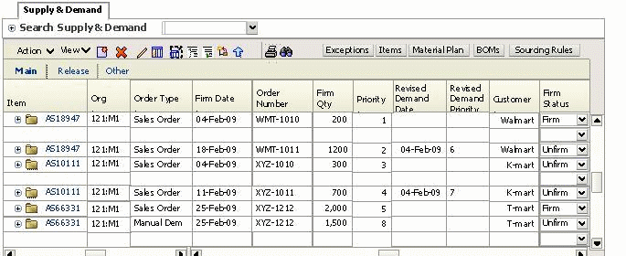

Using Clear to Build Information in the Supply/Demand View
You can use the Supply/Demand view to
View the clear to build attributes: Clear to Build, Clear to Build Date, Clear to Build Component Availability %, Ready to Build %
Search on the clear to build attributes
View the order status: For example, Unreleased or Released
You cannot update the clear to build attributes.

Lead time = 0.5 hour [0.25 + 0.25]
Planning unit of work = 16 hours
Planning unit of work order size = 32 [16 / 0.5], you can produce 32 units in 16 hours
For any planned order quantity from 1 to 32 units, total lead time = 16 hours
Operation 1 lead time = 8 hours
Operation 2 lead time = 8 hours
Demand
Quantity: 60 units
Due date: Day 8
This diagram shows that the planning solver schedules these planned orders:
Quantity = 20 units, days 1 and 2, lead time = 16 hours
Quantity = 8 units, days 5 and 6, lead time = 16 hours
Quantity = 32 units, days 7 and 8, lead time = 16 hours
For the planned order for quantity 32, the planning solver could schedule the operations on the same day:
Day 8: Operation 1, 8 hours consumed [32 * 0.25]
Day 8: Operation 2, 8 hours consumed
For the planned order for quantity 32, the planning solver could schedule the operations on different contiguous days:
Day 7: Operation 1, 8 hours consumed
For the planned order for quantity 32, the planning solver could schedule the operations on different non-contiguous days:
Day 6: Operation 1. 8 hours consumed
For the planned order for quantity 4, the planning solver could schedule the operations on the same day:
Day 8: Operation 1, 1 hour consumed [4 * 0.25]
Day 8: Operation 2, 1 hour consumed

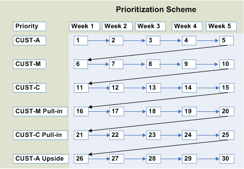

Your list of orders is prioritized from the highest to the lowest.
The orders are planned, one at a time, starting with the highest priority order.
The sequence for each order is to:
Ensure supply is available upstream to meet the Order Due Date.
If this is not possible, try to find supply by building ahead ensuring lead times are respected.
If this is also not possible, then try to find supply while minimizing Order lateness.
After planning an order, that plan is locked before selecting the next order in priority list.
When planning all the Orders in the priority list, use FIFO logic to peg demands to supplies by sorting demands in increasing order of demand satisfaction date.

The application considers both orders that are split and those that are not split when prioritizing the list of orders. Each order must have:
Firm date
Firm Quantity
Priority (Priority may also be referred to as Primary Order Priority)
Revised Demand Date
Revised Demand Priority
The application then determines the highest priority of a pull-in and marks all pull-in orders.

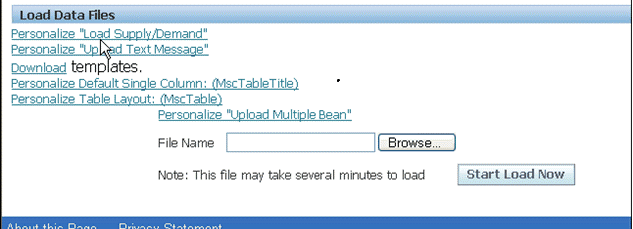

They are populated using the existing custom self-service load feature:
Role: Advanced Planning Administrator
Drill path: Navigator>Collections: Oracle System> Load Transaction Data Using Self Service Loads
When you click Load Transaction Data Using Self Service Loads, the Load Data Files window appears.
On this screen you can point to the file that contains the attributes that need to be uploaded. Each upload of this file replaces all the data that currently exists in the system.
You can use the Download Template link to obtain the format that is required to uploading attributes. The names of the attribute template files are:

An example of an Upside and a Pull-in created using the Revised Demand Date and Revised Demand Priority fields is shown below:
In the above example, order numbers WMT-1011, XYZ-1011 and XYZ-1212 have either been pulled-in or have an upside. Order numbers WMT-1011 and XYZ-1011 are pulled-in. Notice the Revised Demand Date and Revised Demand Priority for these orders. Upside is planned for Order number XYZ-1212 by creating a new manual demand.
To make sure that Oracle Rapid Planning respects the Order Priorities that were set by the user or by an offline process, it is important to identify the Pull-ins and Upsides.
In Oracle Rapid Planning, upsides are defined as a new demand line with type Manual Demand. The priority assigned to this order, its due date, and quantity defines where it is planned in the order sequence
A Pull-in is created on a demand line if the Revised Demand Date is populated. The priority of the Pull-in is populated in the field Revised Demand Priority. The Revised Demand Date should typically by less than the Firm Date. If the Revised Demand Date is greater than the Firm date then it is a Pull-out which is possible but this is not normal.
In the example shown the previous section on the new item attributes, note the partial pull-in, fully pull-in and upside in the results. The explanations use the information from that example.
Explanation 1
Order Number WMT-1011 is partially pulled-in as shown below:
Firm Date = 18-Feb-09 and Firm Quantity = 1200; Priority = 2
Revised Demand Date = 04-Feb-09 and Revised Demand Priority = 6
Revised Demand Date is less then Firm Date hence the order is pulled-in. The amount pulled-in is 1200 and will be planned with Revised Demand Priority 6.
Explanation 2
Order Number XYZ-1011 is pulled in fully as shown below:
Firm Date = 11-Feb-09 and Firm Quantity = 700, Priority = 4
Revised Demand Date is less then Firm Date hence the order is pulled-in. The amount pulled-in is 700 (entire quantity) and planned with Revised Demand Priority 7.
Explanation 3
Order Number XYZ-1212 has an upside a shown below:
Firm Date = 25-Feb-09 and Firm Quantity = 2000 with Priority = 5
Manual Demand created with Firm Date = 25-Feb-09 and Firm Quantity = 1500 with Revised Demand Priority = 8
The manual demand is an upside planned with the lowest priority, in this case 8.

Given the prioritization, the demand prioritization is as shown below:
Oracle Rapid Planning uses the above prioritization scheme in planning the customer demand.
Based on Oracle Rapid Planning’s Planning logic, the weekly customer demands are planned. A temporary excess in bold in the tablet below:
