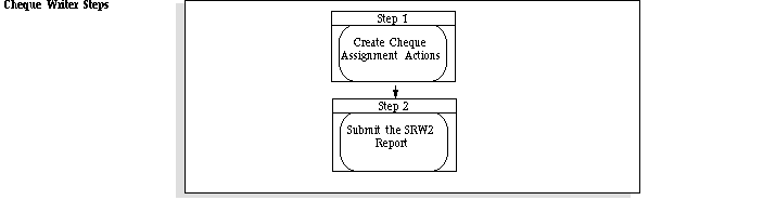

With Oracle Payroll, you can run the following types of payment process:
The Magnetic Tape process - MAGTAPE
The Cheque process - CHEQUE
The Cash Payments process - CASH (UK only)
See: Cash Process
The payment processes take the unpaid prepayment values allocated to each payment type and produce the required payment file.

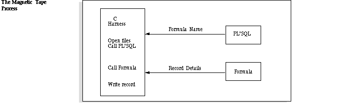

The following figure illustrates the Magnetic Tape process.
A C code harness performs the file handling (opening, closing and writing to files), and enables the PL/SQL and the formulas to interface.
The driving PL/SQL code sequences records by returning the name of a formula.
Each formula writes one type of record, such as the Tape Header, to tape. It defines the contents of the record.
The process of getting the formula and record name, then writing the record to tape is repeated until all the records are processed.
The driving PL/SQL determines which type of record is required at any stage of the processing, and uses context and parameter values to communicate with the formula.

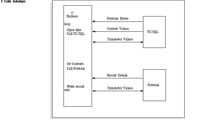

The following figure illustrates how the C code acts as an interface between the PL/SQL and formula, and how the data is passed as context values.
Formulas use database items to reference variable values. For example, the employee and assignment number could be different for each run of the formula and record.
The database item is held within the database, which consists of components to make up a SQL statement. As the value could be different for each run of the formula, the 'where' clause of the statement is slightly different. This is done by substituting key values into the 'where' clause that uniquely select the required value. These substitution values are known as context values.
Context values are set by the driving PL/SQL procedure that places the values into a PL/SQL table. The PL/SQL table is passed back to the C code, which in turn places it in the formula structure.
Parameter values are used to store the variable data to be transferred between the formula and the PL/SQL. For example, the running totals are passed to the formula in this way.
The parameters can be:
Passed into the C process from the command line
Created by the driving PL/SQL procedure
Created by the formula
Only the driving PL/SQL procedure and the formula can update the values.

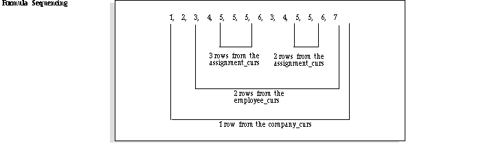

Using the above specification the formulas could be retrieved in the following sequence:
The generic PL/SQL procedure identifies which type of report to process. It does this by passing the parameter MAGTAPE_REPORT_ID when calling the process. The previous figure illustrates how MAGTAPE_REPORT_ID=CA is passed when calling the process.

A PL/SQL stored procedure provides the main control flow and determines the order in which the formulas are called.
The routine uses FastFormula to prepare records The records are written to an ASCII file in preparation for transfer to magnetic tape. To implement the required actions, there are more formula result rule types. These are listed below:

You run the Cheque Writer process to produce cheque payments for unpaid pre-payment actions. Before you run the process, you need to set up certain things, for example, the SRW2 report and the 'order by' option to sequence cheques (if required).
You run Cheque Writer through Standard Reports Submission (SRS). Unlike the Magnetic Tape process, you can have multiple threads in Cheque Writer.
The Cheque Writer process has two distinct steps:
Cheque Writer creates cheque assignment actions for each of the target pre-payments, subject to the restrictions of the parameters specified. The target pre-payments must be unpaid-that is, never been paid-or if they have been paid, then voided.
Cheque Writer creates assignment actions in two stages:
Multiple threads insert ranges of assignment actions, which interlock back to previous actions.
This happens in the same way as Pre-Payments and Magnetic Tape create assignment actions.
See: The Process (Pre-Payments)
A single thread runs through all the assignment actions in a specific order to update the chunk and cheque number.
The order is specified by a PL/SQL procedure that you can customize. The thread divides the assignment actions equally into chunks, one chunk per thread. It assigns each action a cheque number.
At this stage, the status of the assignment actions is 'Unprocessed'.
Note: Cheque Writer creates an assignment action and cheque for each target pre-payment of the assignment. Consequently, a single Cheque Writer run can produce more than one cheque for a single assignment.
When Cheque Writer has created the assignment actions and interlocks, each thread submits the specified SRW2 report as a synchronously spawned concurrent process. The reports produce files in a specific cheque format.
If the spawned concurrent process is successful, the status of the assignment actions is changed to 'Complete'. If the process fails, the status of the assignment actions is changed to 'In Error'. So, if you resubmit Cheque Writer, it can start at the point of submitting the report.
In this respect, Cheque Writer is similar to the magnetic tape process: the whole process must be successful before the payroll action is Complete. But, while the Magnetic Tape process can mark individual assignment actions In Error, Cheque Writer marks all assignment actions In Error.
