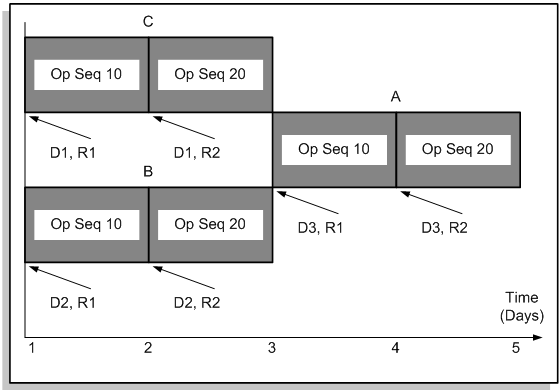

Routing-based RCCP calculates and compares required capacity to available capacity for the individual resources you assign to operations on your routings. Required and available capacity are stated in hours per week per resource.
Routing-based RCCP:
Calculates the required hours for each resource by taking each master schedule entry for a bill of resource item, and multiplying the master schedule quantity by the total hours on each bill of resource requirement that references the resource.
Calculates the required date for each resource by offsetting the master schedule date by the setback days defined on the bill of resource requirement. Since Oracle Capacity assumes infinite capacity, all the required hours for the resource are allocated to the required date.
Buckets the required hours into weekly buckets.
Note: Resource requirements are based on the effective date ranges in routings. Resource requirements for phantom assemblies are included in the requirements for the planned orders of their parent assemblies.
The following table shows three master schedule entries for A and illustrates how, for each entry, routing-based RCCP calculates required hours and dates for D1, R2. Remember that during the bill of resource load, Oracle Capacity calculated that 24 hours of D1, R2 is required to build one unit of A, and that setback days for D1, R2 is 3 days. In this example, 10 units of item A are required on 07-FEB. Routing-based RCCP calculates the required hours as 10 x 24 = 240 hours, and the required date as 07-FEB - 3 days = 02-FEB. 05-FEB and 06-FEB are non workdays.
| Item | Master Schedule Date | Master Schedule Qty | Required Hours | Required Date |
| A | 07-Feb | 10 | 240 | 02-Feb |
| A | 10-Feb | 10 | 240 | 07-Feb |
| A | 15-Feb | 10 | 240 | 10-Feb |
The following table illustrates how routing-based RCCP buckets the required hours for D1, R2 into weekly buckets. The example assumes that the first bucket starts on 31-JAN.
| Week Start Date | Department | Resource | Required Hours |
| 31-Jan | D1 | R2 | 240 |
| 07-Feb | D1 | R2 | 480 |

The following examples illustrate how the bill of resources load process calculates single level resource requirements for two components, B and C, and rolls them up to their parent item, A, as cumulative resource requirements. The following table illustrates the bill of material for A.
| Level | Item | Quantity |
| 1 | A | 1 |
| .2 | .B | 2 |
| .2 | .C | 3 |
The following table illustrates the corresponding routings and associated resource usages for items A, B, and C.
| Item | Op Seq | Dept | Resource | Basis | UOM | Usage Rate |
| A | 10 | D3 | R1 | Item | HR | 4 |
| A | 20 | D3 | R2 | Item | HR | 4 |
| B | 10 | D2 | R1 | Item | HR | 6 |
| B | 20 | D2 | R2 | Item | HR | 6 |
| C | 10 | D1 | R1 | Lot | HR | 8 |
| C | 20 | D1 | R2 | Item | HR | 8 |
Usage rate represents the amount of resource required to build one unit of an item at a particular operation. The usage rate is stated by the unit of measure you define in Oracle Bills of Material.
In the Bill of Resources Example, building one unit of C at operation 20 requires 8 hours of D1, R2.
Oracle Capacity only plans routing-based capacity for resources that have a unit of measure that is time-based and can be converted to hours.
The following diagram illustrates the routing information in the Bill of Resources Example, as well as setback days for each department resource combination. Setback days represents the number of days before the completion of an item that a particular resource requirement is needed. In this example, C's lead time is 2 days. D1, R2 is needed at the start of operation 20 on day 2. The setback days for the resource requirement for D1, R2 is therefore 1 day.
Setback days are calculated using the resource offset percent and item lead times calculated by the Oracle Work in Process scheduler during the Oracle Bills of Material lead time rollup process.
The following table illustrates the bills of resources that the bill of resources load would generate for A, B, and C based on the bill of material and routing information detailed in the previous tables. These are used by routing and rate-based RCCP to calculate resource requirements for master schedule entries.
| Item | Op Seq | Dept | Res | Set Back Days | Reqd Hrs | Usage Qty | Basis | Total Hrs | Source Item |
| A | 10 | D3 | R1 | 2 | 4 | 1 | Item | 4 | A |
| A | 20 | D3 | R2 | 1 | 4 | 1 | Item | 4 | A |
| A | 10 | D2 | R1 | 4 | 6 | 2 | Item | 12 | B |
| A | 20 | D2 | R2 | 3 | 6 | 2 | Item | 12 | B |
| A | 10 | D1 | R1 | 4 | 8 | 3 | lot | 8 | C |
| A | 20 | D1 | R2 | 3 | 8 | 3 | Item | 24 | C |
| B | 10 | D2 | R1 | 2 | 6 | 1 | Item | 6 | B |
| B | 20 | D2 | R2 | 1 | 6 | 1 | Item | 6 | B |
| C | 10 | D1 | R1 | 2 | 8 | 1 | lot | 8 | C |
| C | 20 | D1 | R2 | 1 | 8 | 1 | Item | 8 | C |

In the Setback Days table, notice how single level resource requirements for components B and C are rolled up to become cumulative resource requirements for A. Note how the setback days and total hours change for the cumulative requirements.
For example, 4 days are required to build A, based on item lead times of 2 days each for A, B, and C. D1, R2 is needed at the start of operation 20 on day 2. Setback days for D1, R2 becomes 3 days when the resource requirement for D1, R2 is offset from the completion date of A rather than the completion date of C.
