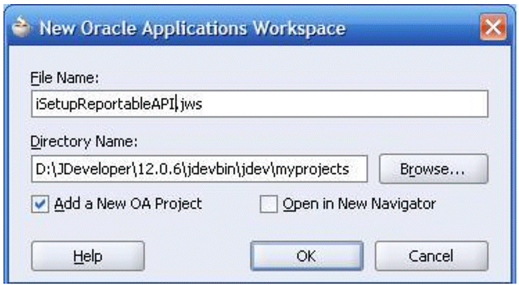

Click on Applications Navigator tab > Right-click on Applications > New OA Workspace > Enter the workspace file name and directory name. Ensure that the "Add a new OA Project" box is checked.
Click OK.

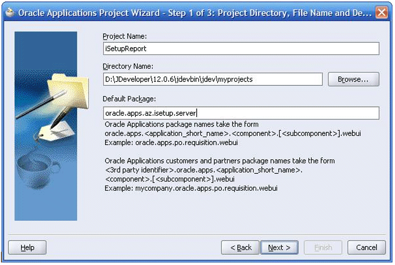

The window "Oracle Applications Project Wizard" opens.
Complete the following steps in the Oracle Applications Project Wizard window.
Step 1 of 3: Click on Next. Enter Project Name, Directory Name, and Default Package Name (for example, 'oracle.apps.az.isetup.server').

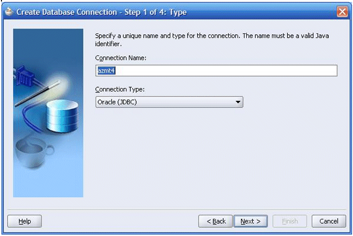

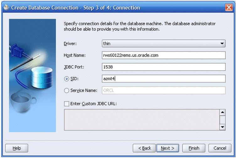

Click Next. Perform the steps required to create a database connection.
Step 1 of 4: Enter Connection Name and Select Connection type as Oracle (JDBC). Click Next.
Step 2 of 4: Enter Username and Password to authenticate the connection. Click Next.
Step 3 of 4: Specify connection details of the database machine. Click Next.

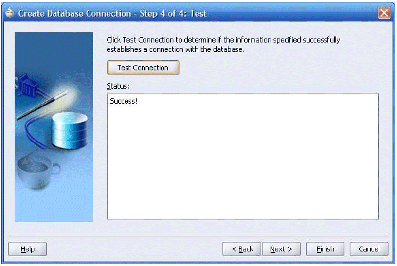

Step 4 of 4: Click on Test Connection to ensure that all the details you supplied above are correct.
Click Finish to return to the Oracle Applications Project Wizard.

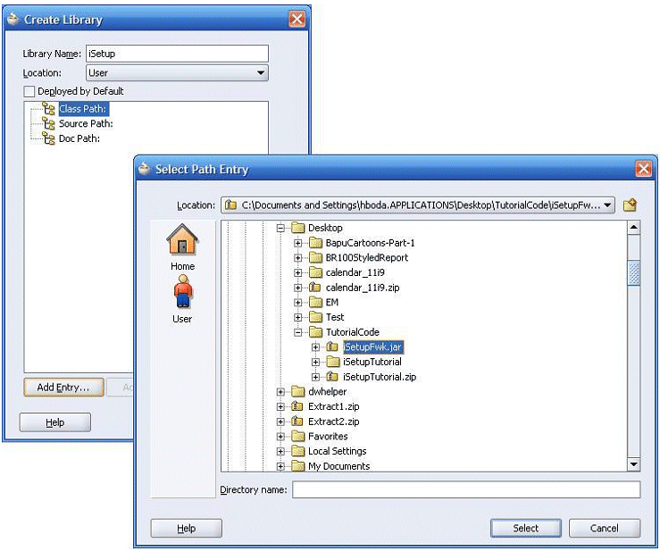

Add a new library:
Click on New.
Enter Library Name using the navigation path iSetup > Select Class Path and click on Add Entry.
Browse to the directory where the iSetup Tutorial files have been unzipped (Refer to Step 3). Select iSetFwk.jar. Click OK in Create Library Dialog Pane.
Click OK in Add Library Dialog Pane.
Click OK in Project Properties Dialog Pane.

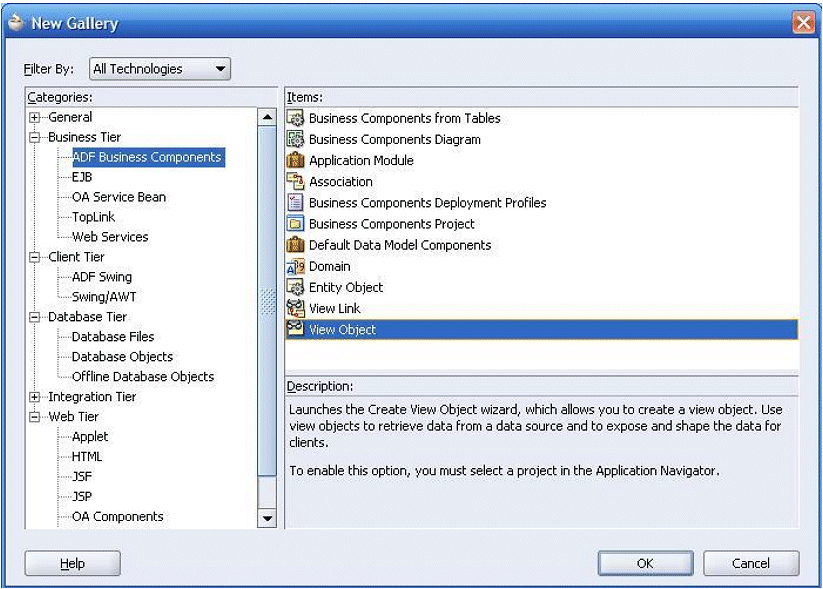

Create View Object: Right-click on the Project and click on New > Select ADF Business Components: View Object.
Click on OK. The "Create View Object Wizard" window opens.
Click Next.

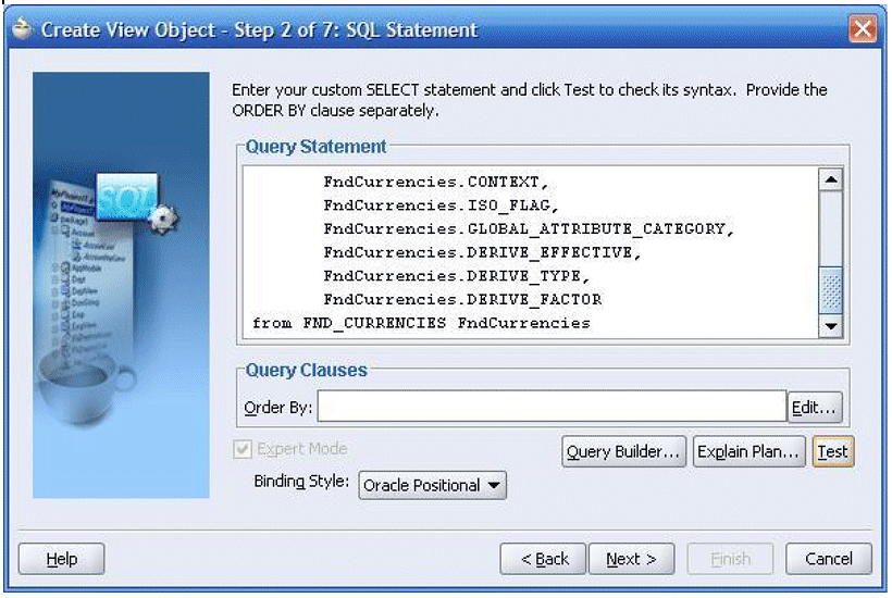

Step 2 of 7: Enter the SQL query (The query for the desired records that needs to come in the report. In this example, we used the FND_CURRENCIES table) in the Query Statement text box and select the binding style as Oracle Positional. Click Next.
Note: An example query is
SELECT
FndCurrencies.CURRENCY_CODE,
FndCurrencies.ENABLED_FLAG,
FndCurrencies.CURRENCY_FLAG,
FndCurrencies.DESCRIPTION,
FndCurrencies.ISSUING_TERRITORY_CODE,
FndCurrencies.PRECISION,
FndCurrencies.EXTENDED_PRECISION,
FndCurrencies.SYMBOL,
FndCurrencies.START_DATE_ACTIVE,
FndCurrencies.END_DATE_ACTIVE,
FndCurrencies.MINIMUM_ACCOUNTABLE_UNIT,
FndCurrencies.CONTEXT,
FndCurrencies.ISO_FLAG,
FndCurrencies.GLOBAL_ATTRIBUTE_CATEGORY,
FndCurrencies.DERIVE_EFFECTIVE,
FndCurrencies.DERIVE_TYPE,
FndCurrencies.DERIVE_FACTOR
FROM FND_CURRENCIES FndCurrencies
Click on Next, accepting the defaults, until you reach step 6 of 7: Attribute Settings.

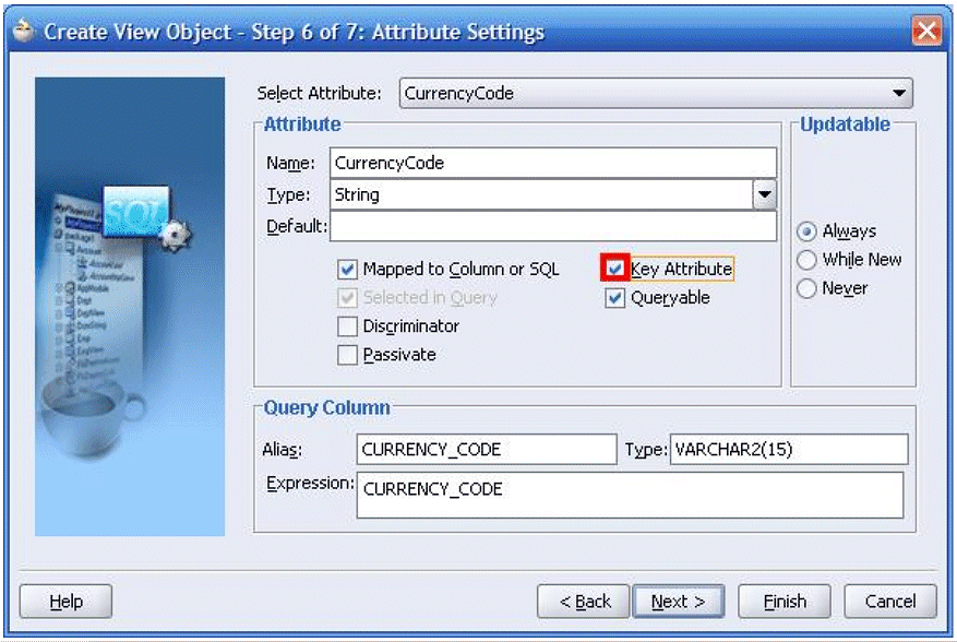

Step 6 of 7: Now mark the unique key attributes (Unique keys are the developer keys of your API. Unique Keys should not contain any sequence IDs. Based on unique key columns, you can uniquely identify a record. In this example, the CurrencyCode view object attribute uniquely identifies a record.

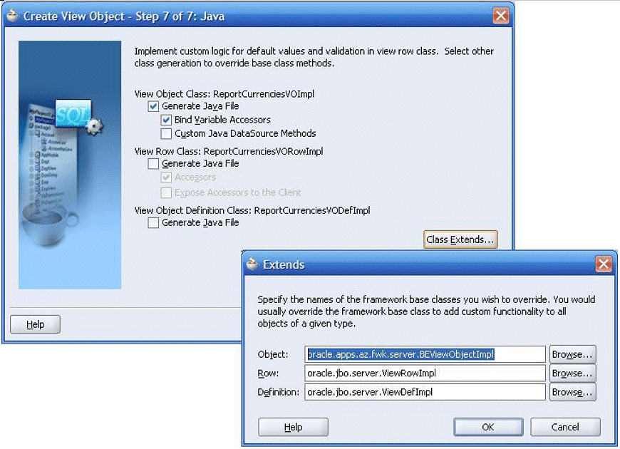

Step 7 of 7: Select Generate Java File for View Object Class: ReportCurrenciesVOImpl.
Click on the Class Extends button. In the Against Object box, you need to override the base class as 'oracle.apps.az.fwk.server.BEViewObjectImpl'.
Click OK on the Extends dialog pane and click Finish in Create View Object wizard.

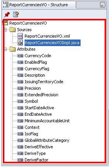

Note that the View Object is created with following two files:
ReportCurrenciesVO.xml
ReportCurrenciesVOImpl.java

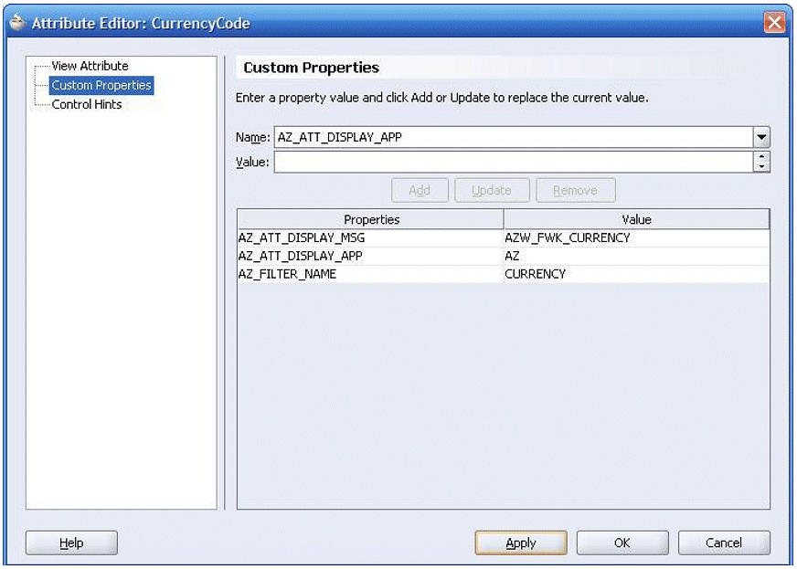

In this example, attribute CurrencyCode of ReportCurrenciesVO is the filtering parameter.

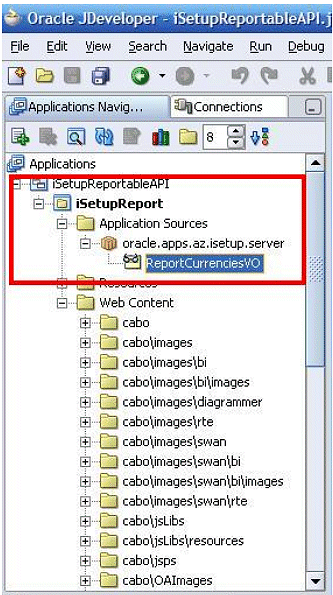

Select ReportCurrenciesVO in Applications Navigator of JDeveloper. In the Structure Pane, select and right-click on the CurrencyCode view object attribute and select 'Edit CurrencyCode'. Then select 'Custom Properties' in Attribute Editor wizard. For Name enter: AZ_FILTER_NAME and for Value enter: CURRENCY. Click on Add and Apply.
Repeat the above procedure for the properties (Optional): AZ_ATT_DISPLAY_MSG and AZ_ATT_DISPLAY_APP. In this example the values are given as follows:
AZ_FILTER_NAME: CURRENCY
AZ_ATT_DISPLAY_MSG: AZW_FWK_CURRENCY
AZ_ATT_DISPLAY_APP: AZ
After entering all the properties for filtering parameters, click OK.

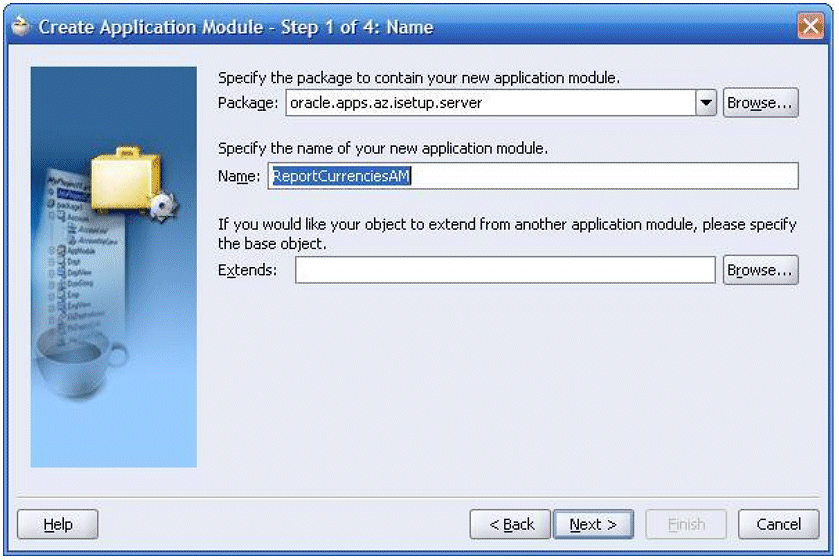

Right-click on the project and click on New. Select ADF Business Components: Application Module.
Click OK. The "Create Application Module" wizard opens. Click Next.
Perform the steps in the Create Application Module window.

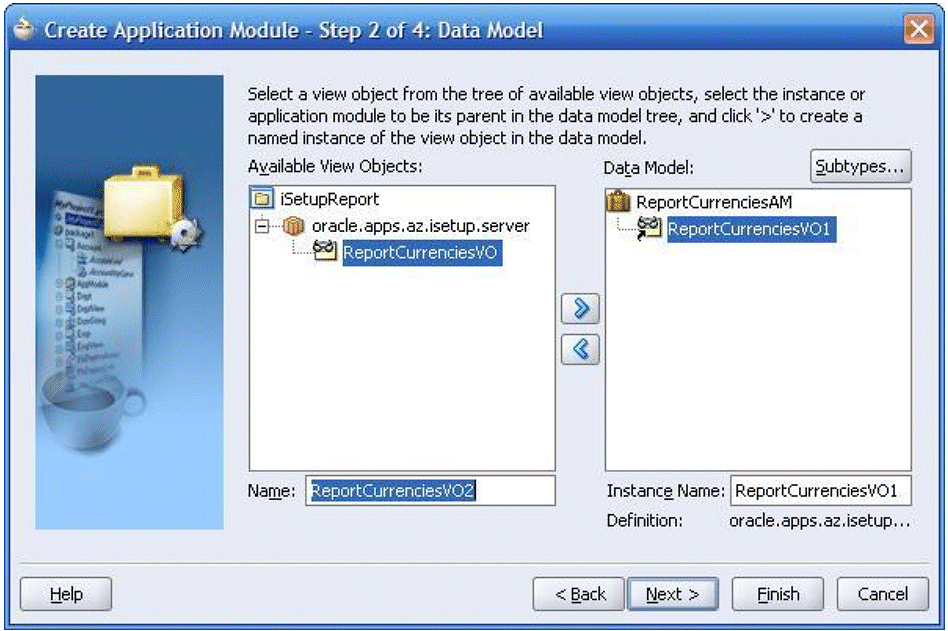

Step 1 of 4: Specify the package and name of the Application Module. Here the package name is given as 'oracle.apps.az.isetup.server' and the View Object name is given as 'ReportCurrenciesAM'.
Step 2 of 4: Select ReportCurrenciesVO in the Available View Objects and add it to the data model. Click on Next.

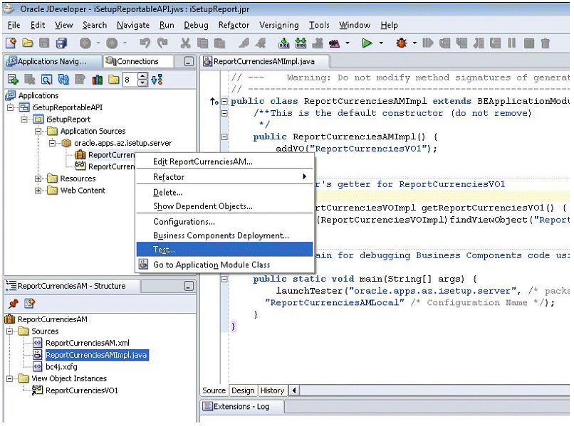

Select Application Module Class: ReportCurrenciesAMImpl > Generate Java File(s). Click on the Class Extends button. In the Against Object box you need to override the base class as 'oracle.apps.az.fwk.server.BEApplicationModuleImpl'. Click OK on the Extends dialog pane and click Finish in the Create Application Module wizard.

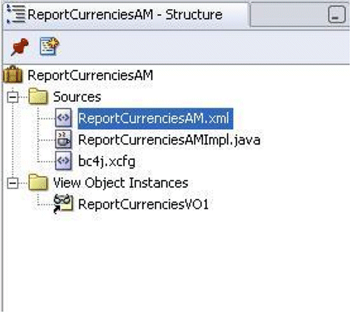

Note that the Application Module is created with following two files:
ReportCurrenciesAM.xml
ReportCurrenciesAMImpl.java
Now you need to add exportable view object to the application module. Open ReportCurrenciesAMImpl.java and add the following piece of code to the application module's default constructor:
public class ReportCurrenciesAMImpl extends
BEApplicationModuleImpl {
/**This is the default constructor (do not remove)
public ReportCurrenciesAMImpl() {
addVO("ReportCurrenciesVO1"); }

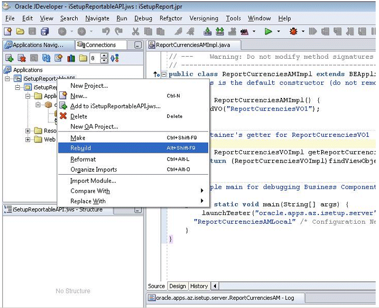

Now right-click on the workspace and select Rebuild. Ensure that there are no compilation errors.
Now your API supports the default export functionality, which is exporting all the records found for the defined view objects so that a report can be generated with the exported records.

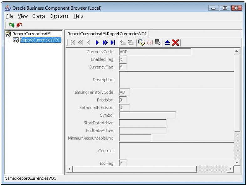

To Test the Interface in JDeveloper

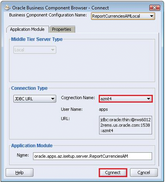

Right-click on ReportCurrenciesAM application module and select Test.
The Oracle Business Component Browser opens. Select Connection Name to the instance on to which you need to test and click on Connect.
A Java frame window ‘Oracle Business Component Browser’ opens up. Click on the View Object you need to test. In this example, we added ReportCurrenciesVO1 to the application module, so we would click on ReportCurrenciesVO1. All the records that need to be fetched with the SQL query will be returned.
Click on File > Exit to close the Testing mode.
