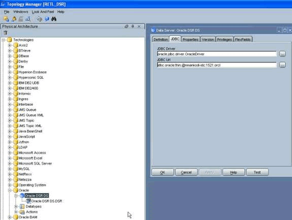

On the physical architecture tab under Oracle on the "Oracle DSR DS" object, change the JDBC URL to point to the DSR database.
jdbc:oracle:thin:@yourserver:port:dbname
On the "Oracle DSR DS.DDR", change the username and password for that connection. Click Test and make sure the connection is successful.

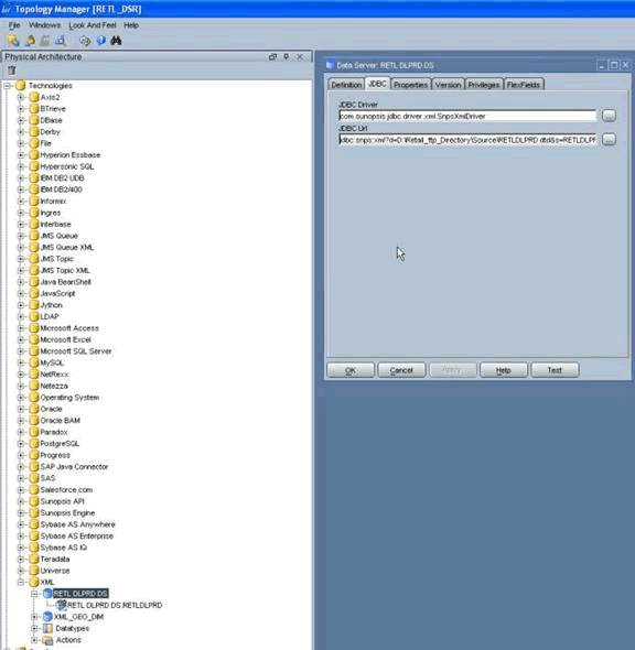

Under XML on the "RETL DLPRD DS", change the JDBC URL to point to the file RETLDLPRD.dtd in the source directory created. Click Test and make sure connection is successful.
jdbc:snps:xml?d=directory_path_to_dtd_file/RETLDLPRD.dtd&s=RETLDLPRD
