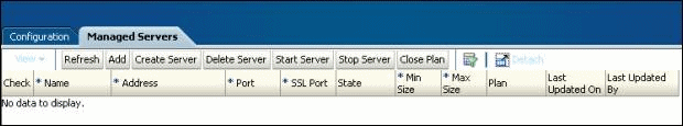

  2. Select the Managed Servers tab. The list of current Managed Servers appears.
  3. Click Add. An empty row appears. Enter the following information for the new Managed Server:

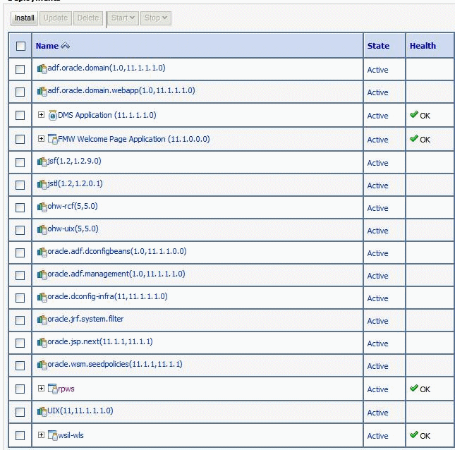

  10. Select Deployments from the Domain Structure region.
    the picture is described in the document text
    The page displays the list of available deployments.

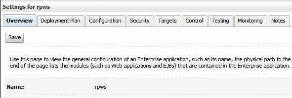

  11. Select the Engine application (rpws in the example above).
  12. Select the Targets tab.

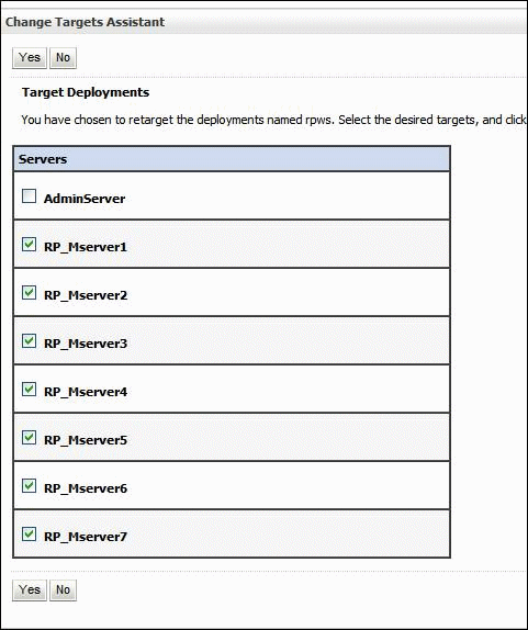

  13. Select the check box with the Type "Enterprise Application", and click Change Targets.
  14. Select all the Managed Servers you want to deploy the application, except the AdminServer, and click Yes. Follow the instructions.
  15. From Change Center region, click Activate Changes.

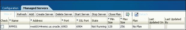

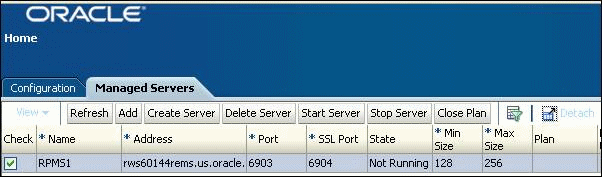

  1. From the Rapid Planning Admin User Interface, select the Managed Servers tab. The list of current Managed Servers appears on the page.

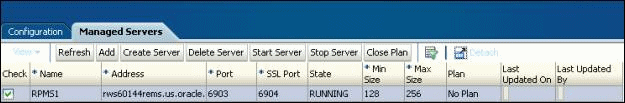

  2. Select the Check box for the servers you want to start, and click Start Server.
    The selected servers display the State as "Running". If a selected server State does not appear as "Running", refer to the log files. Use the Refresh button to update the status displayed on screen.

Closing a Plan on Managed Servers
To close a plan running on a Managed Server, perform the following procedure:
  1. Select the Check box for the Managed Server where the plan is loaded. The Plan field displays the name of the plan currently being run on the Managed Server.
  2. Click Close Plan.
  3. Click Refresh. The Plan field displays "No Plan".

  1. From Rapid Planning Admin User Interface, select the Managed Servers tab.
  2. Select the Check box for the servers you want to stop, and click Stop Server.
    The selected servers display a State of "Not Running". If the selected servers do not display "Not Running", refer to the log files.
