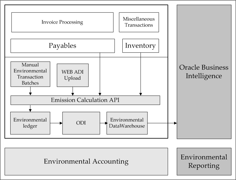

The following diagram provides an overview of the Oracle Environmental Accounting and Reporting application's architecture:
Environmental Accounting and Reporting (EAR) integrates with Oracle Payables and Oracle Inventory and enables you to perform environmental accounting for various transactions. EAR integrates with Oracle Payables to capture data while processing Invoices with or without Purchase Order match, related to the supply and use of products and services that have environmental impact. You can also enter this information for invoices after they are received and processed through the Payables Open Interface. EAR integrates with Oracle Inventory to record data related to the issue of Items to Assets that result in environmental emissions. You can also record environmental transactions manually in the Environmental Transaction Batches window or upload data from spreadsheets using Oracle WebADI Templates available within EAR. This data is collected by the Emission Calculation API that calculates the energy and carbon equivalent emissions by applying energy and emission factors and stores the information in the Environmental Ledger.
EAR leverages Oracle Data Integrator (ODI) to transfer the data from the Environmental Ledger to the Environmental Data Warehouse. The Oracle Business Intelligence application uses the data for environmental reporting through the pre-built dashboards and reports.
